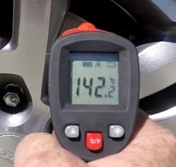

2 or 3 minutes then pulled up to a heavy stop, and immediately measured, not a panda but vented discs, brakes in good order
145C fronts
100C rears
Even a slightly sticking I would expect 300 or more after a 40 minuites drive

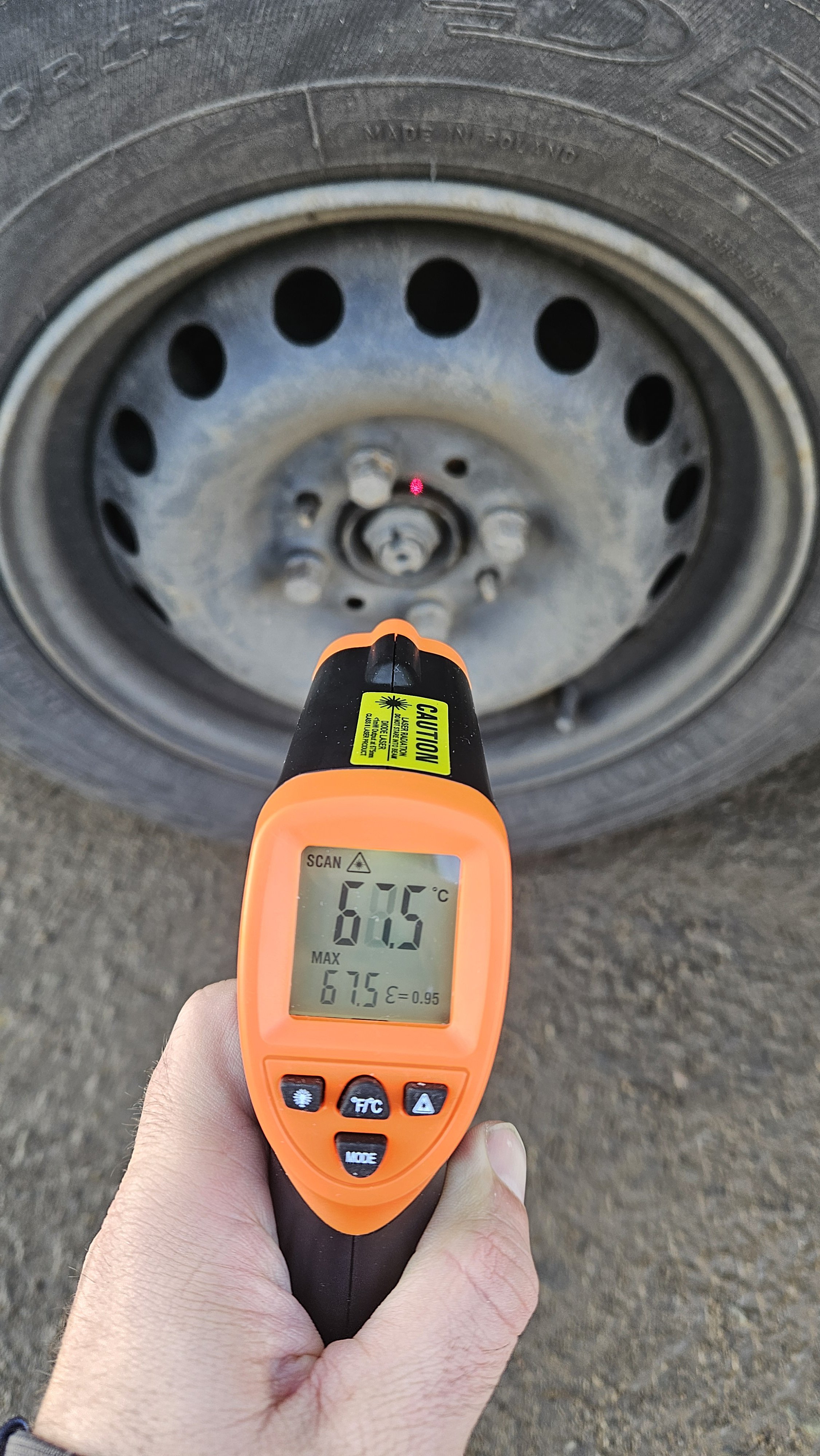

Today after a normal jurney of 27km, in the city.
Left wheel hub is hotter than the right one. 67.5 vs 63
4 degrees is nothing
You don't know if the cool one is doing slightly less work
