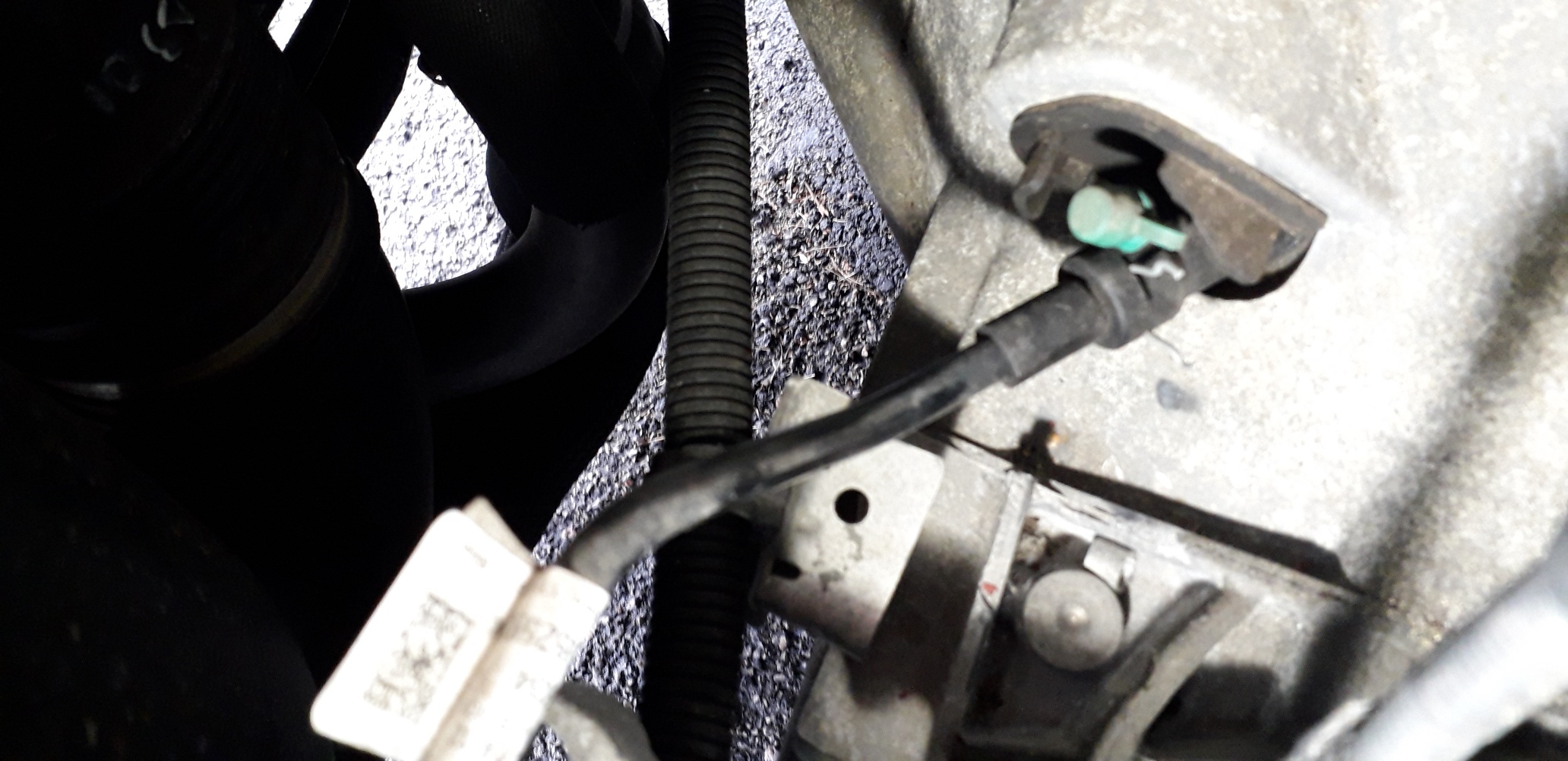

130 manual.
For better access it may be appropriate to remove Air filter lid. 4 phillips screws made out of putty metal, prone to rusting and camming out. (so i'm told) I replaced mine with Stainless torx screws. Do not drop anything into empty air box)
clip arrangement
open cap and fit pipe. Push back clip pull pipe. Remove fluid until fresh fluid without bubbles is evident , pump as required. Maintain res level. Close nipple by push pipe in push/pull clip home, remove pipe, replace cap.
