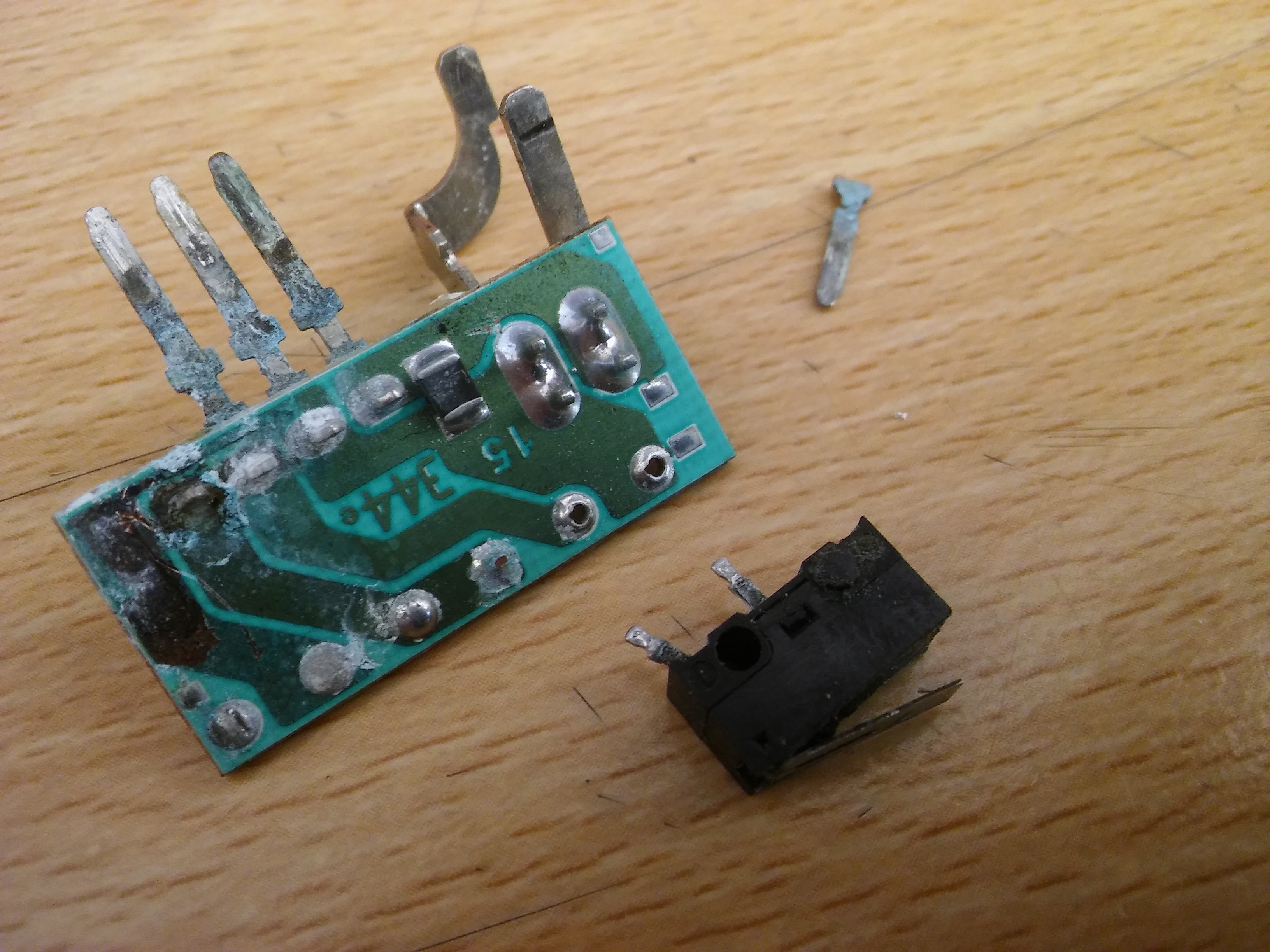

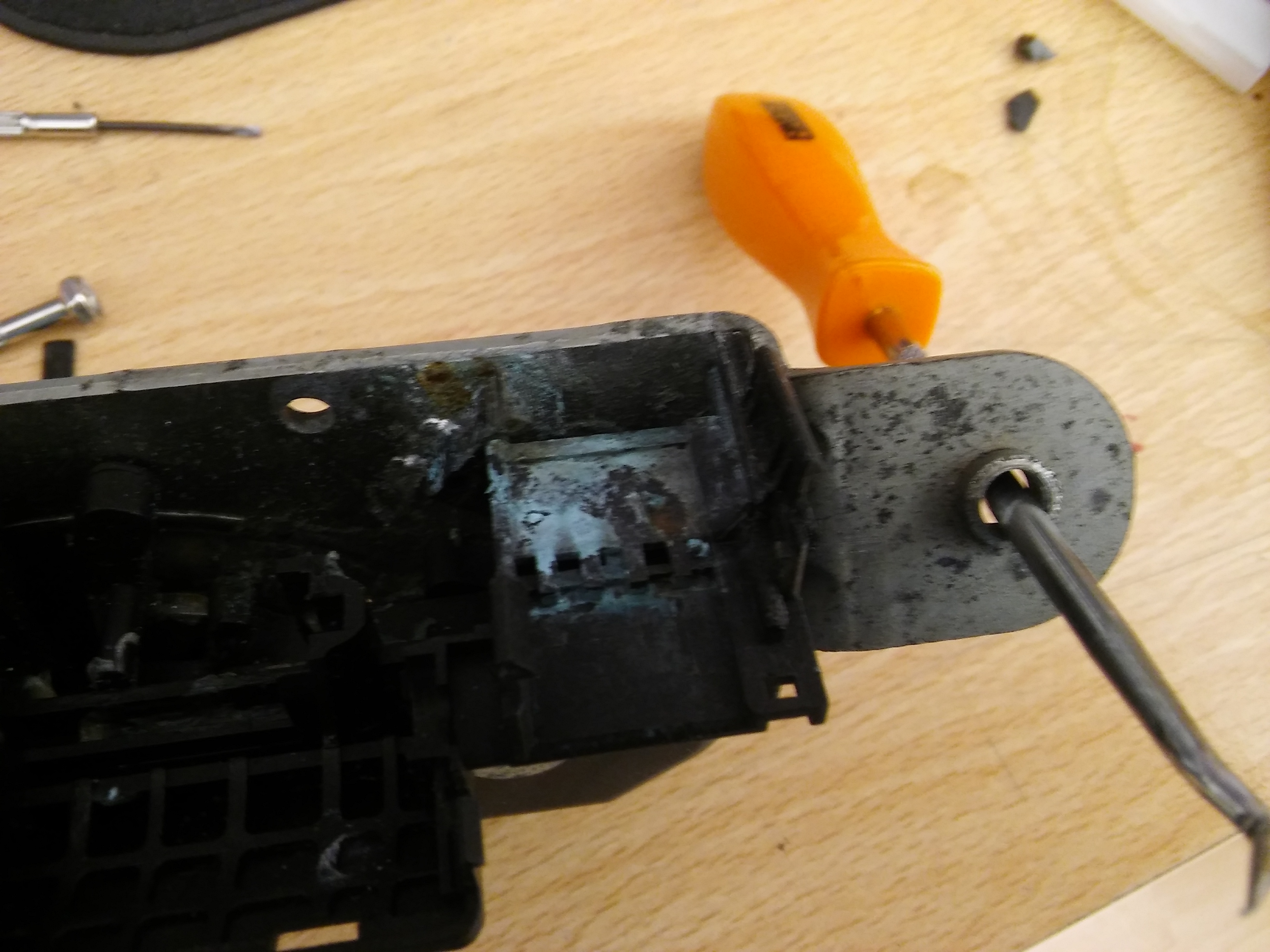

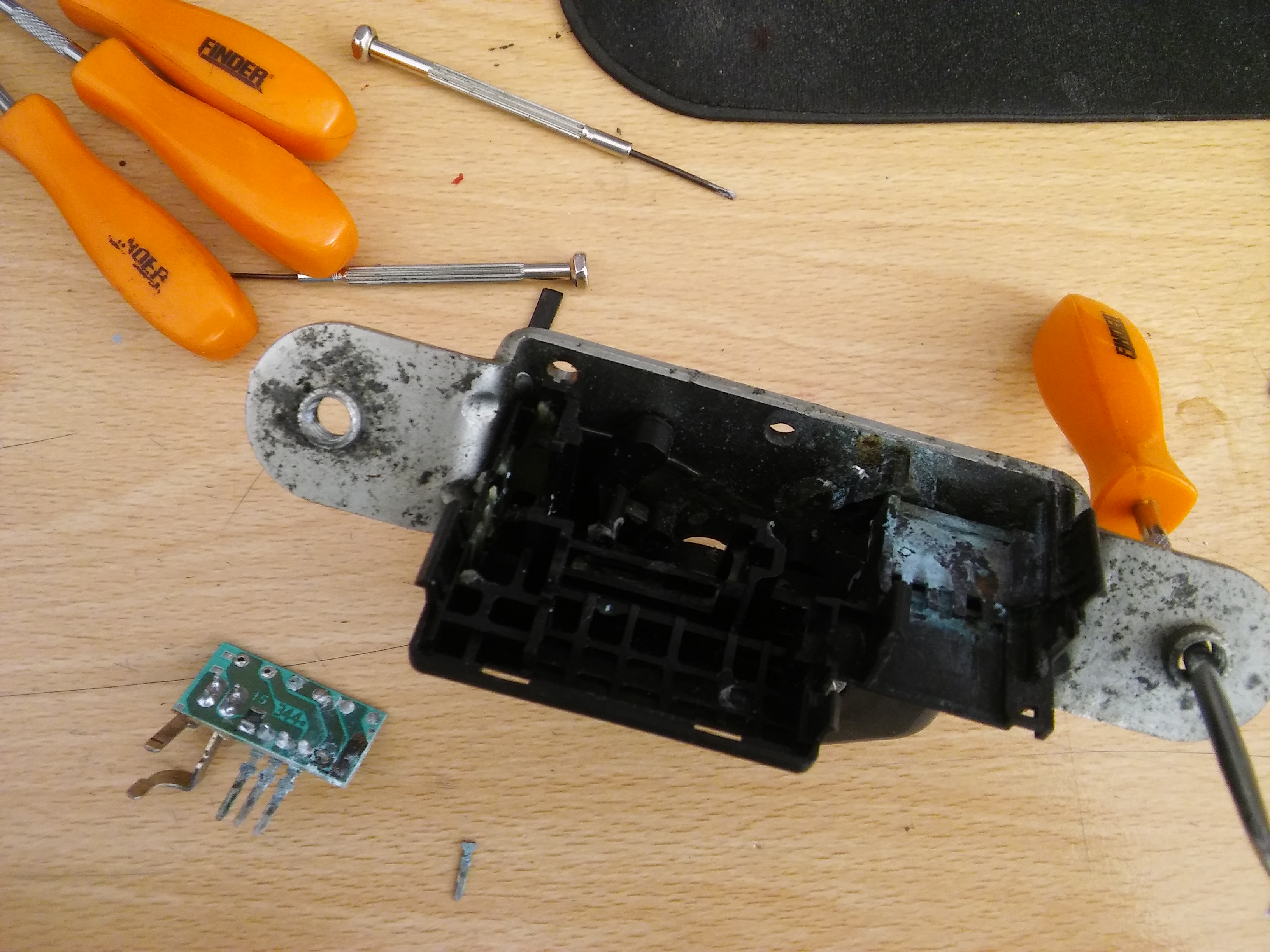

so today I have taken the old lock apart
of course the plastic tabs snapped off, but I have chemical metal just in case, to fix the casing.
the microswitch had come off the PCB completely, it feels like it still works and will solder back in to its original holes on the PCB [edit to say, a further check shows the switch should have 3 pins, one of which is gone, so it would need replacing]
but one of the connector pins, has come off and about 4mm of it has dissolved where it bends to go into the PCB, so I wont be proceeding.
have a few pics

its probably easy to make another pin, but theres no point really, I just cant be bothered but I am glad I opened it up to see, it will now go in the bin instead of in my shed cluttering it up.
