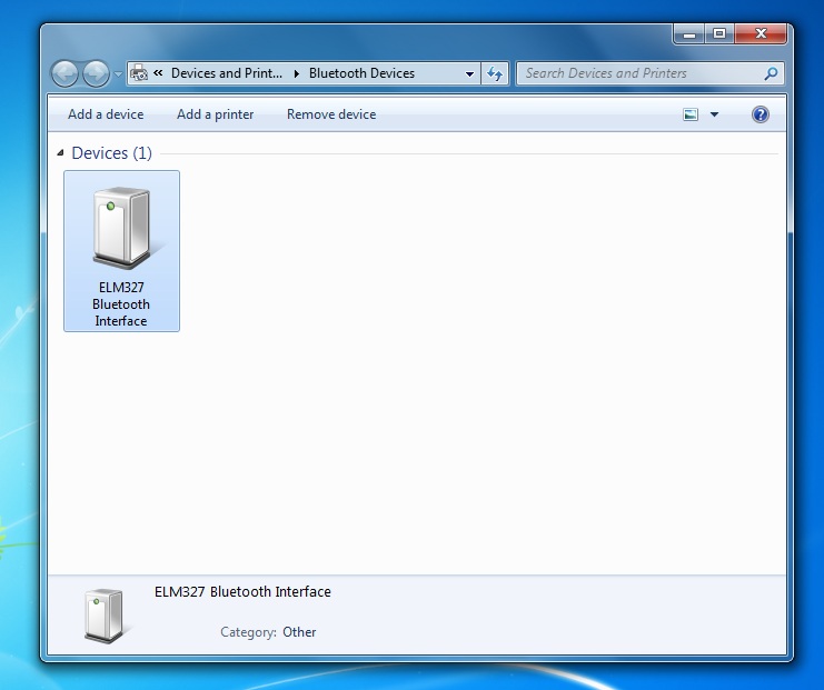

any way you could put up a screen dump of the windows bluetooth interface so that i know what im looking for ? (last time i used windows bluetooth interface was in XP)
Is this what you after?
its a tad difficult to explain what im after because my system is completley different wrt bluetooth because the front end software (centrafuse) installs its own version of the very popular bluesoleil bluetooth stack which effectively removes any windwos interface...
let me try again, how do you control the usb bluetooth dongle in your windows PC, ie get it to scan and find the ELM327? by what im seeing, im lead to belive you just click "add a device" in the screen dump youve put up, and itd search for any devices and the rest is easy, yes? (sorry if this sounds a bit strange, but the system im trying to integrate this into is very very different to the norm, lots of 3rd party aps that "take control" of there respective 3rd party devices, makes doing most things a PITA)
