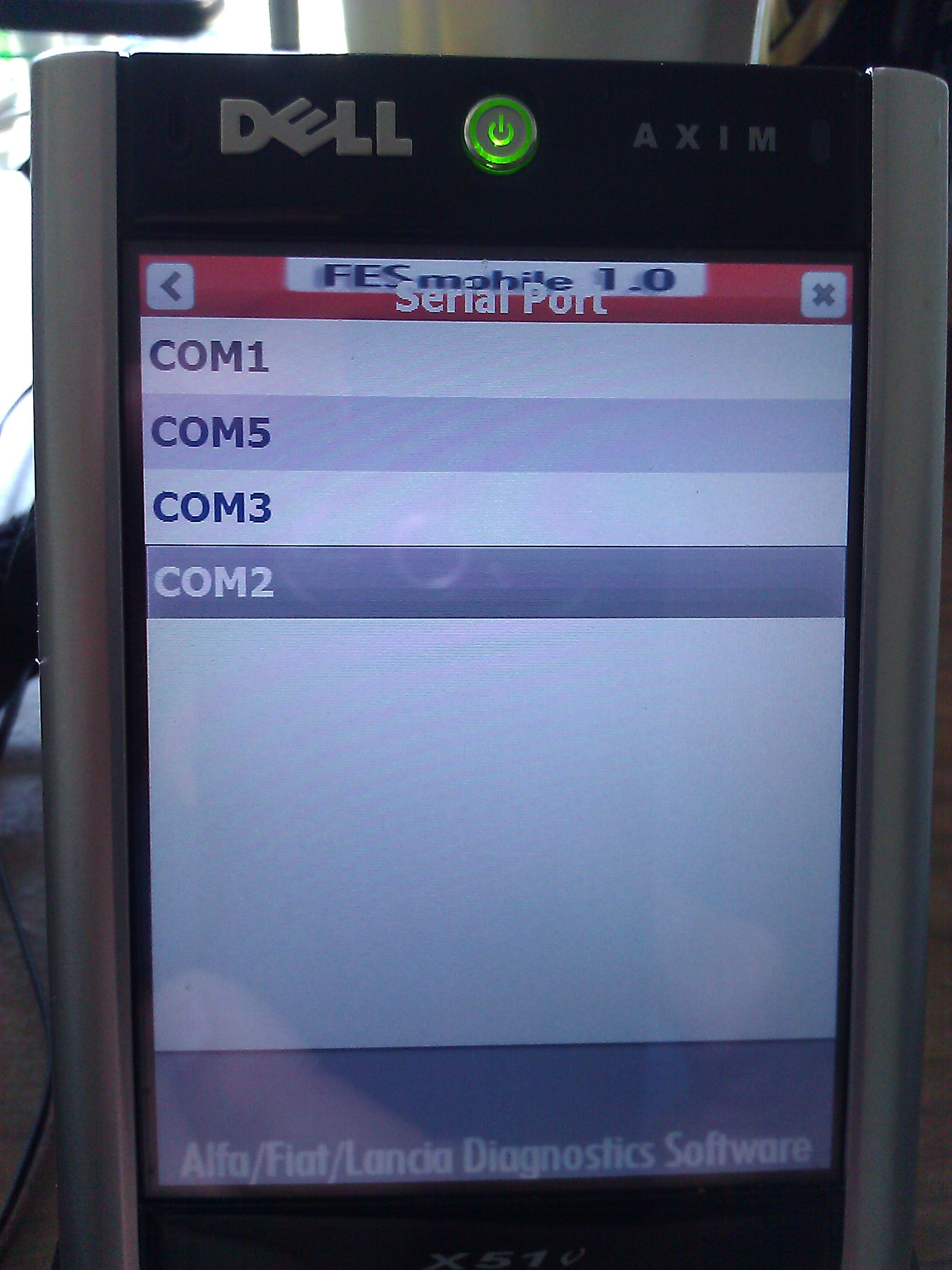

I get the same 1st message screen so your guess is as good as mine. I've tried different port settings as the FES prog doesn't make clear whether it wants Incoming port No or Outgoing port. I would have thought it needed both
But without ver 1.3+ I'm not expecting much to happen
I'm only able to select ports 1, 2, 3 and 5, is that the same for you?
I have no idea what is connected to those ports as I've done a hard reset of the Axim so it should be as it came from the factory apart from FESMobile ... :confused:
