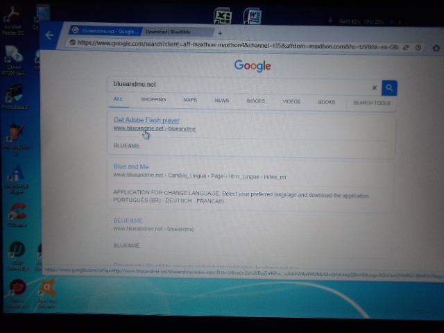

It’s going to become a reoccurring theme and I can’t believe if you found this you’ve not seen the other posts, basically to update the b&m in your car you need to use an update tool (the now defunct website) to establish which bit of software your specific car needs, its not as simple as just using any old software you can find
This is how simple

The Blueandme website is NOT defunct
The blue and me website is running on out of date and insecure software that the makers no longer support because of security concerns.... this is why it is not accessible from regular web browsers

The statement was quite clear the Blueandme site is NOT defunct. :bang:..it is fully operational as it has always been even since they finished any updates back in 2015 so owners with issues can hopefully update or sort out problems and I am sure it has been well used over the past 6 years too(y)....how one chooses to access into the site is another matter as there are many ways that it can be achieved and is not something I certainly need advice on it is my daily job dealing with website fraud and hackers.
Personally we used an old laptop with Windows7 64bit (yes WIN7 too is outdated and not secure but again NOT defunct). I have no personal data or use it for any internet work just for access to blueandme.net and the odd suspect sites we may need to access. That said all our connections go through a VPN and tight security on anything we download.
Cnet and Softpedia are well known download sites we use a lot and whilst obviously have their caveats no one can ever consider themselves entirely safe and even as ARK has said previously to use an old out of date browser would be no safer at all(n)
I have been downloading and sending out files on a memory stick and/or transfering them over the internet to those that don't use Windows and get these returned with a SAE that I then check update and modify as required. It keeps one of my work colleagues (Hacky) very happy in between code breaking, who at the moment though cannot stop laughing at the thought of Putin in his palace instructing the KGB to hack the Blueandme website to ground all Fiats so he can sell more Trabants or Ladas. That said maybe Xi Jinping has other thoughts.
