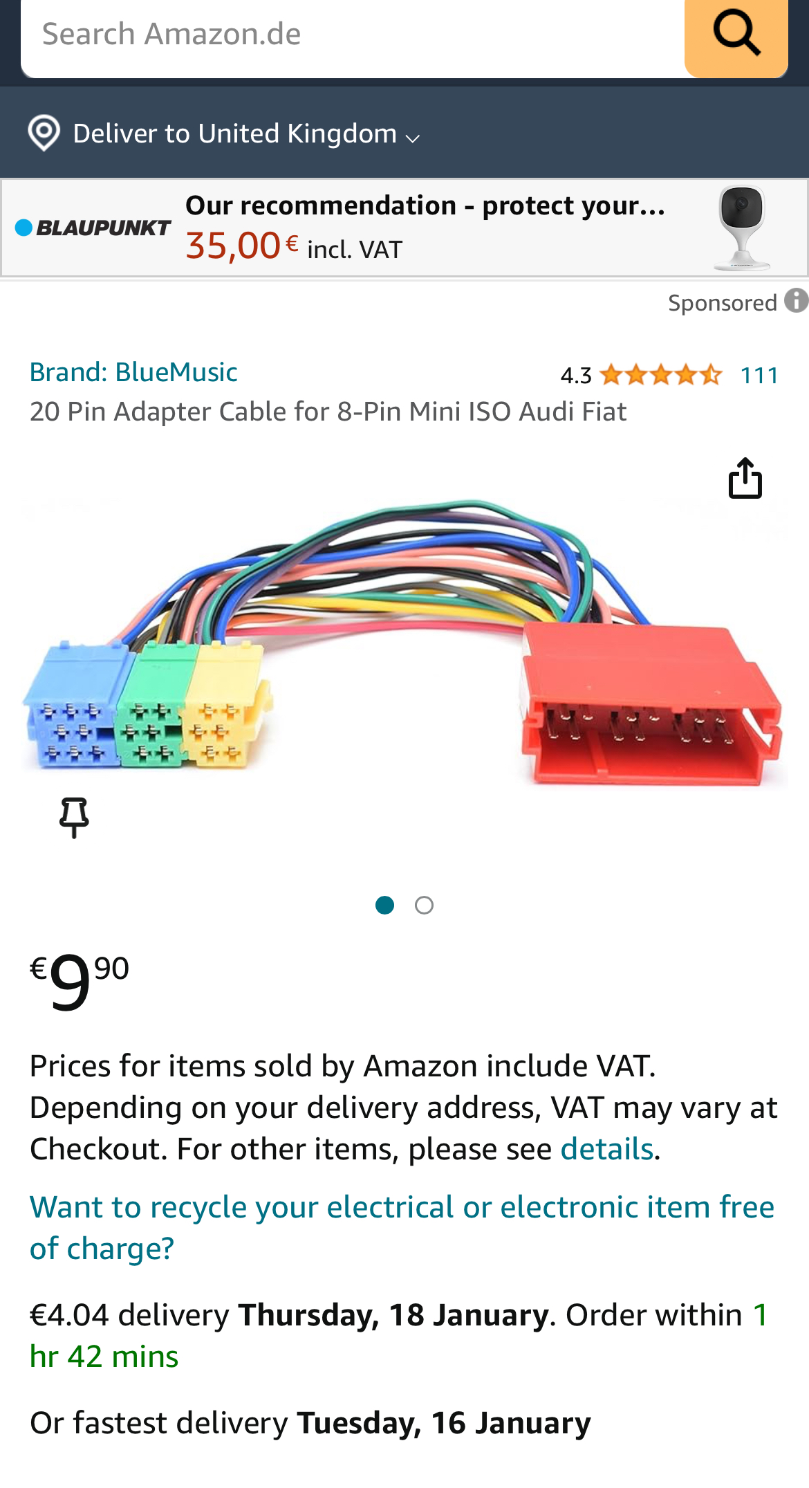

Hi I’m not sure if it’s the same radio but I bought a Bluetooth thingy that plugs into the back of the stereo…. I have a Fiat 500 09 plate. Admittedly it wasn’t cheap but still cheaper than a new head unit and I can now play Spotify ect and it comes through the cars stereo.
The black bit with blue is the Bluetooth, to use the blue and me voice command you’d need the multi plug adapter too. (Partner figured it out but in short you pull the blue bit off the multi and put the blue bit from the blue tooth and plug in that way) just incase this helps anyone as it drove me insane for days looking for a solution!
