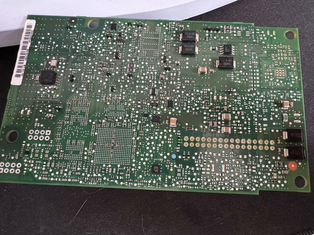

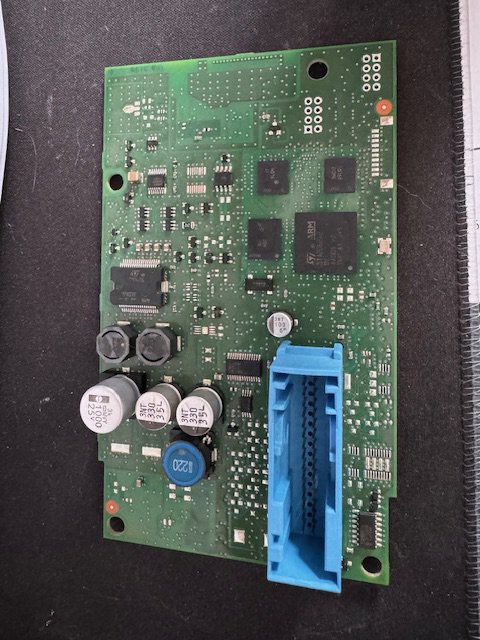

SO i've taken my convergence unit B&M Unit out of my car to have a look at the capacitors and connectors but i don't see a blown capacitor. As in i see no clear sign of this. Do you have any recommendations on how to check further? I will append a image.
