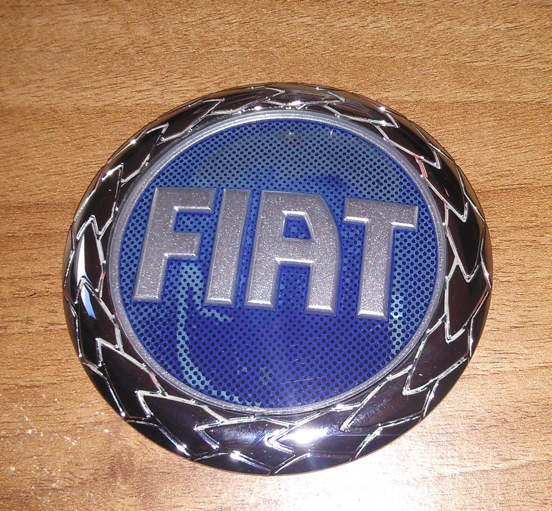

To remove the central logo from the silver case, simply warm the 'sticky stuff' up that resides behind it. You will need a little leverage to pry it from the silver backing (I used an old bank card).
Read: I wouldn't use a flat headed screwdriver as that may chip the badge.
