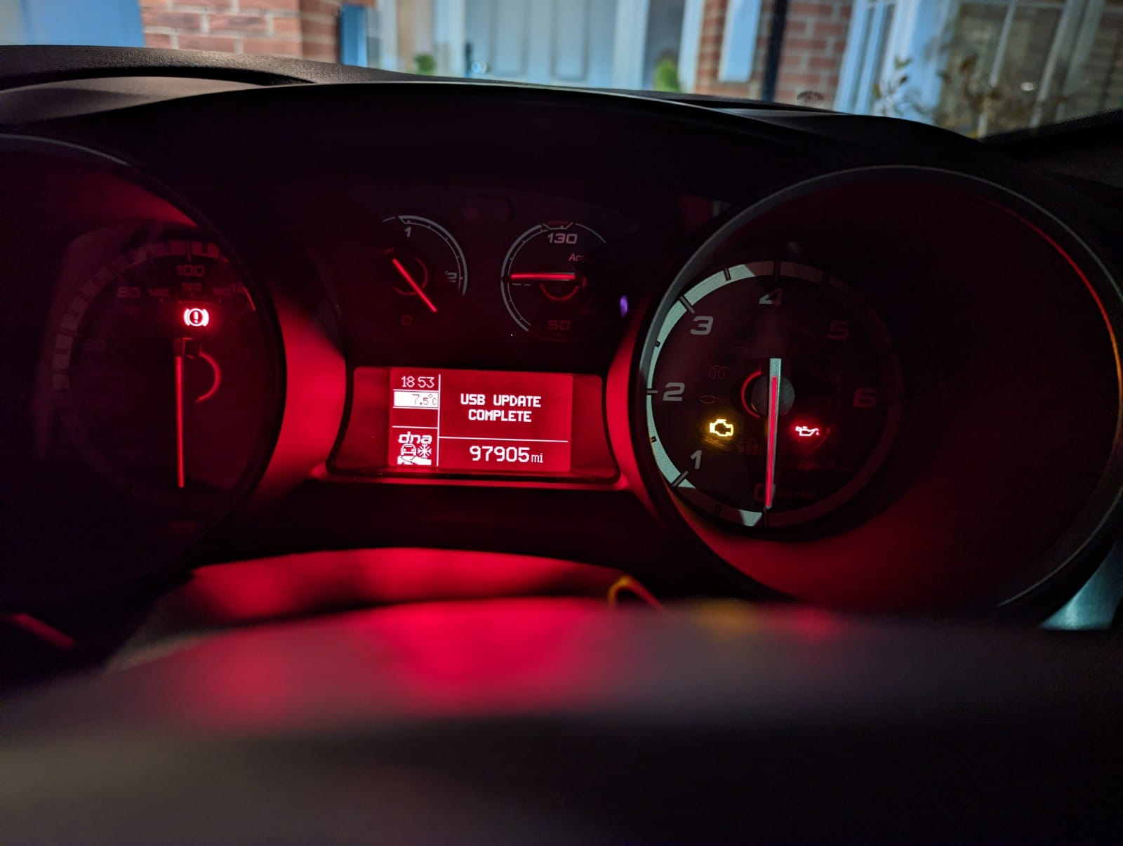

Put this on a USB stick and did the update. Now, the update takes about 4-5 minutes - it appears to finish after 2 mins and sit there and do nothing for a further 3 mins and - WAIT for the full 5 mins - it will say Complete at the end.
Tried to pair the TomTom → success !! Alfa logo on startup, Car menu in TomTom and all features working.
