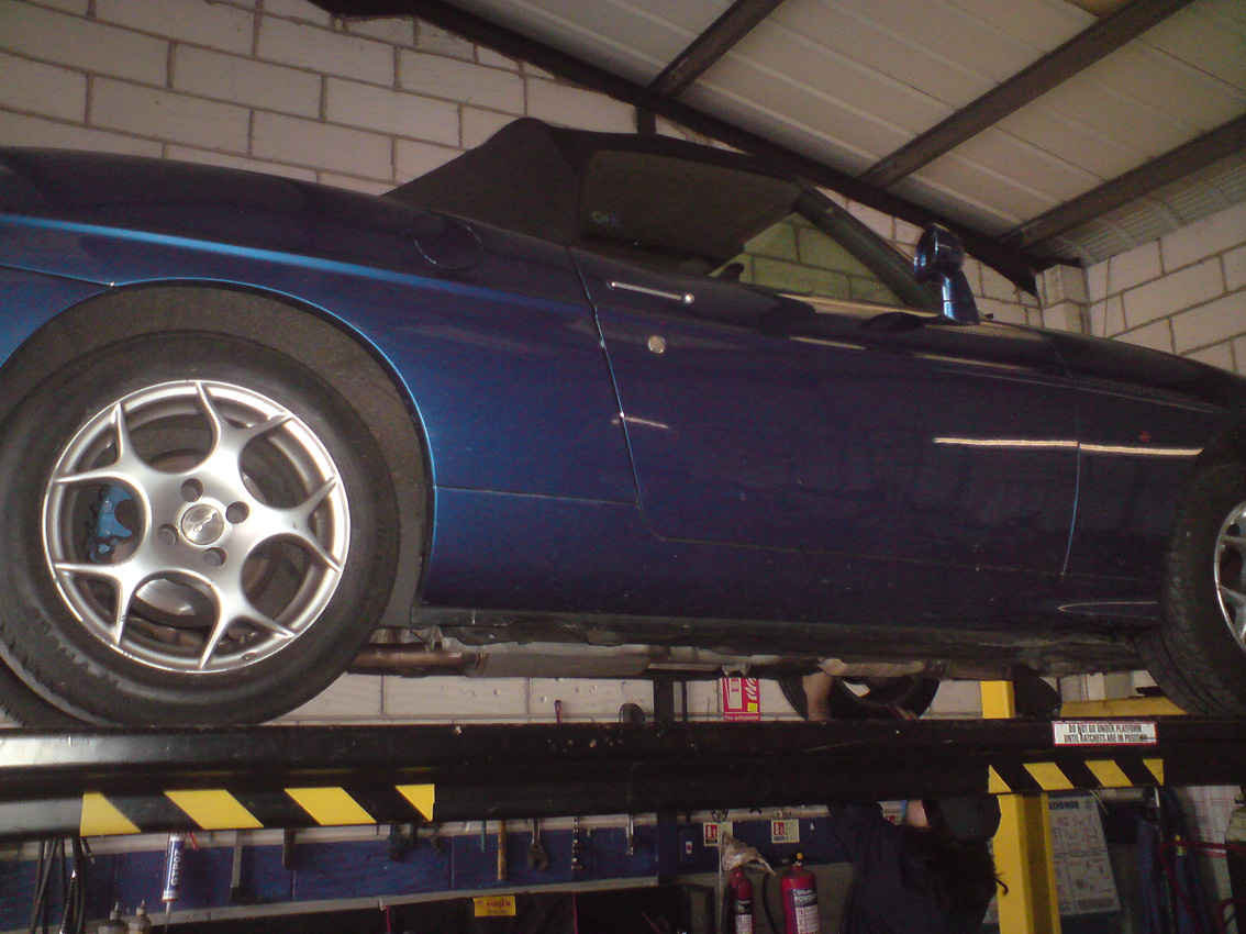

My Barchetta should be up on the ramps today. I have a possible hole in floor issue that needs looking at. I will try to get a photo and look at the limited edition B that the garage owner is selling.

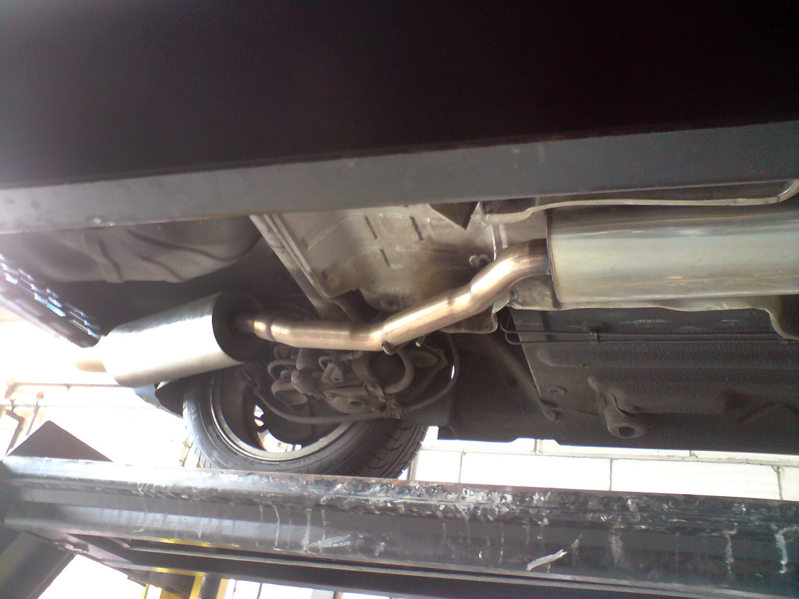

Blue B went up on the ramp. Water under the floor is coming from somewhere. The underneath of the car is fine. Lui suggests getting the floor up and looking for leak. The water must be from rain - there is no smell or colour. I think it will take the best part of a day for garage time but don't think I will be able to sort this on my own. Does anyone have any ideas about common leak possibilities?
I have a few pics of my B on the ramp.

Lol yes lots!
Check the door seal at the top front of the door - it can get in there if its not quite fitting right and then run down and come into the foot well through the 3 air holes in the bottom of the seal.
Tonneau cover seals - I'm not sure how its physically possible but somehow it gets in there and under the cover and soaks through the foam under the floor.
Rear window bottom corners - I have had water drip through the stitching in the roof but nothing mayor.
Door seal round the windows - I've caught mine in the window before now and ended up with a flood. (You'd know if you'd done that though).
Good luck - its a painful problem this one.

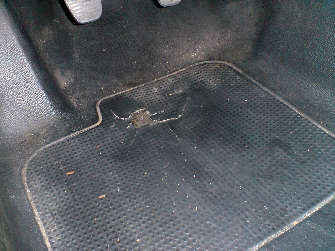

Thanks Shel, I will look at these possibilities. The water is noticeable on the drivers side under the mat. I have some damage to the rubber and you can feel the moisture through the hole.

Here is a pic of the water hole in the drivers footwell :(
this "hole" in the floor cover, the plastic/rubber bits.. you can repair them with liquid rubber/latex (available from every erotic shop :D) or just black silicon (tube -available from every B&Q) - spread it open with a spatula or something, apply several layers if you must. But its important that you do not use something that gets hard, but remains soft/rubbery :)
Then get some mats from barchettaparts to hide your handiwork.
However, before doing all this, check out that underneat that worn hole there is no rust or anything on the floorpan... sort that out first

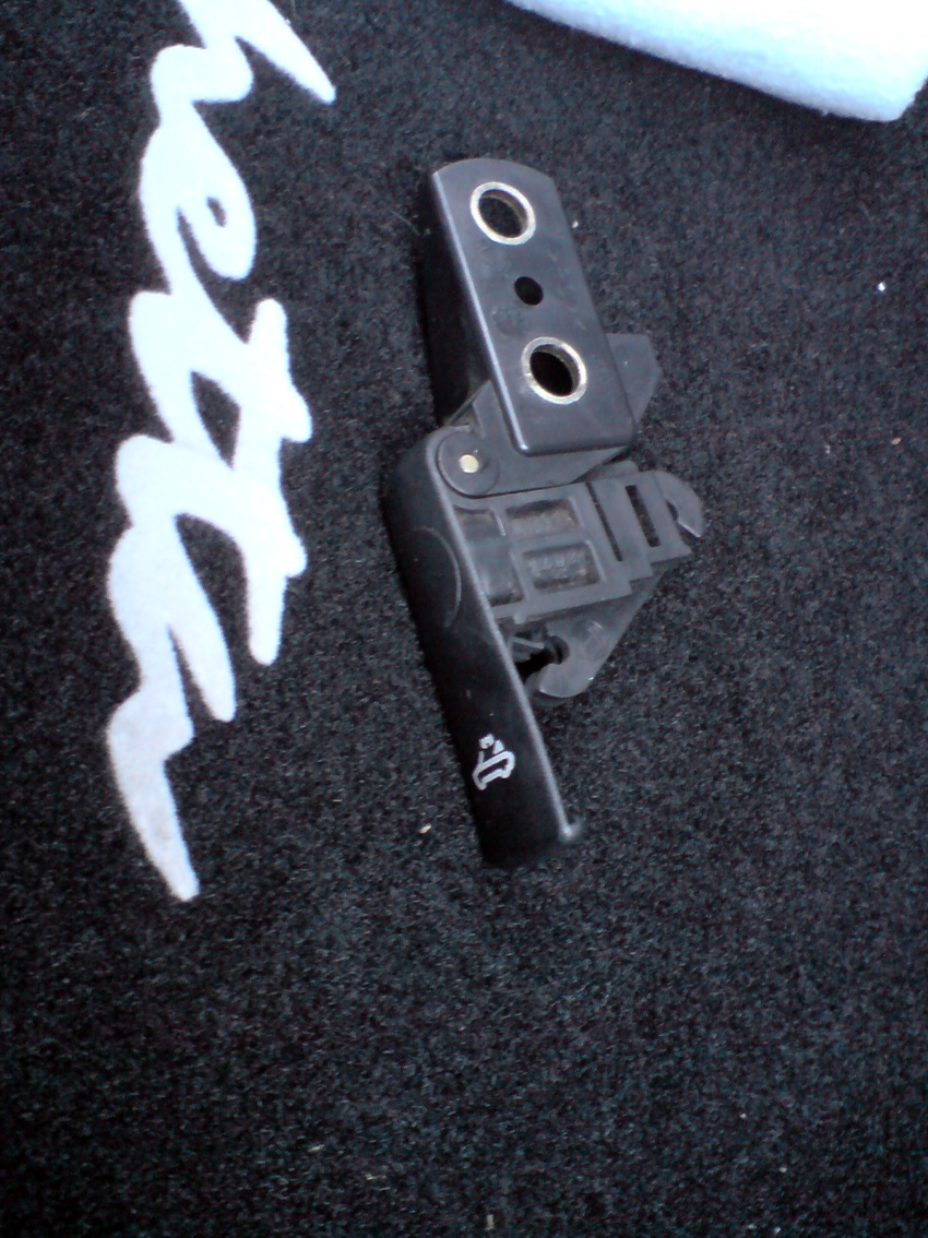

Next repair is to fit a new tonneau cover release lever (not sure of the official part name). Pictured is the broken one which snapped in the summer and the replacement part that I have.
Does anyone have experience of fitting this bit? I guess I need to dismantle the housing and have a look.

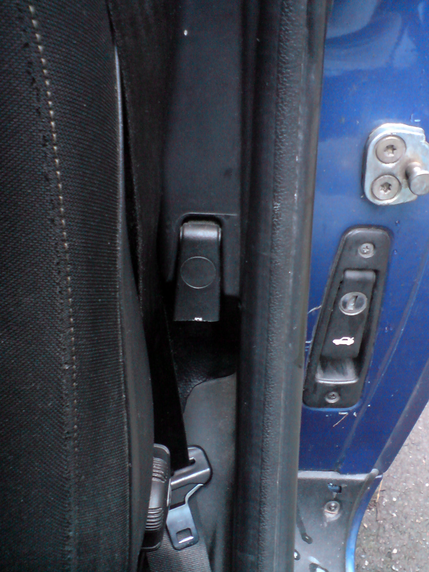

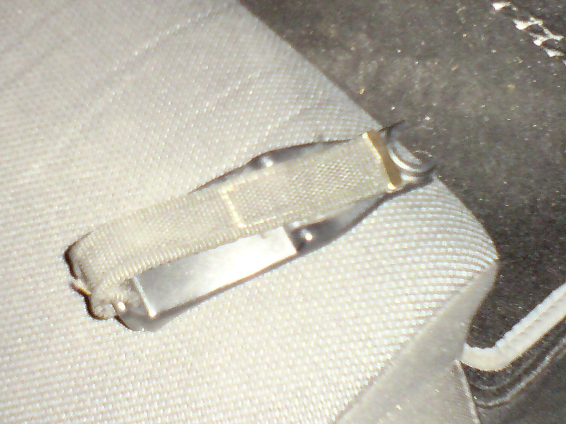

i don't have this part... kinda belt holder... i have to create this... it prevents cramp in arm while stretching for belt...
does any body have better pictures? i saw somewhere this it looks like piece of plastic and fabric tape with bur.
