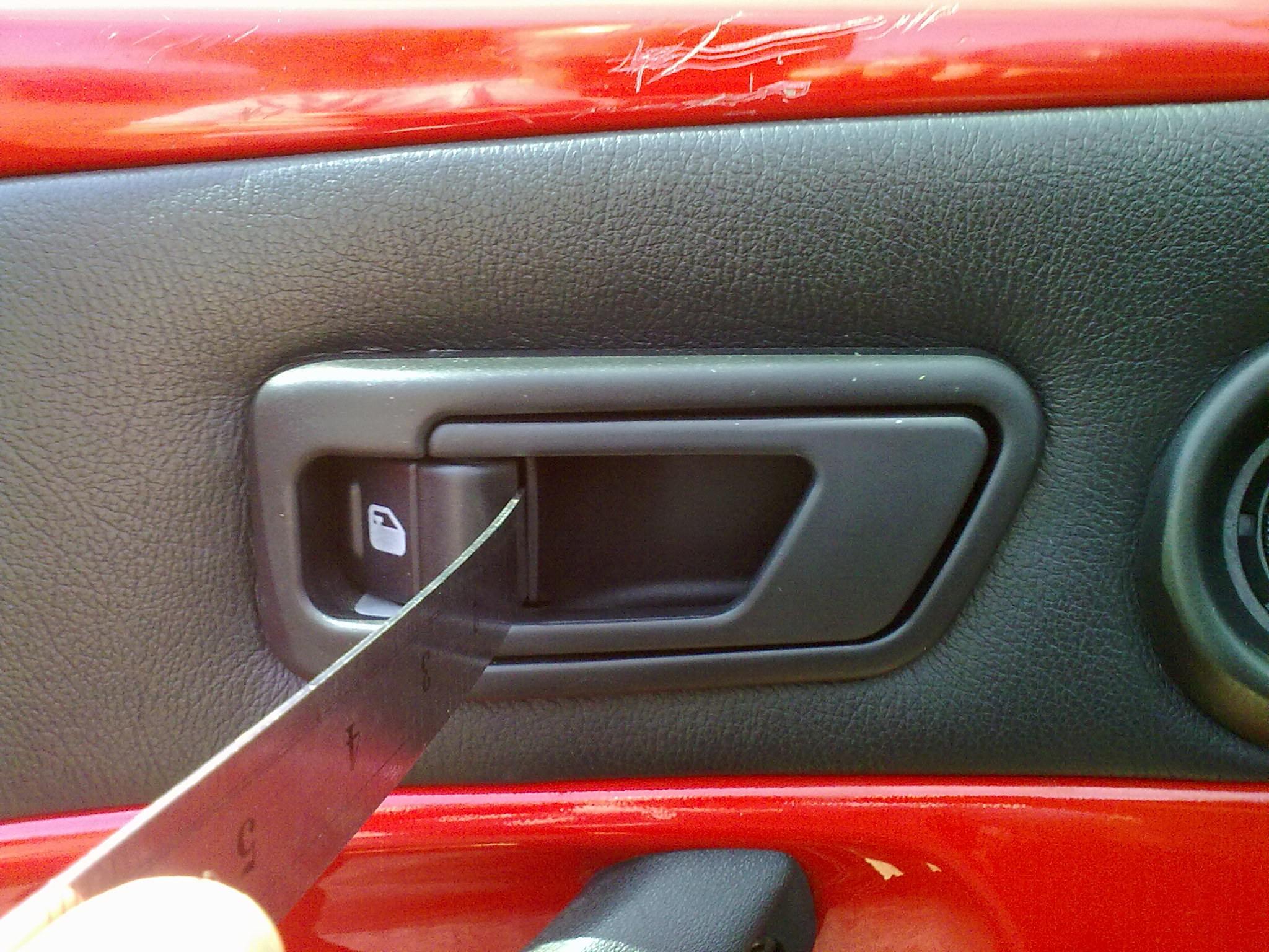

Yes to remove those covers over the openers you need to lock the door at the pin with a screwdriver or something.
Then you can remove them but indeed a pain in the ass if you don't know exactly how to get them off.
Ps: don't forget to unlock the door before slamming it:bang:
I find this helps a lot:

I just need to replace the plastic round the door open pulls. These are a pain to get off. Do I need to have the door lock pushed in to do this?

To remove the door pull surounds you remove the small allen key, door handles and tweeters then ease the whole panel away from it clips and then pull sideways outwords towards the rear of the vehicle and it comes away.
There is a guide somewhere that explains this in better detail.

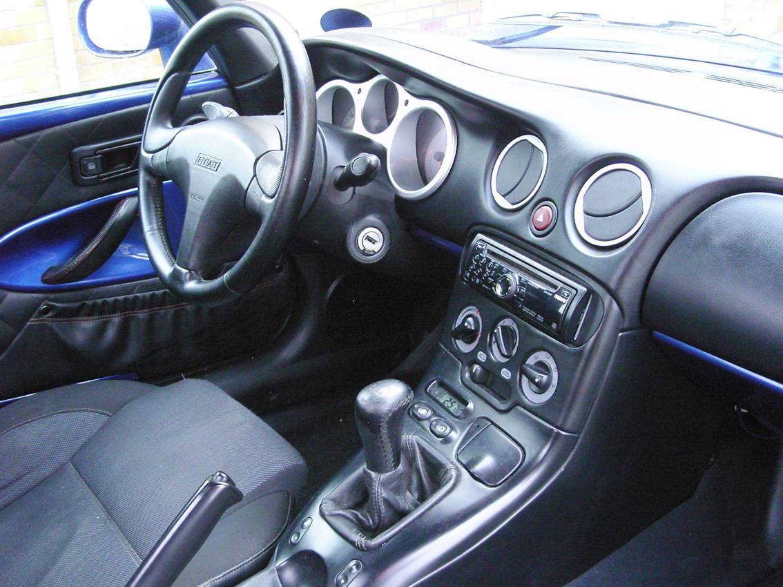

Thanks F4usT. Finally got it out. Still having problems turning the new vents but they are facing the right way and may loosen up over time. I am putting the new cover over the instrument dials now - in the dark - again.

Here is my interior with new vents and dials surround. Thanks to KC3. Still have a few bits to get. Most importantly the leather seats.
