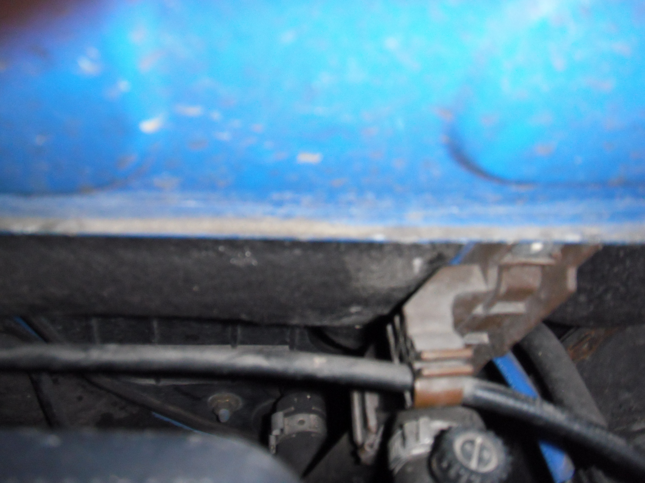

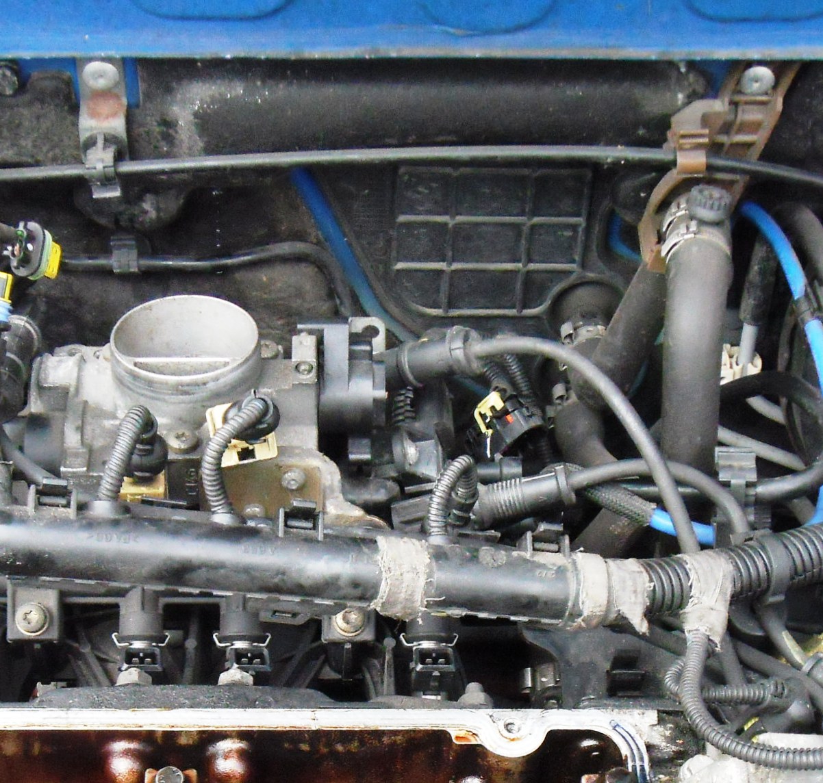

hi again,
I've tried to take pics tonight ( in dark - not good) so here is a cropped close-up of my earlier pic,
at the upper RHS of pic , you'll see a brown plastic bracket( not fitted to your panda) just to the left of the BLUE fuel hose we keep mentioning ;)
behind the Brown bracket you'll spot a Black shiny semi-circle..THIS is the bottom of the drain tube / AKA Duck Bill,
squeeze it's longer edges together,
mission accomplished (y)
once you've got over the elation ..;) you MAY want to do the other one..!!
upper LHS of pic..splashed with mud on my car :eek:
You'll notice they are BOTH directly under a shiny Aluminium Rivet on my car,
looks as if your car doesn't have these , or the Sound deadening material ...(n)
naff picture taken in dark :eek:
you CAN see the curved lower part of the Duck-bill behind "MY brown bracket" though :D
panda maint dec 13 001.jpg,
over view,
follow the BLUE fuel hose towards the REAR of the car,
trace down the rear of engine-bay ( under a Shelf -type feature),
move slightly LEFT( towards centre of car) ,
that's the duck-bill..!!,
have fun,
Charlie

ok, so I definately know where you're referring to with your pics, when I compare them to mine though, your engine looks totally different, my blue pipe seems to be more central, is that correct?
my engine was half apart..major work I'm writing a GUIDE for..,
from your earlier pictures the Blue fuel pipe is in the same place as mine,
it's just not got the Brown bracket supporting a Water hose..that you haven't got either..!!,
as I say.. follow the BLUE fuel hose under the "shelf"..move slightly LEFT and you'll have found it,
I'll try and do the Daylight pics for a guide at the weekend .
