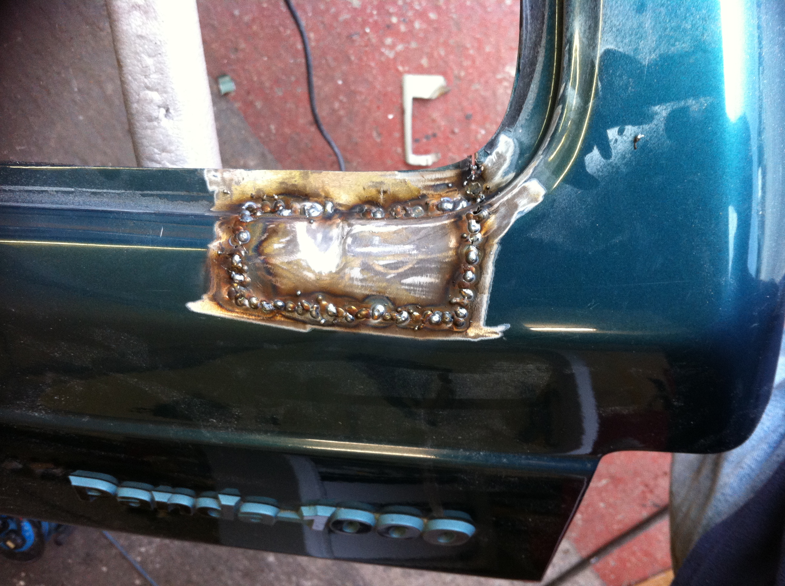

How would you do it Vern??
Cut the bits out and weld or panel beat?

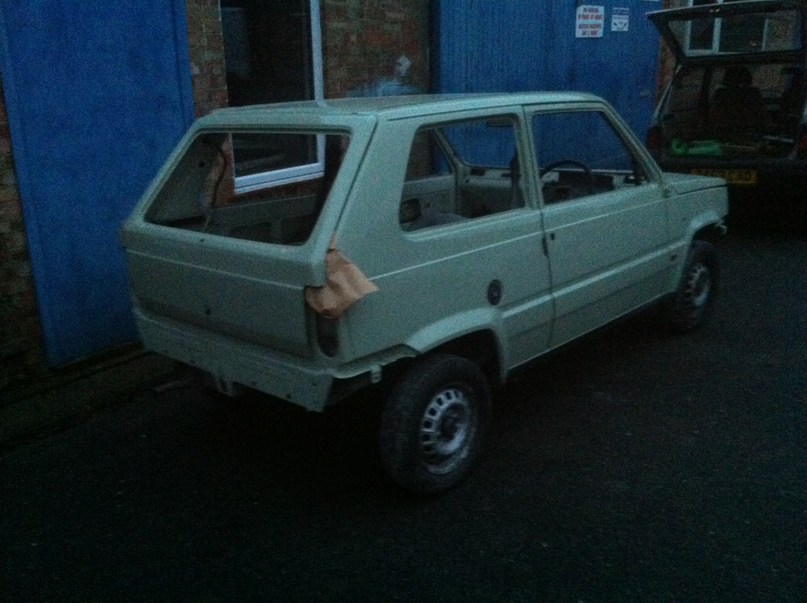

Well Betty is out of surgery and we've managed to attach a donor tailgate to her dimples. I'm pleased to say that the operation went well and she is now looking forward to her next operation. (y)
All the weld is now ground smooth and covered in a light skim of filler waiting for paint, which should be happening next week. :)

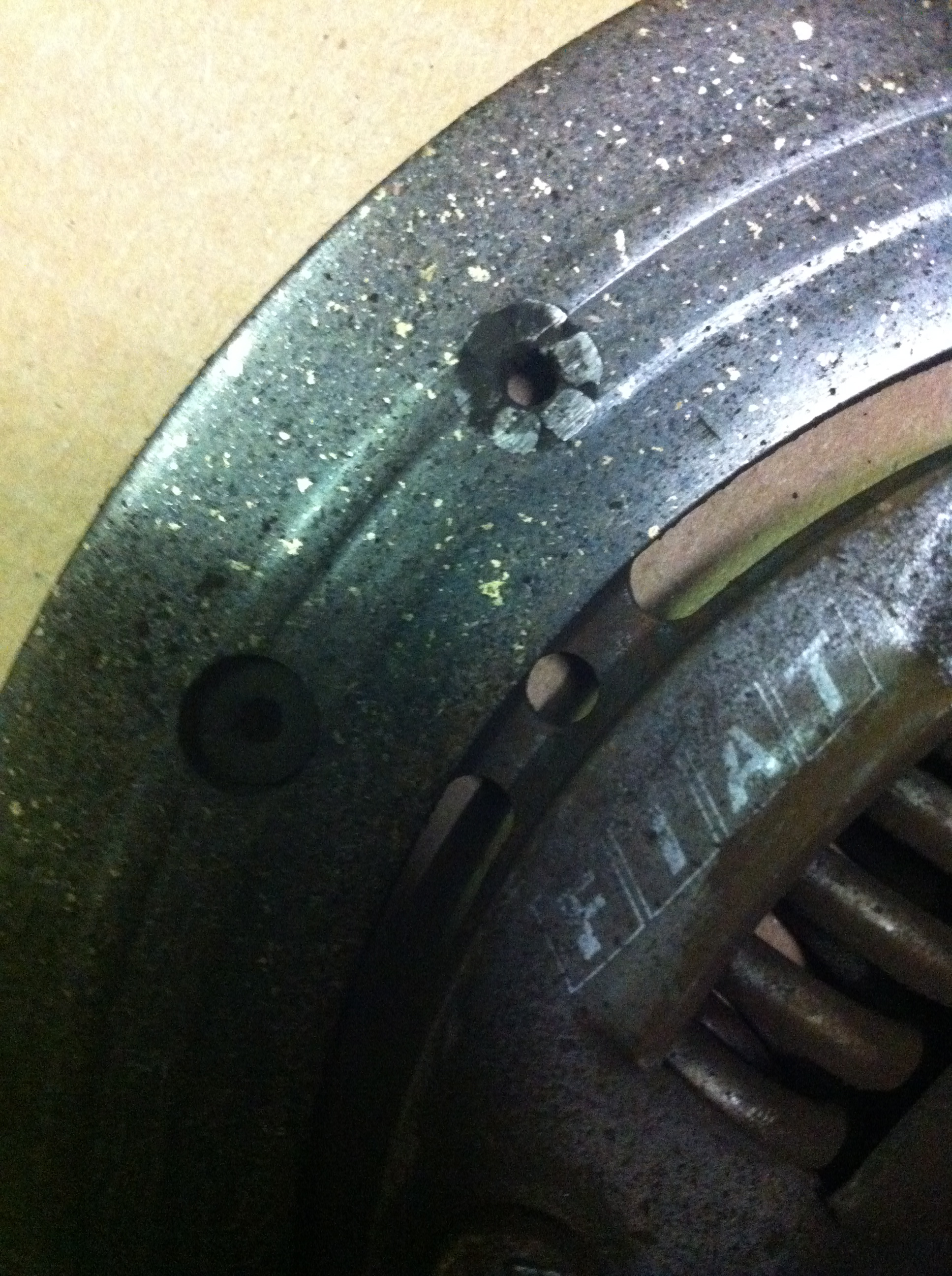

As you can see the clutch was down to the rivets on the pressure plate side, not very impressive for a 26,000 mile car. At least the flywheel was good.
We also replaced the inner cv boots which were split, and removed the clutch operating arm to grease its bushes which can be prone to seizing on a Panda that's been stood for a long time.
Despite appearances all of this was fully functioning, but we can't afford a last minute mot fail so I decided it was best to replace the discs and pads.

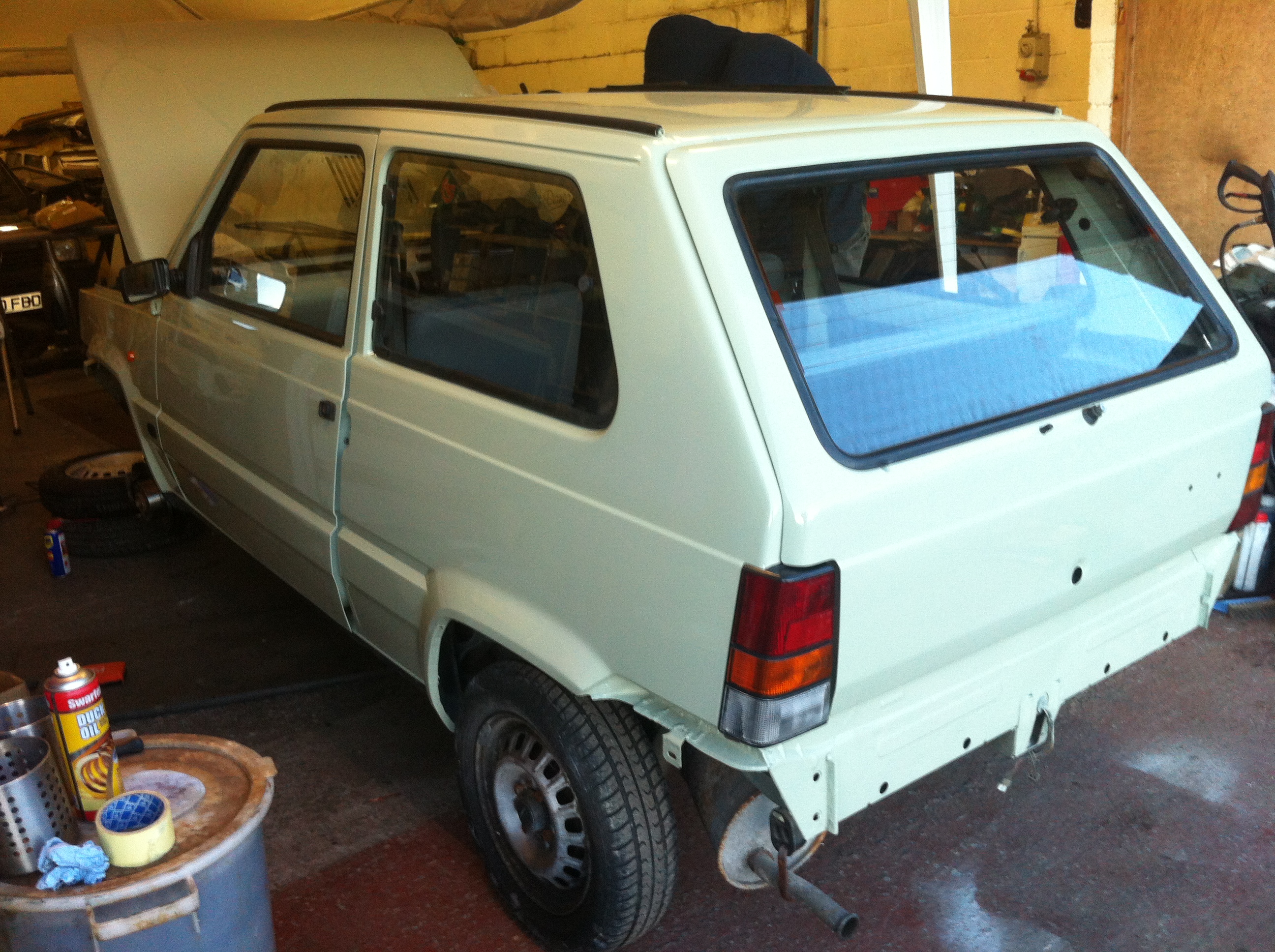

With the body now looking so good it would have been criminal to leave that rusty suspension as it was, but there was no time ( or budget ) to strip and paint it all, so a quick once over with a can of black Hammerite made a suitable compromise.

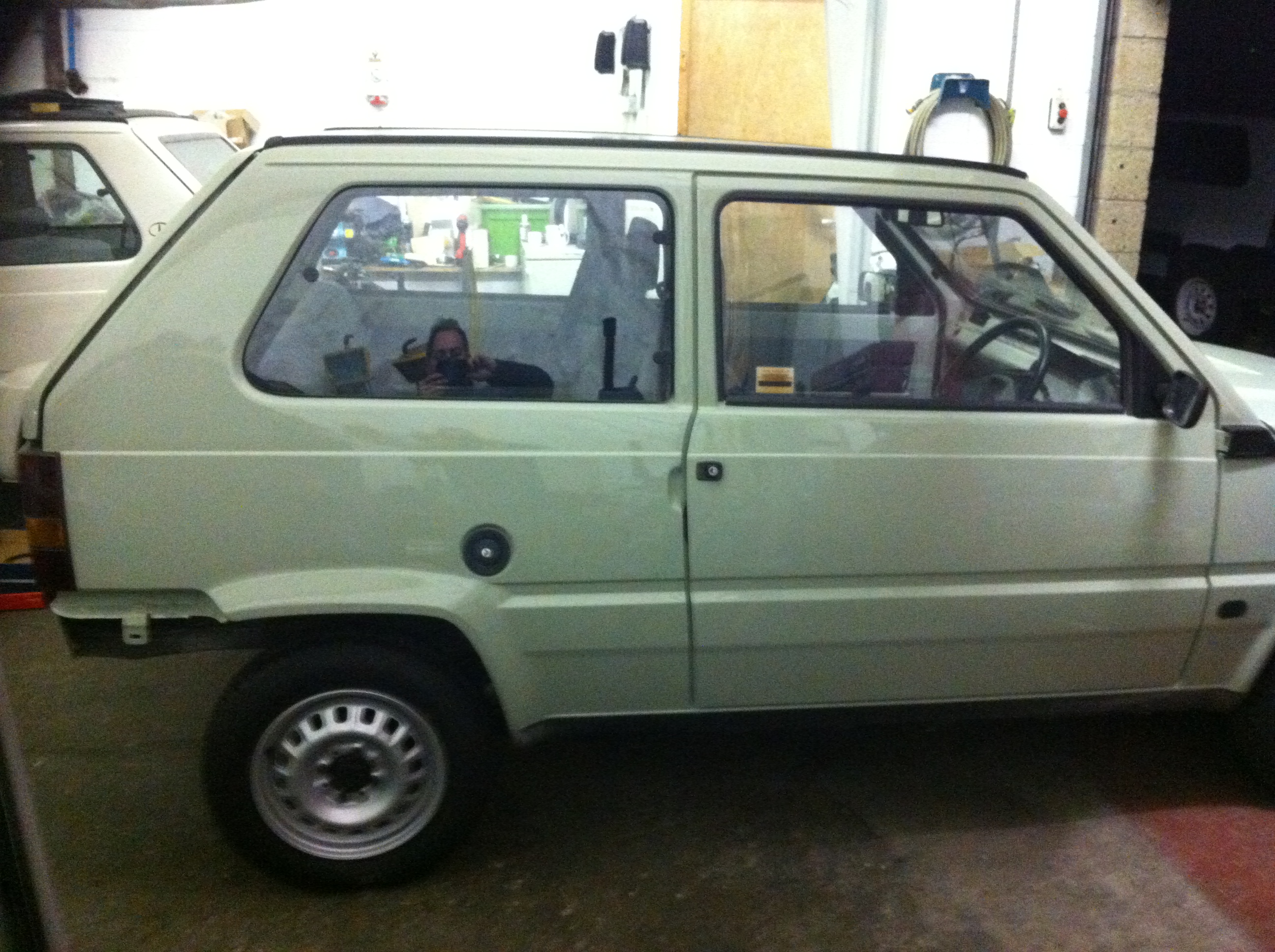

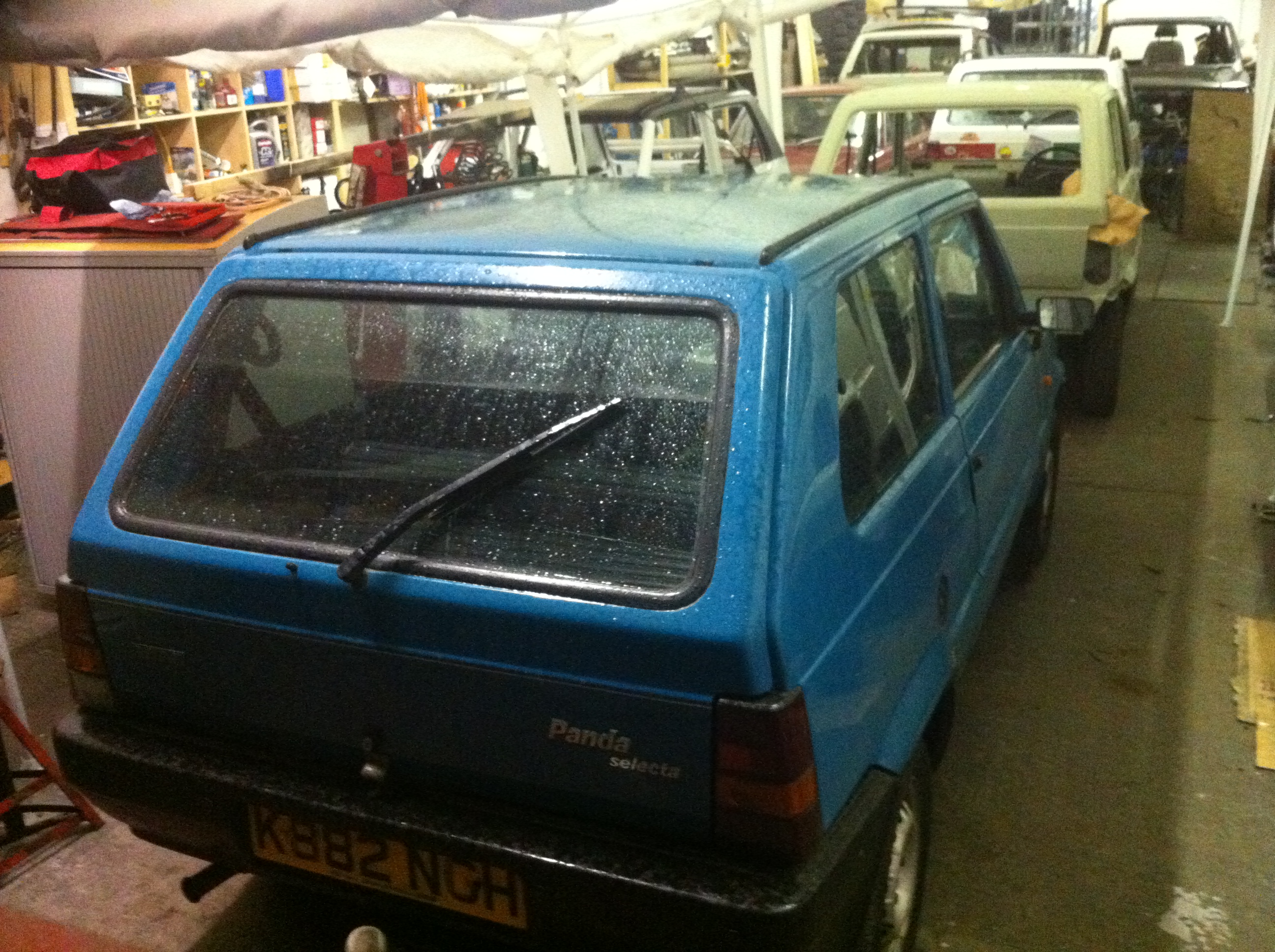

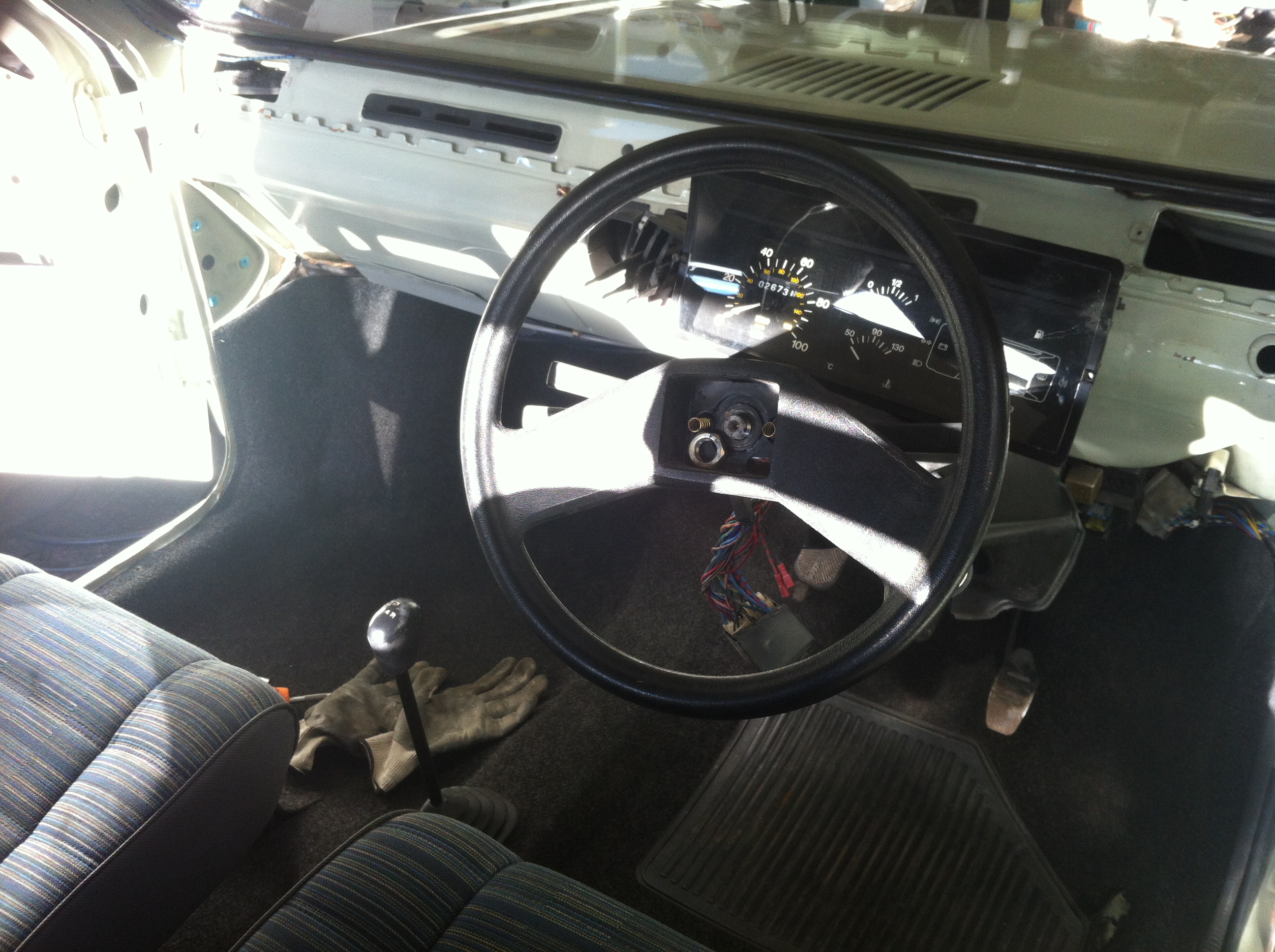

The new interior was stripped out of the green Selecta I have, then fitted to Betty. I still have the dashboard to go tomorrow, then it's done. Not original I know but I do support Stephen's decision to go for it because he's paying me for..............sorry, I mean because the original was so faded and stained that it would have really let the rest of the car down. This can all be reversed if a good grey check interior turns up in the future and Stephen wants to swap back.

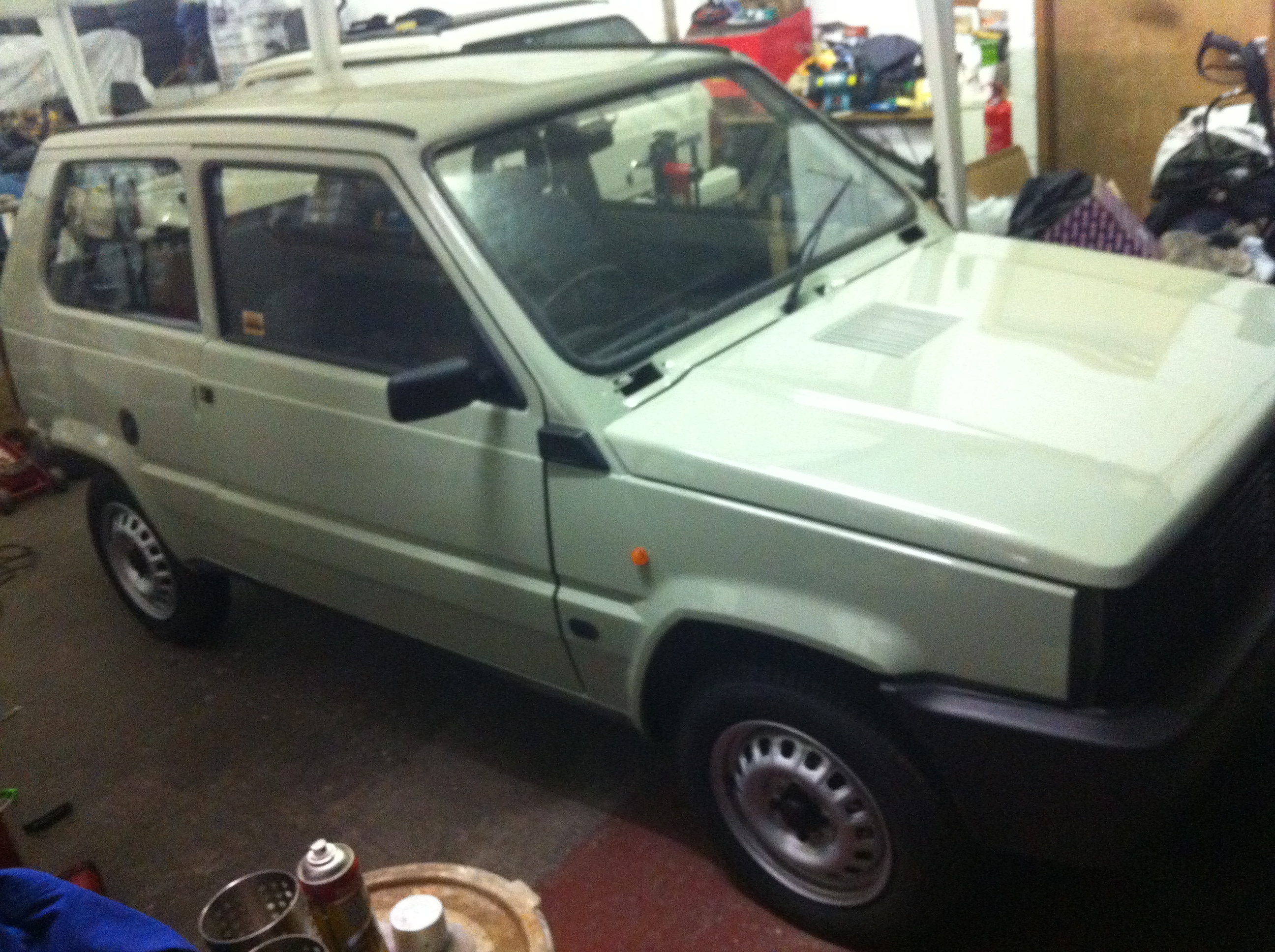

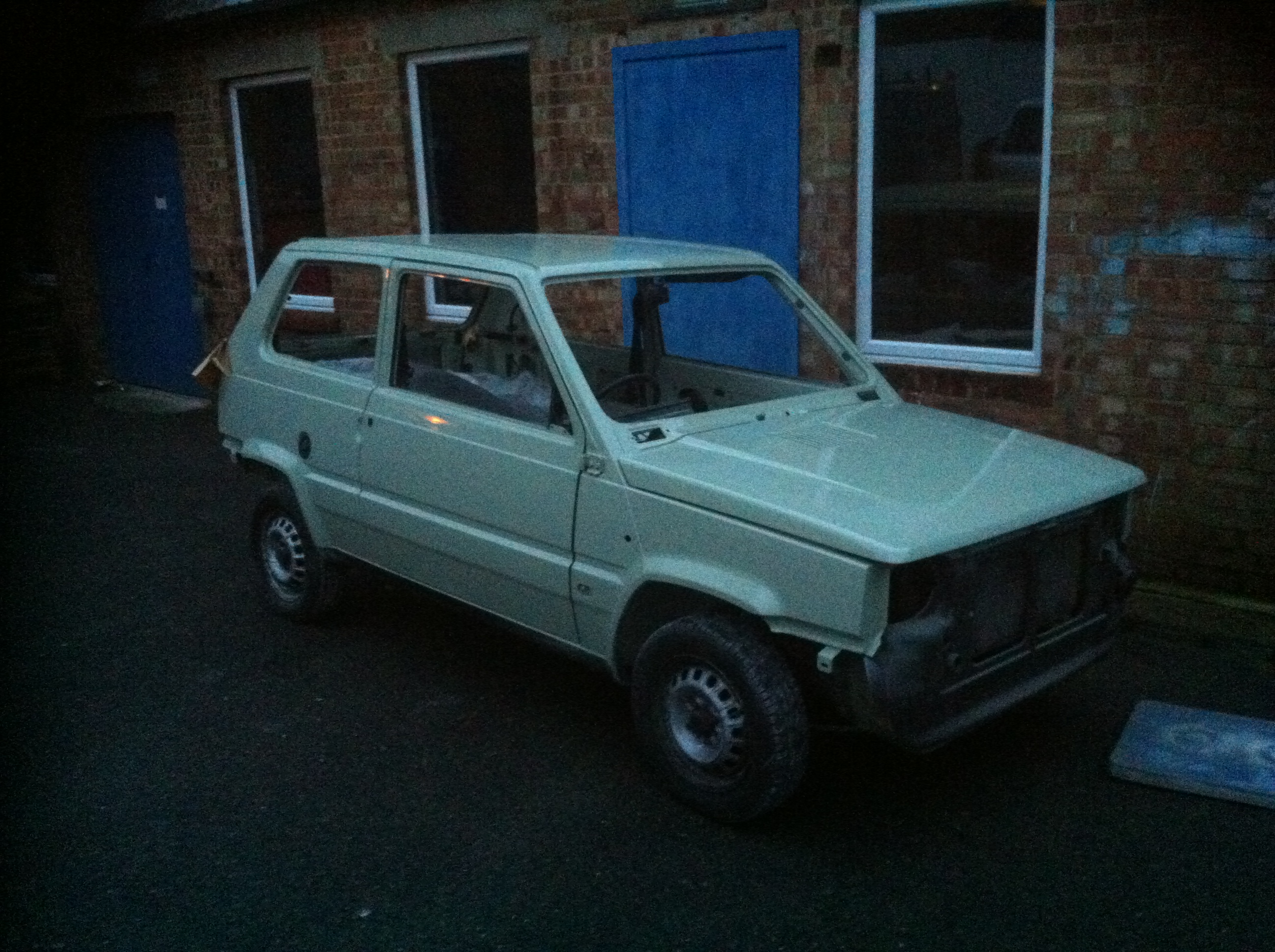

Fit up of the exterior is also nearly there, new wheels look very smart, just headlights and back bumper to go. Phew!
Thanks for all your hard work, Vernon...! :worship:
BTW: I think Kevin may have the only half-decent grey check interior in existence...! :eek:
Edit: Having had a closer look at the piccies, I'm starting to feel like a proud father...! Thank you also for fitting the (and yes, they can be reversed...) adjustable mirrors, and the door pocket...! It's the little things that make me happy...! :nutter:
...that colour is so right..looking forward to seeing Betty in the flesh.
So am I...! Roll on Wednesday...! :D
