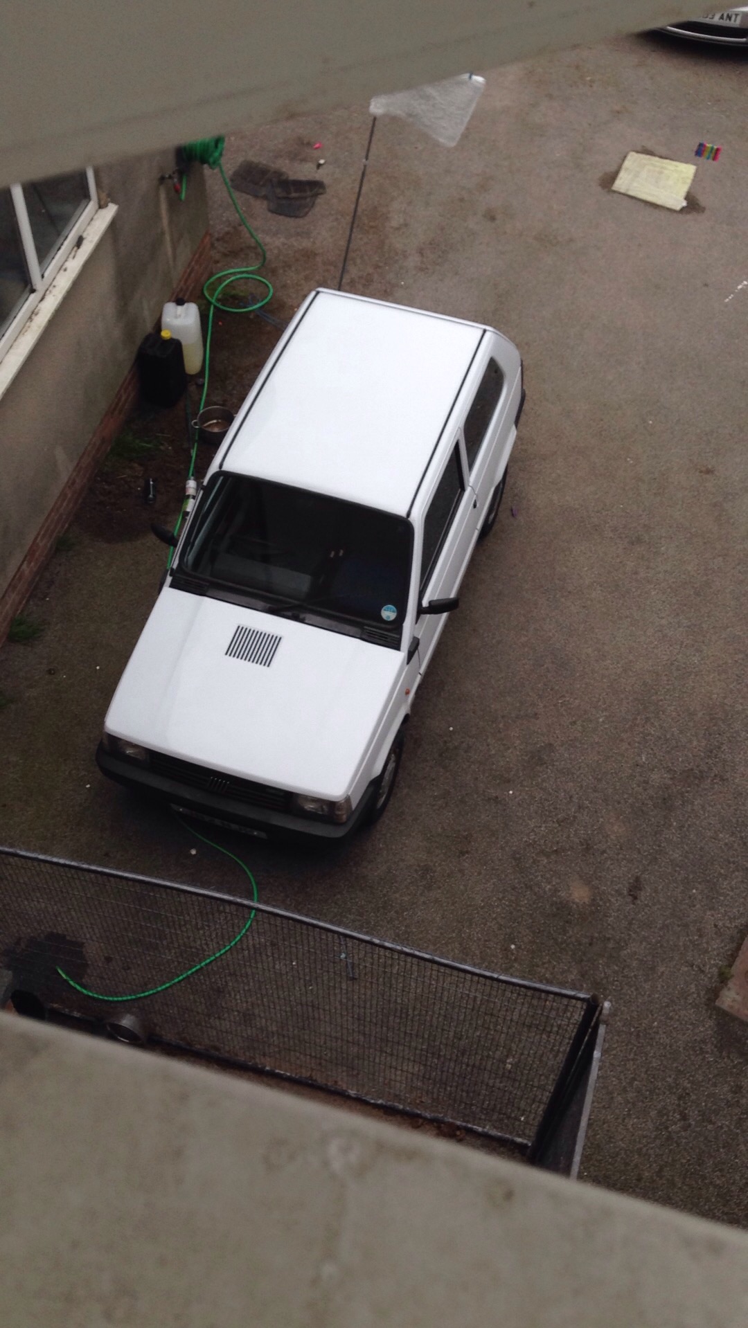

Great advice so far, your car looks lovely as it is and probably drives superbly but I remember the urge to tinker being never stronger than with that first car.
