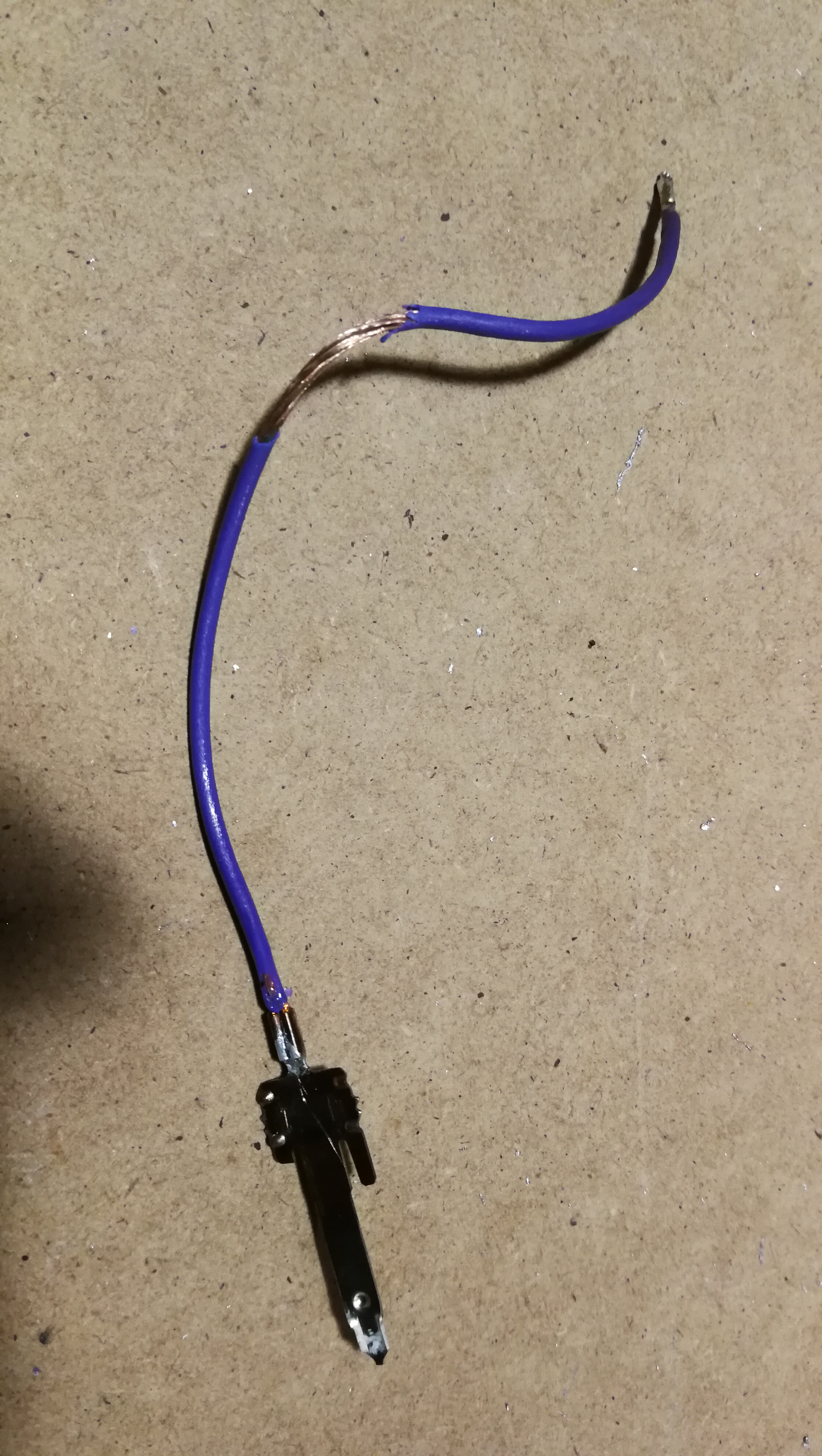

Hello,
It's an old car, wire insulation could be broken somewhere. Or the lever can have a short.
I had a similar problem in my 17 or 18 years old non-FIAT, the insulation disintegrated completely on a piece of wire on the indicator / lights lever. Luckily I've noticed it early enough, before I got any problems.
