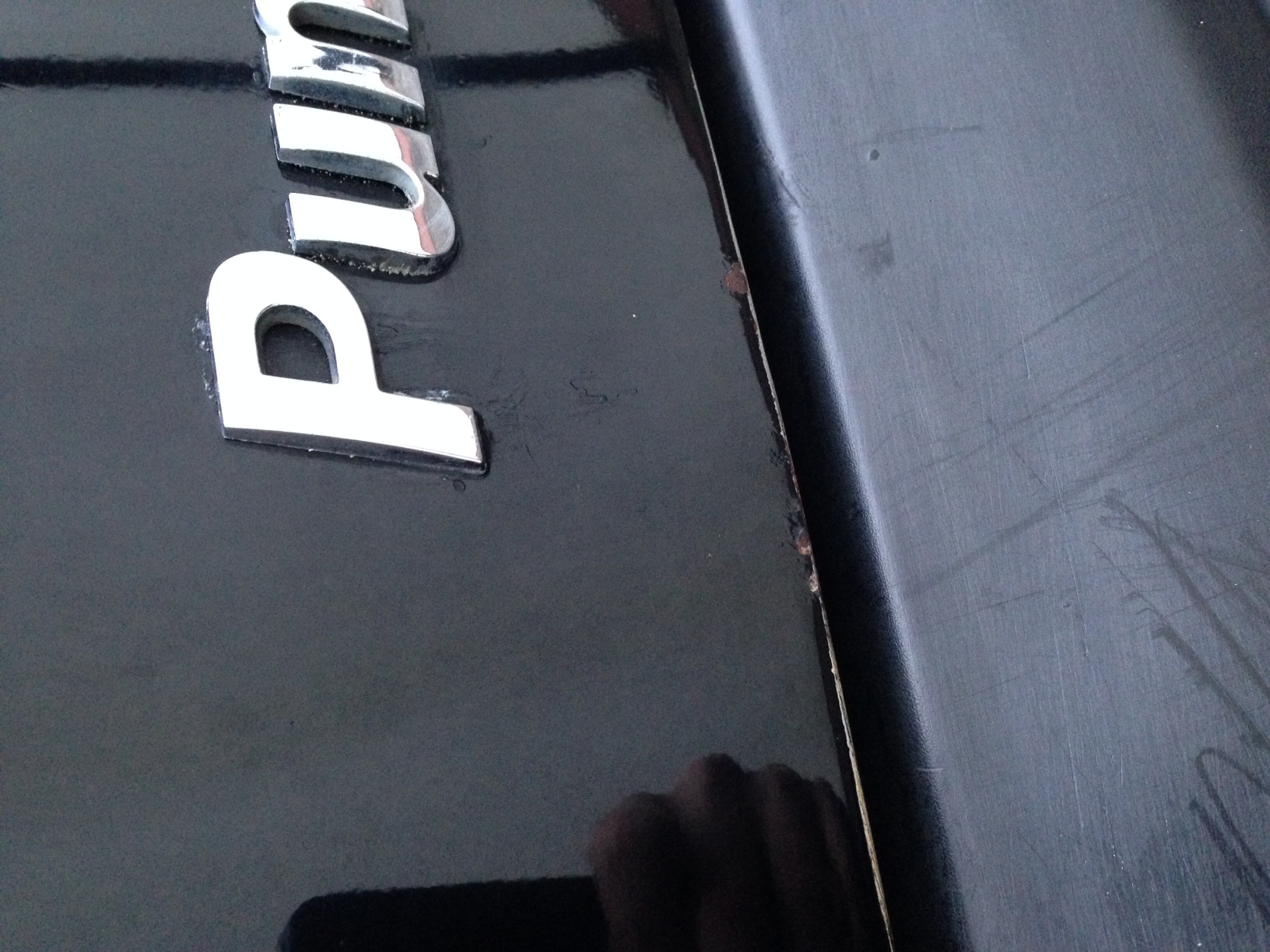

the small scratches do not worry me a lot, what worries me is the rust and kind of the paint peeling off! :( See the two pics attached
What do you recommend?

Ok, and is this something that I can do myself (I have no experience)?
learn to spray paint, :D
find old car pannel wing door etc, and practice with rattle can on it,
most people rush in see,and crack on with the job and end up with runs galore,
result is half tidy car ends up looking like its a shed,
watch some videos on youtube,
thats lacquer delaminating due to poor prep
i guess its been lacquered rather than buffing up old paint but substrata not prepared properly
you have a problem because its on top of rear light and in your eye
i would scratch off round edge with a finger nail to get to solid stuff then touch in round the edge with clear nail varnish to stop it spreading
try a little first in case it reacts though
or get some lacquer from halfords and spray some in the lid and use an artists brush as above
alternative is major paint
