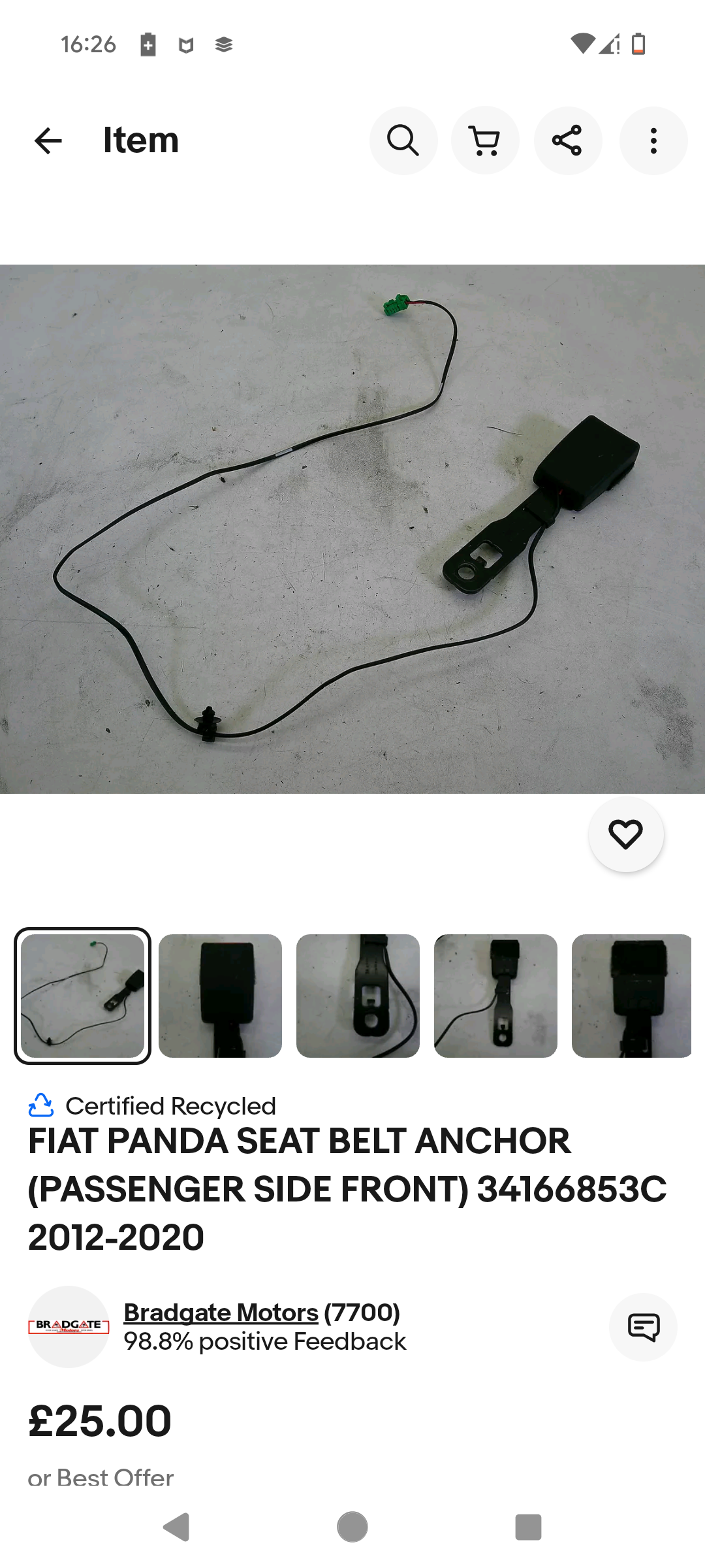

Or possibly need a new one of these?
Doubtful, that'll probably just detect (along with a seat pressure sensor) that a passenger is or isn't wearing his/her seatbelt. (just like the drivers)

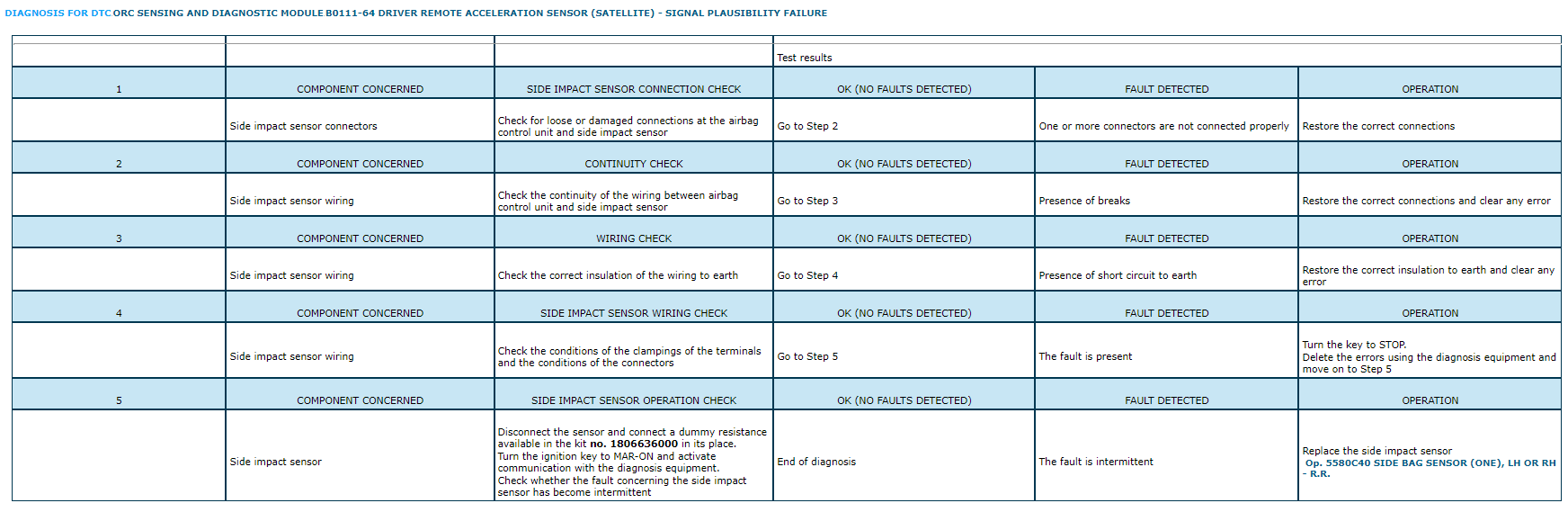

The B0111 is a standard Body code - Side impact module-Left Rear high and/or low circuits is short to ground or short to voltage
The -64 just narrows it down further and is fiat specific......so I've not much info on that code extension apart from the attached pic.
To say they've never heard of it doesn't say much of their experience.....

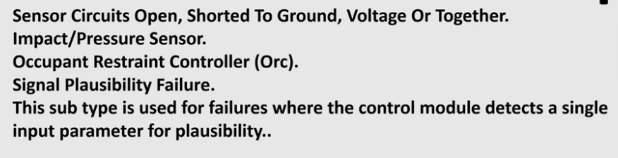

This is NOT a FIAT description, stop messing, please.
The airbag system is too sensitive and too important to play blind. Or almost blind. Luckily the error is about the side airbag, not the front one, but still, no one wants it to get activated...
Chill out , if you read what I wrote: the B0111 is a standard body code, the -64 extension is fiat specific.
The codes/detail you've gained from your elearn system correlate with what I stated.
…and suggest a possible broken wire. While there are other possibilities, very often (in my experience) the fault turns out to be a poor connection (in any circuit, not just this case), or a voltage issue (either from low battery voltage or corrosion in the contacts if a connector).
Reading the Fiat specific code will narrow down the circuit, but maybe not the location of the actual fault.
