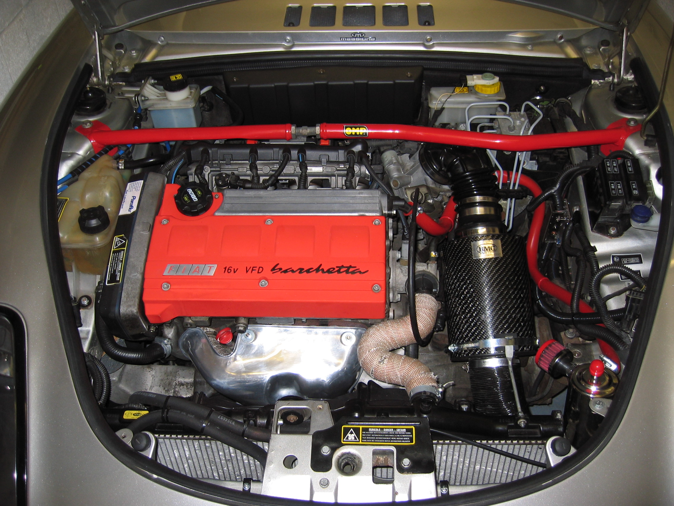

Matt, I have put a K&N filter on, the method I used was to keep the pipe from the throttle body, to this attach a ally adapter 70mm to 70mm, then the rubber flexible pipe that joins the air mass sensor to the existing filter housing, use this to join the ally adaptor to the air mass sensor, then the K&N goes directly onto the opposite end of the air mass sensor. the space is very tight, I have also put an air feed in to cool things down.
FYI K&N part number RC 4540 ally adaptor SHJ 70 both from Demon Tweeks.
Regards Dave M

Please see below (y) I will be replacing the pipe work with chrome and red silicon joints at some point.
