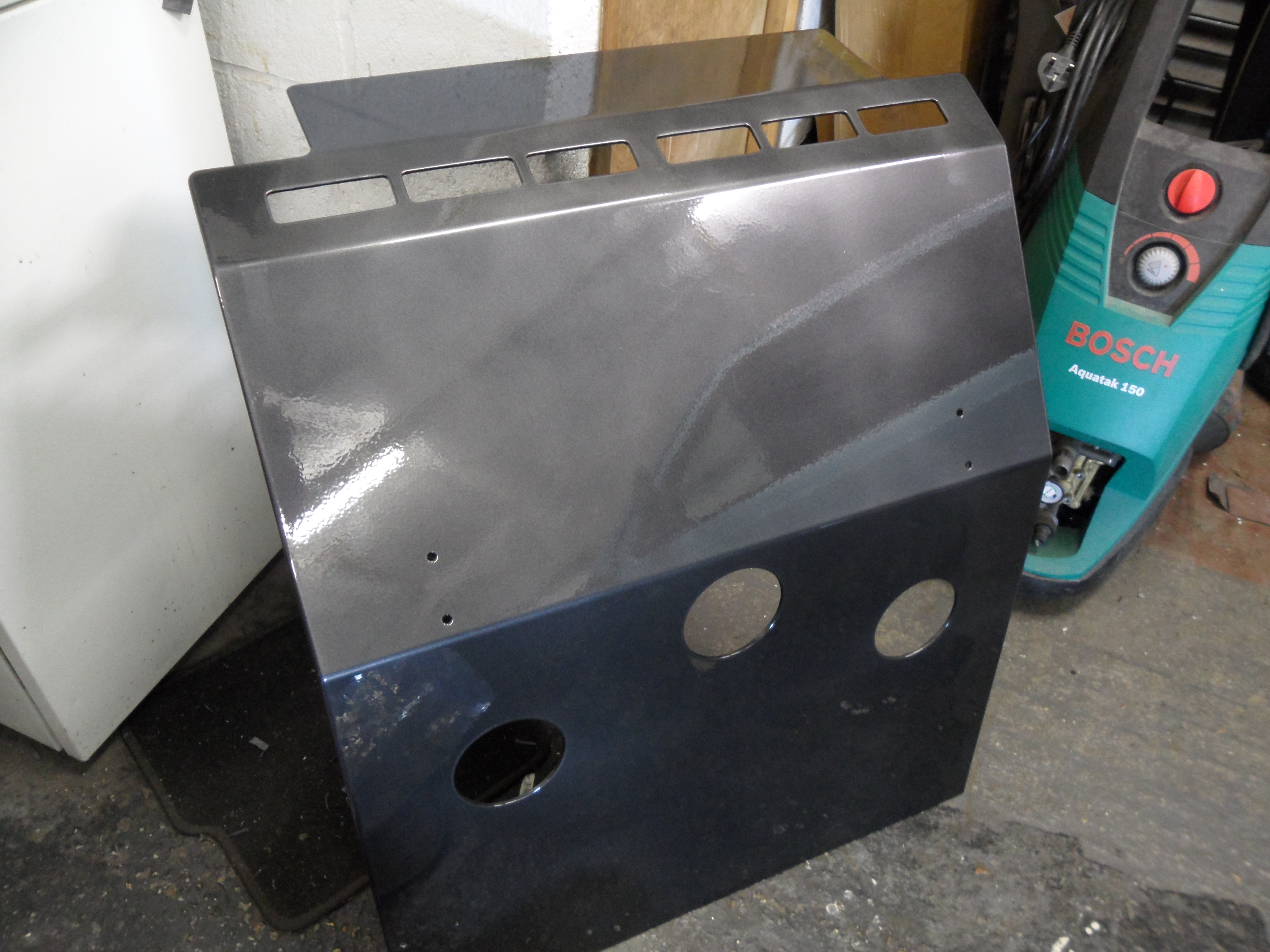

Rock sliders and sump guard were powder coated in a dark grey called anthracite.......
I did consider a lighter grey or even silver but when I saw this I was sold, felt it was a nice compliment to the blue bodywork, a lighter colour would be too showy and black too subtle.

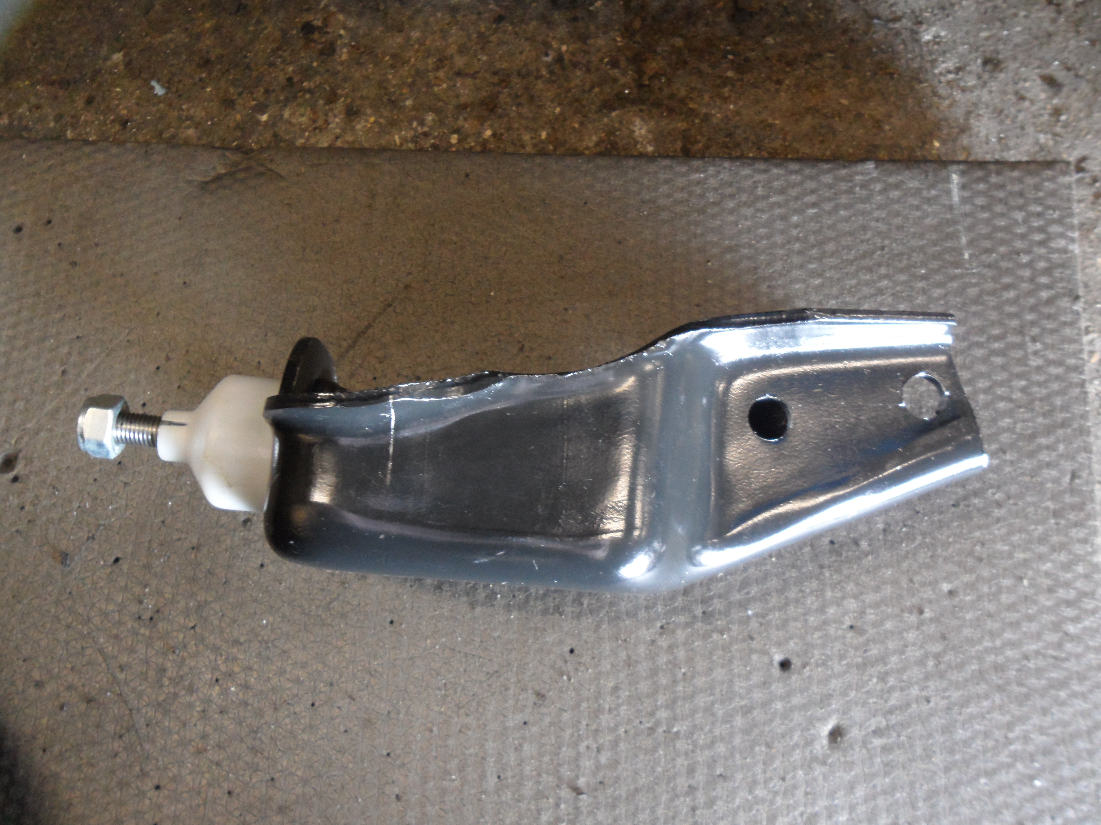

This is the modded ball joint carrier, not much to see as the holes are only 1mm offset, the top one toward the wheel, the bottom one toward the centre of the car.
It gives the front wheels a very slight negative camber and looks much better than the normal positive camber. I have some other pairs being re-drilled so will be able to supply them to anyone who fancies the same soon.

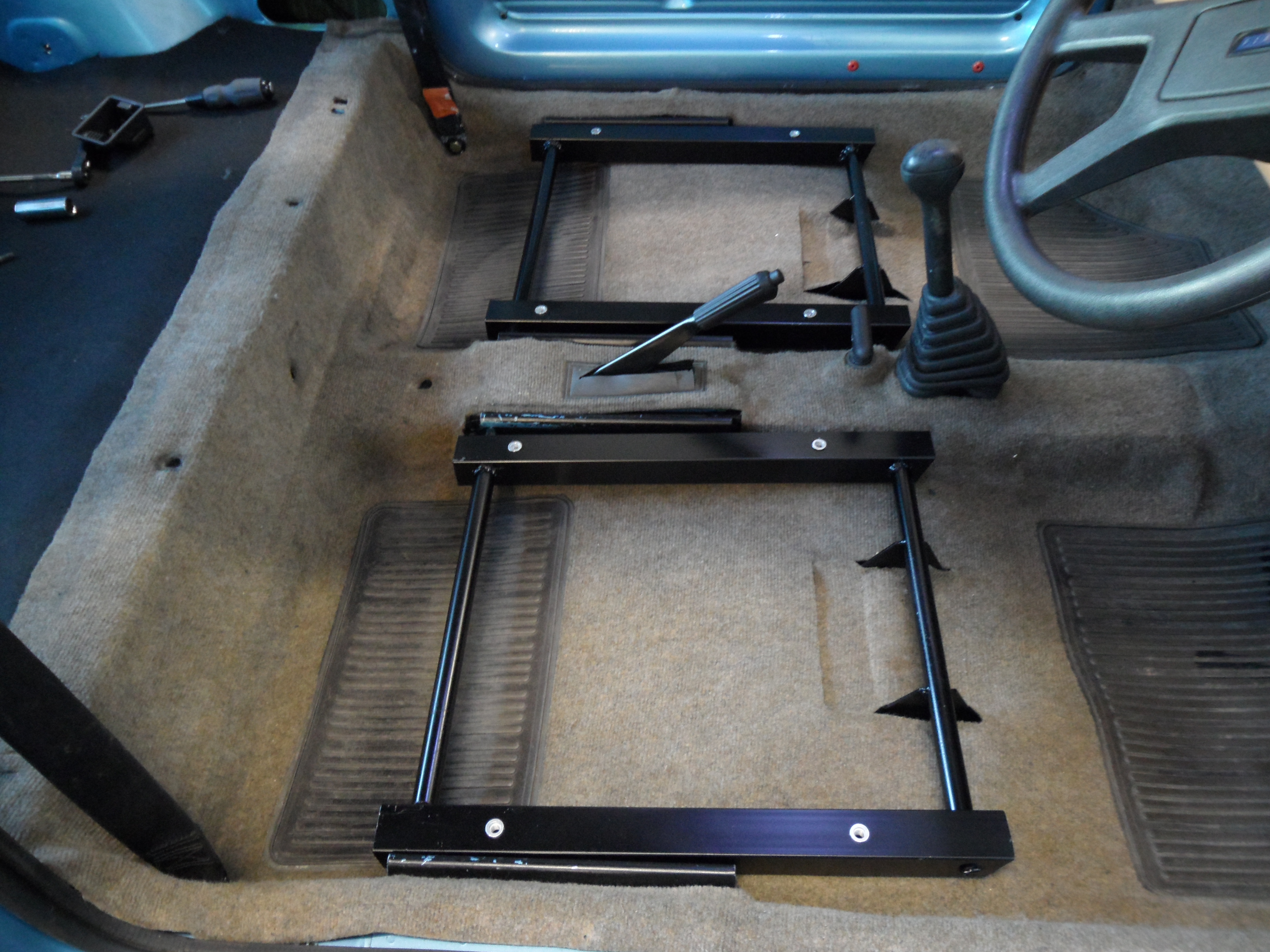

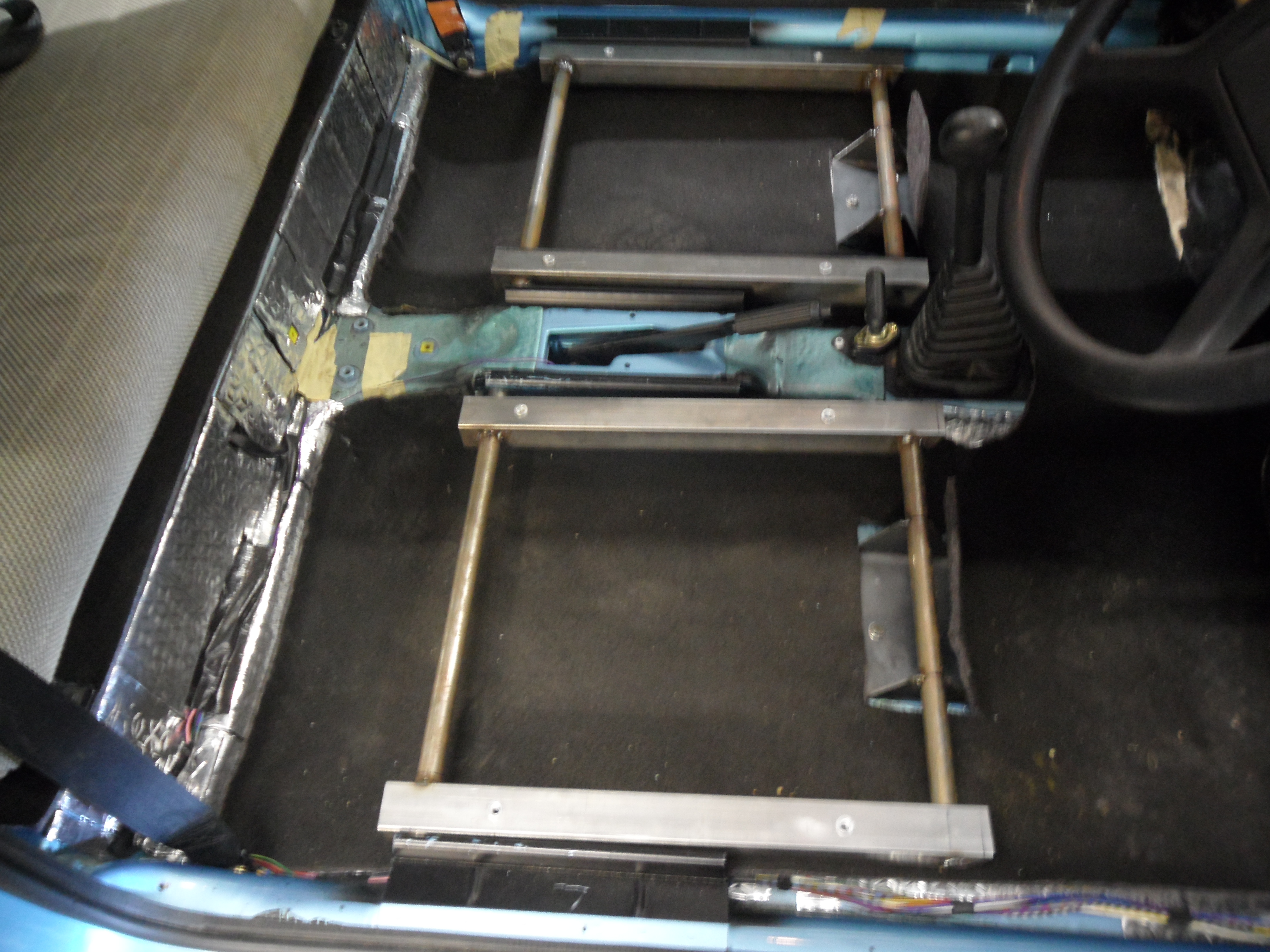

The seat subframes are the same as the ones in the white 4x4. The square box sections are farther apart in this case as I'm using Alfa 147 seats rather than 156's and they are wider.

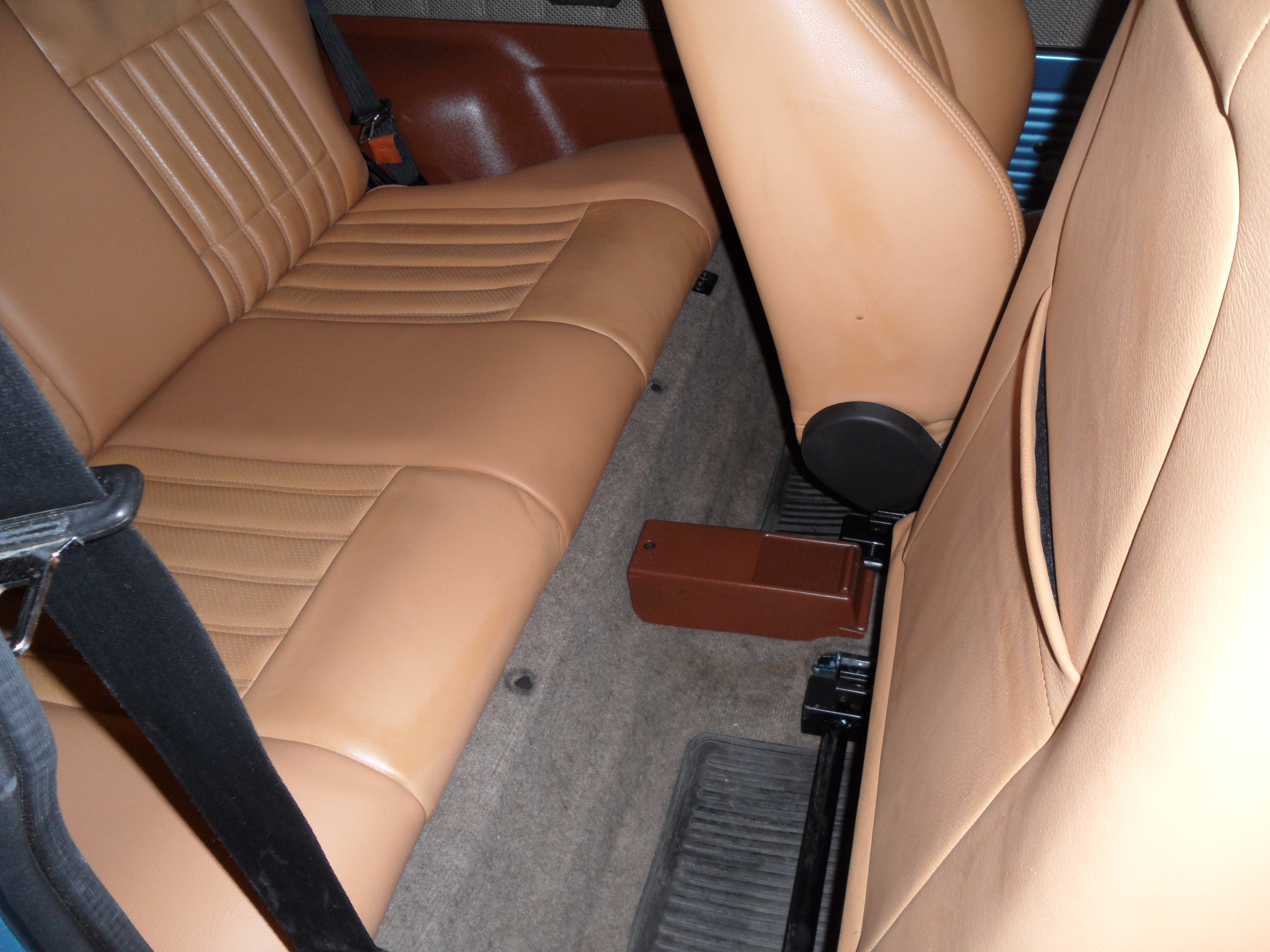

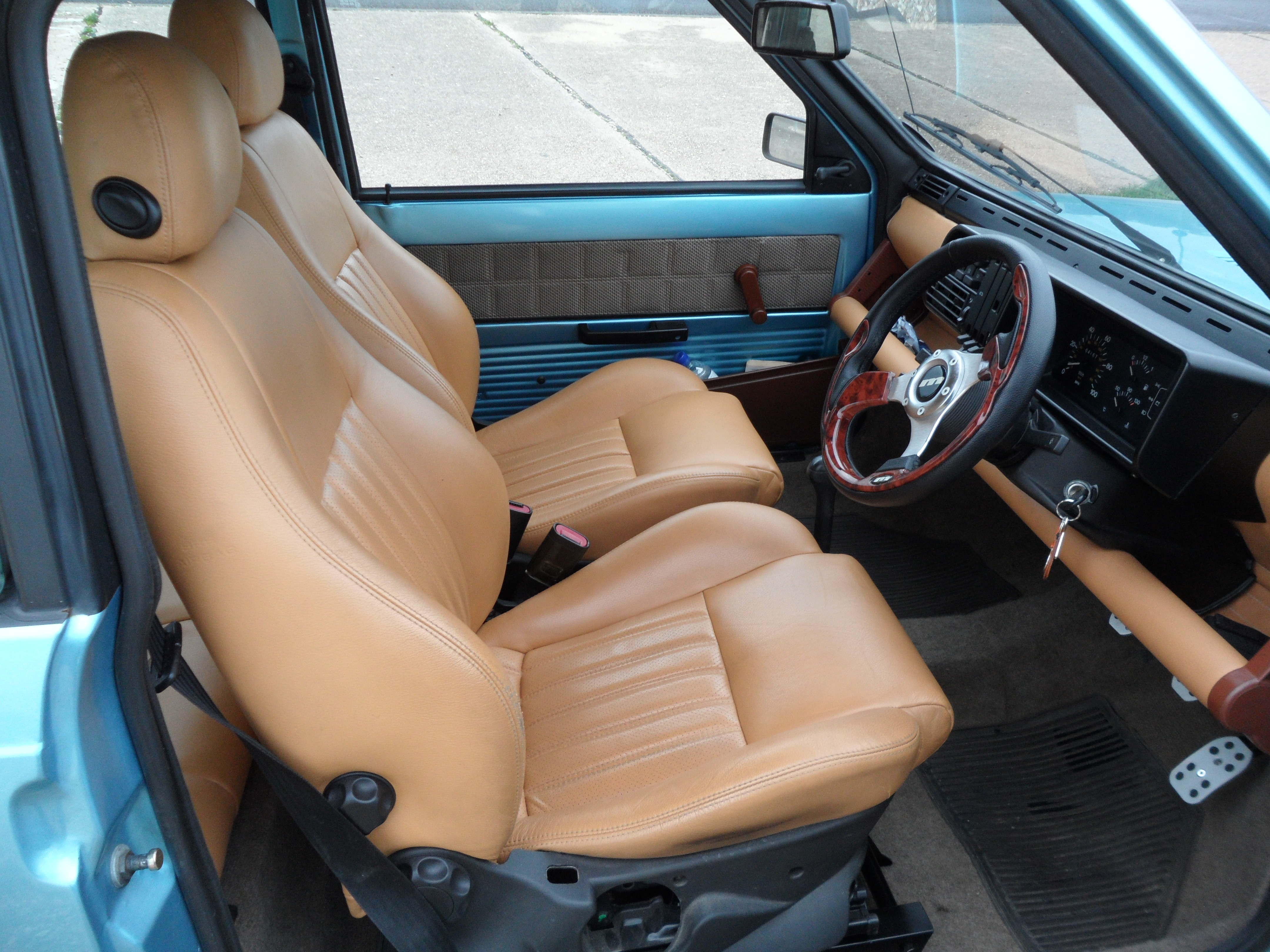

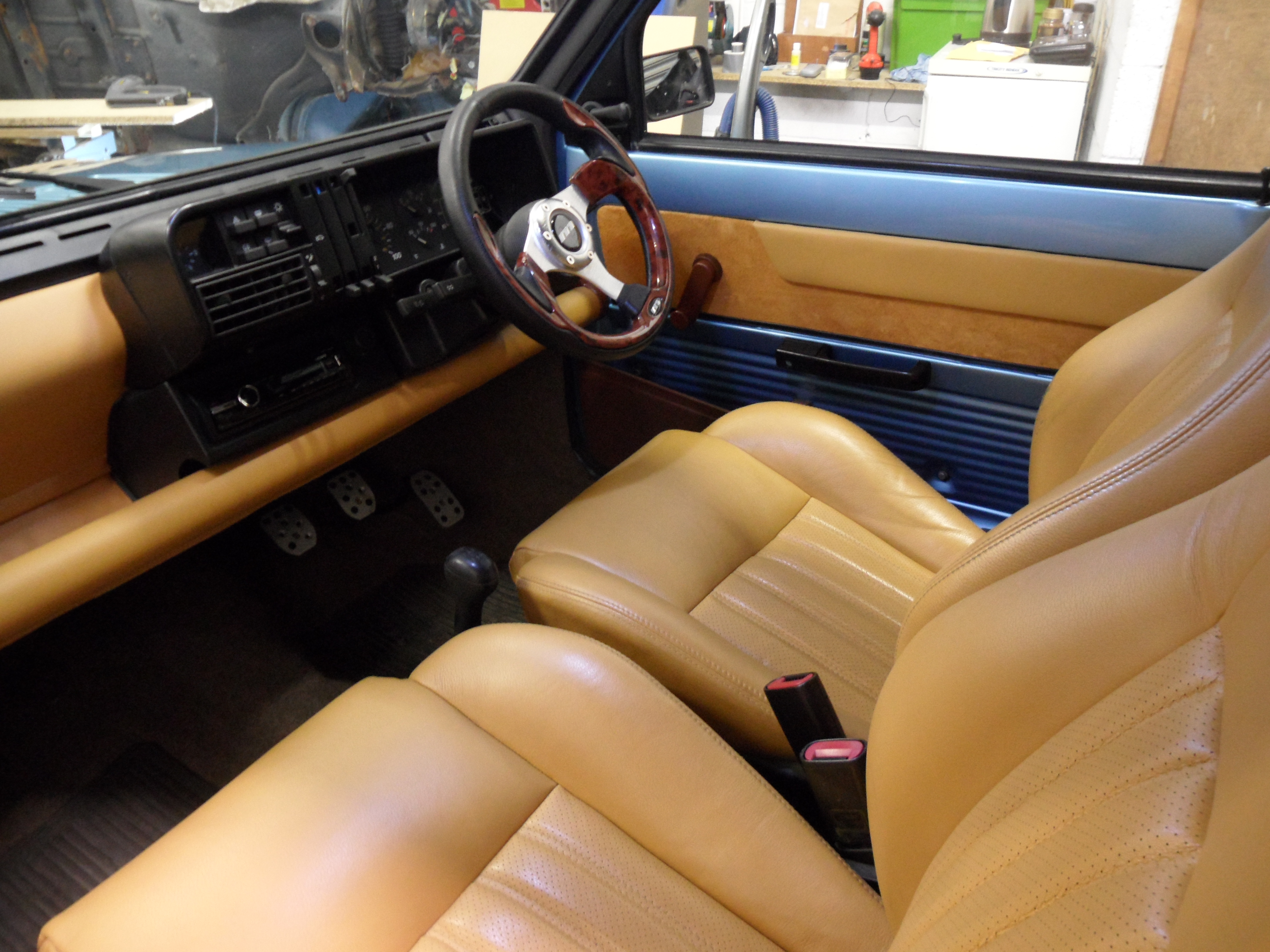

I had a crisis of confidence when it came to carpeting before the NEC and didn't want to rush it, so rather than using the stuff I've bought I temporarily fitted the old carpet from the white 4x4.
I didn't manage to make the door panels in time even though I managed to buy some matching leather for them so this is how the interior looked at the NEC.

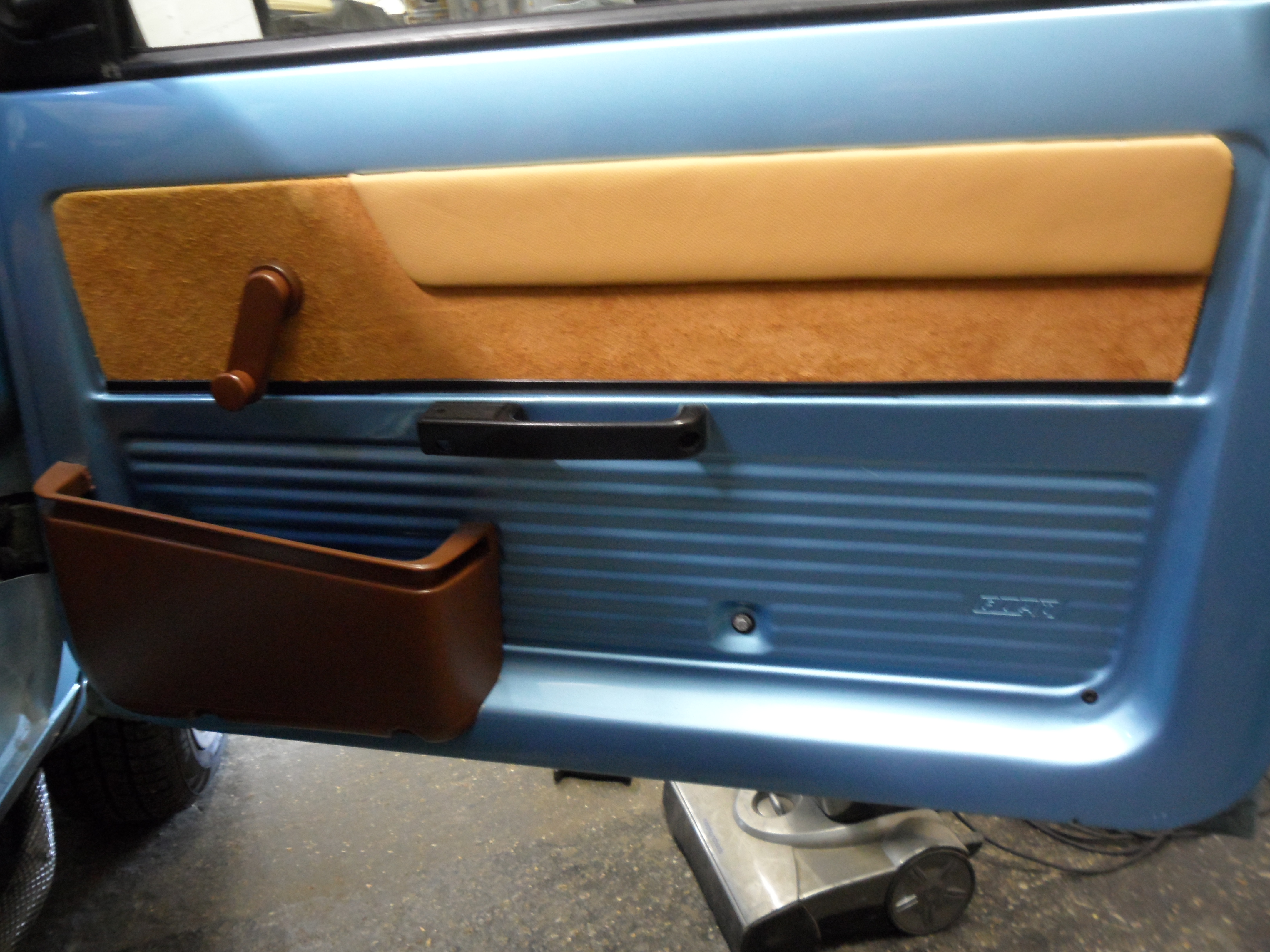

I had painted the rear wheel arch covers, rear ashtray, window winders, door pockets and dash supports brown with vinyl paint. I still have the inner door pulls/handles to do as well as the speaker pods, and will be painting the instrument pod graphite grey soon.

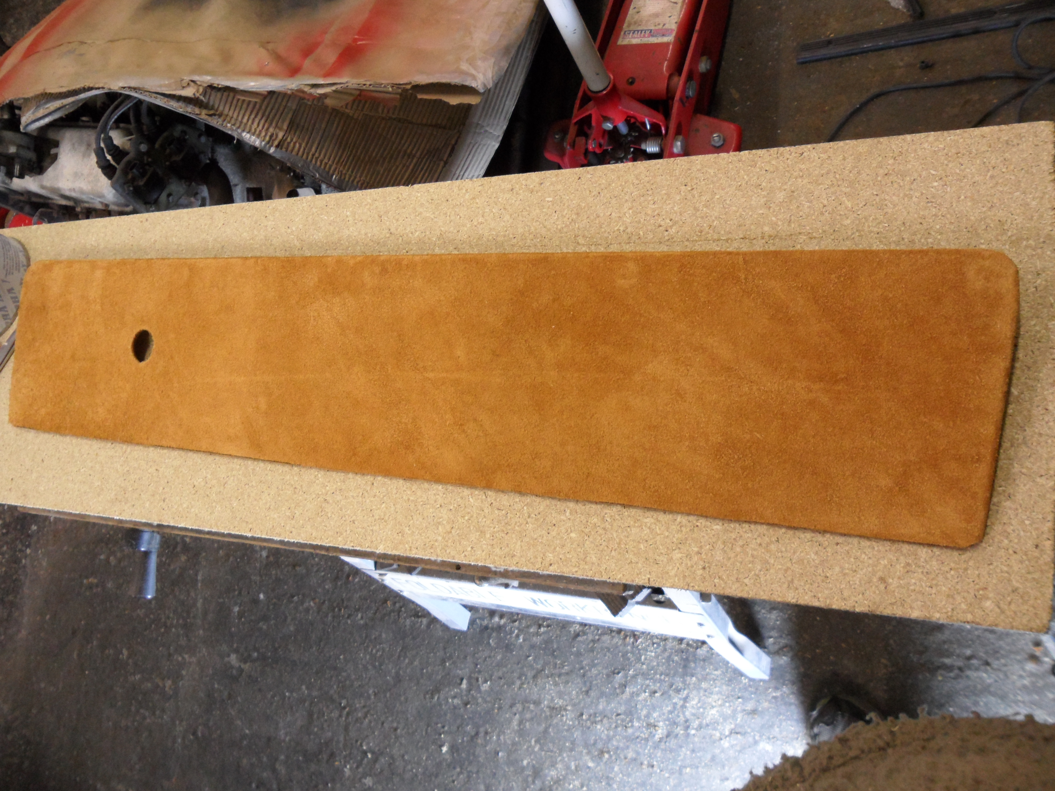

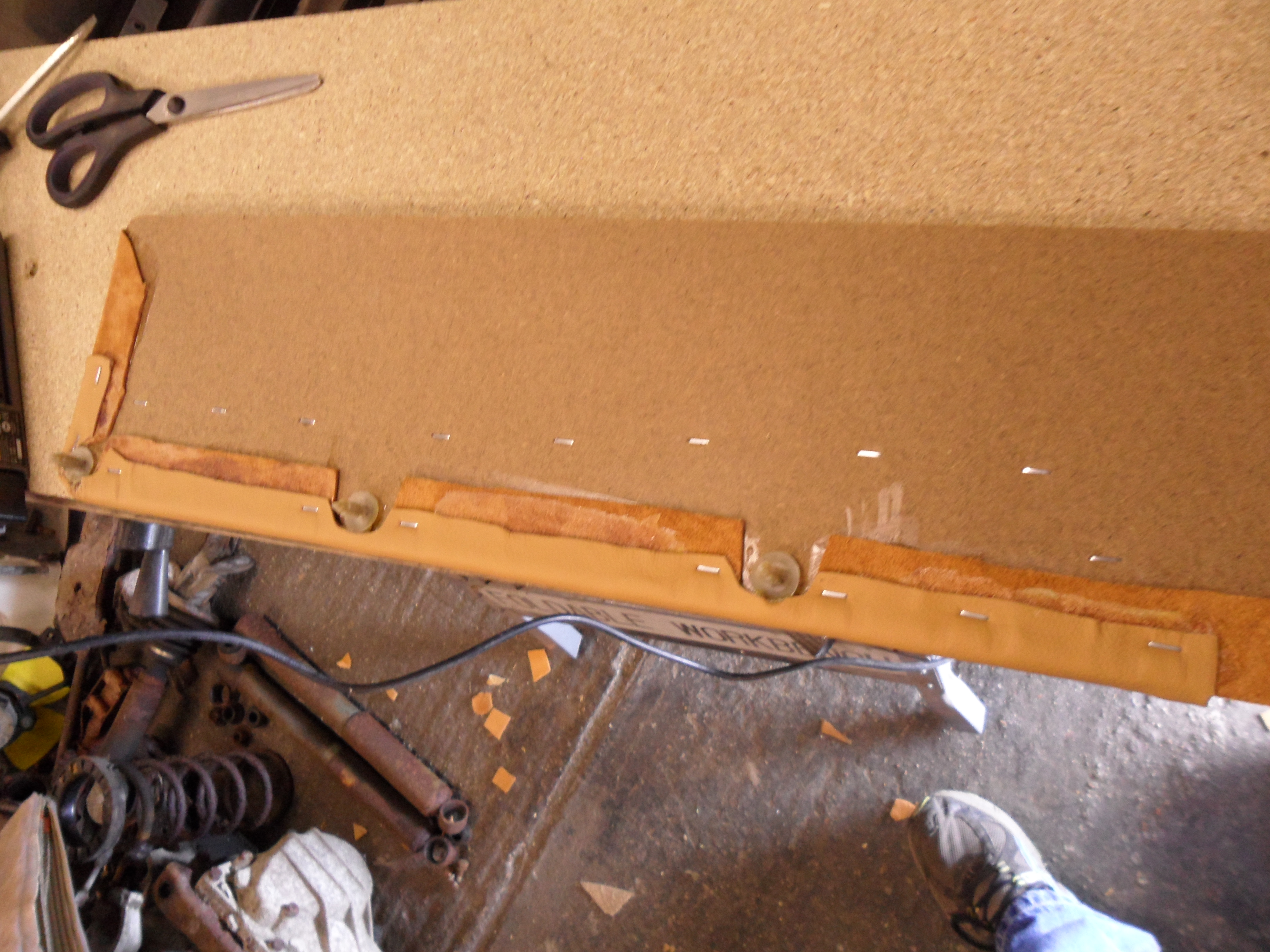

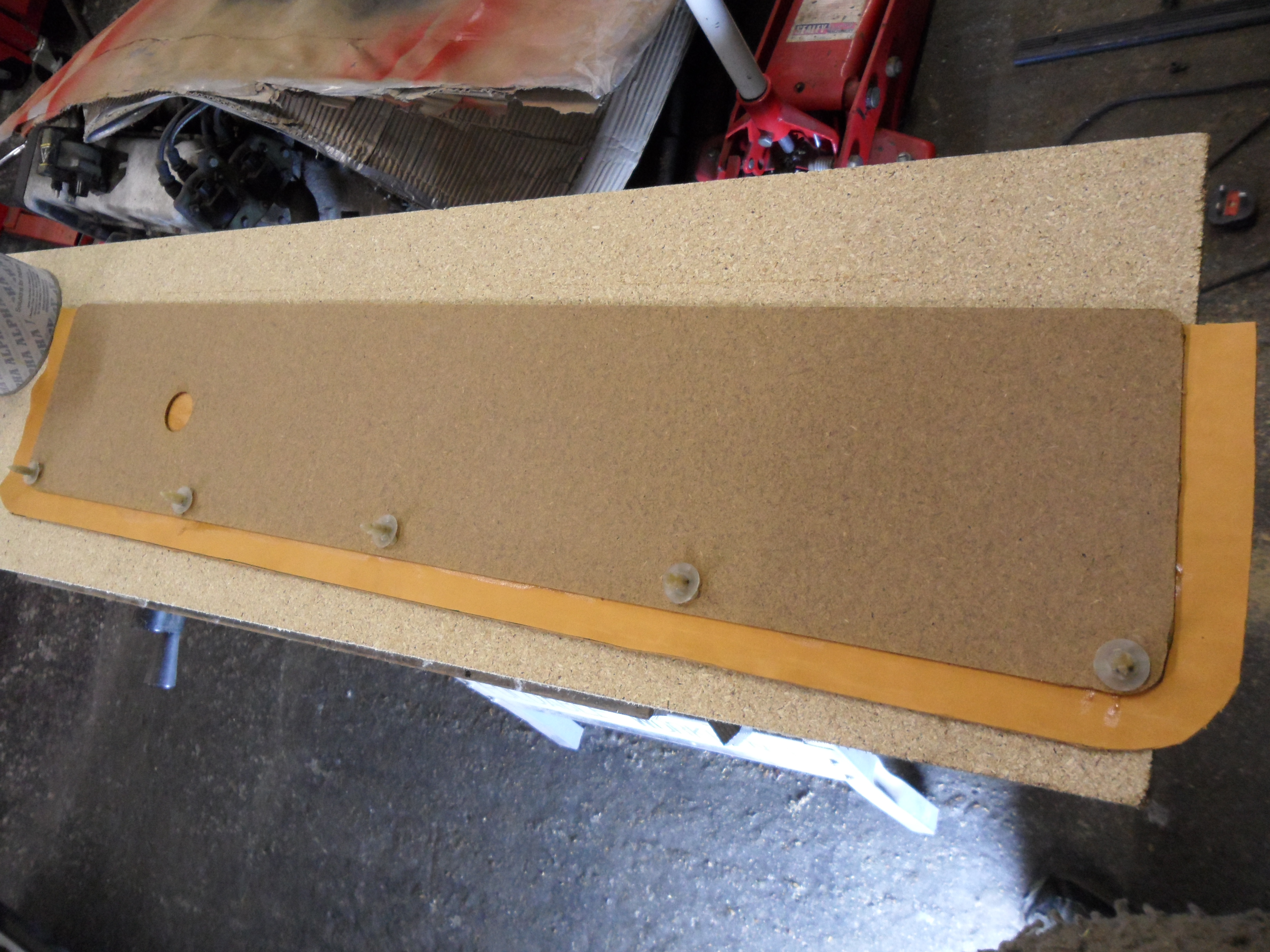

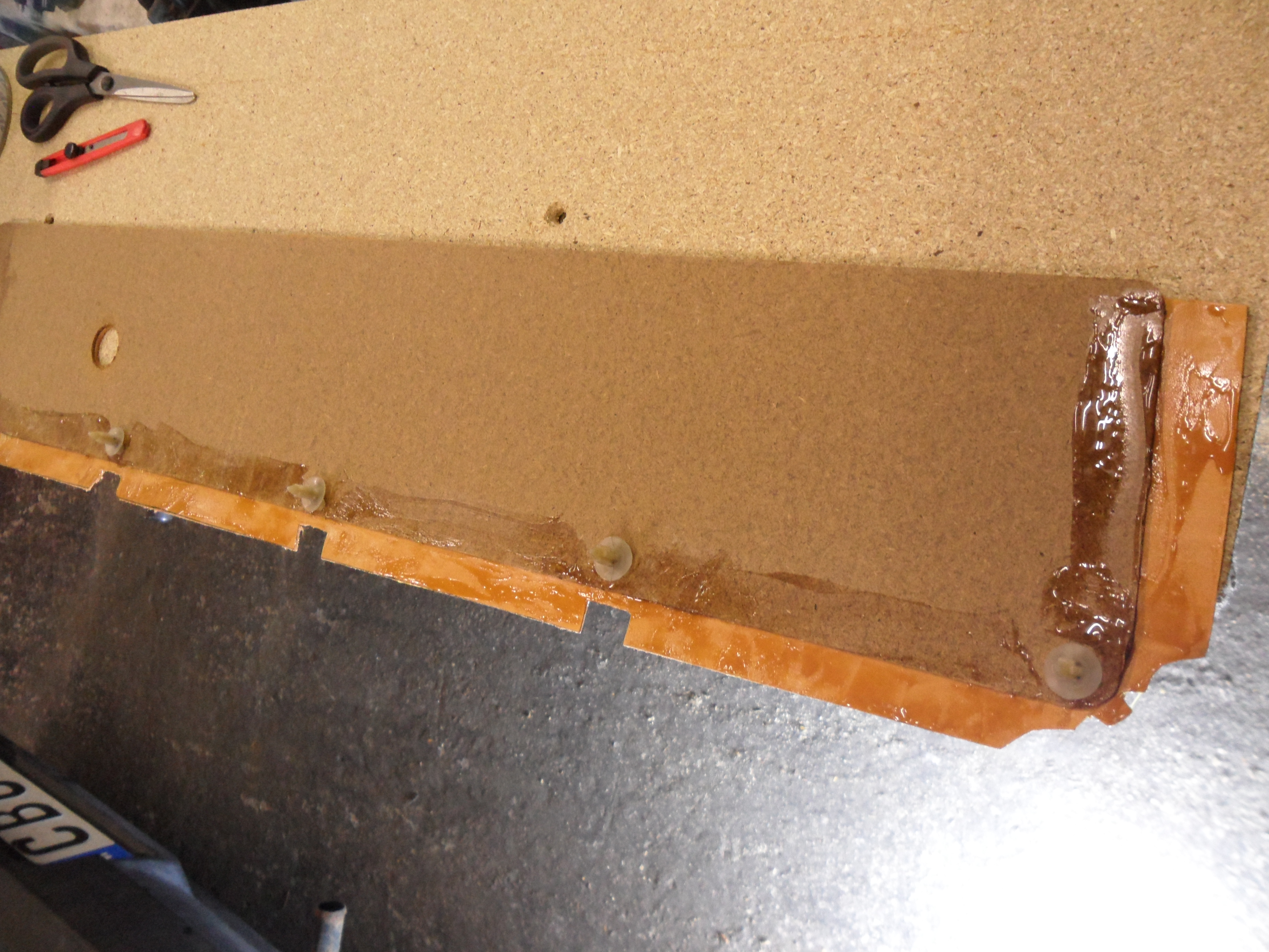

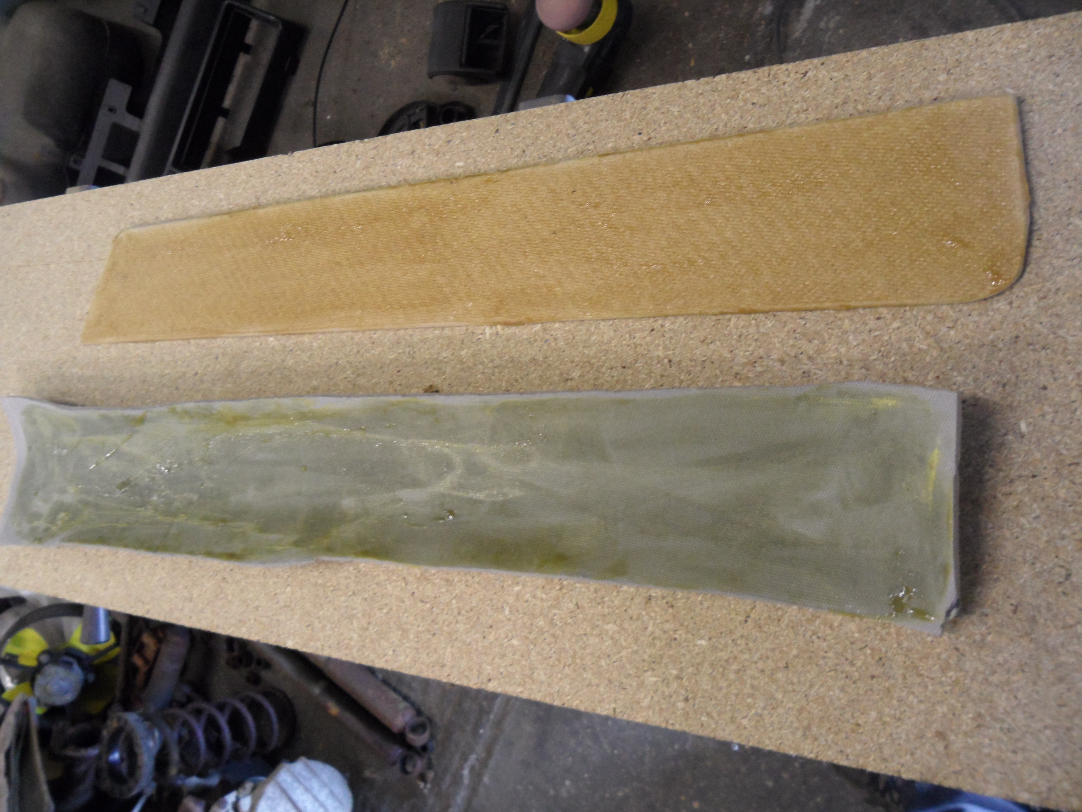

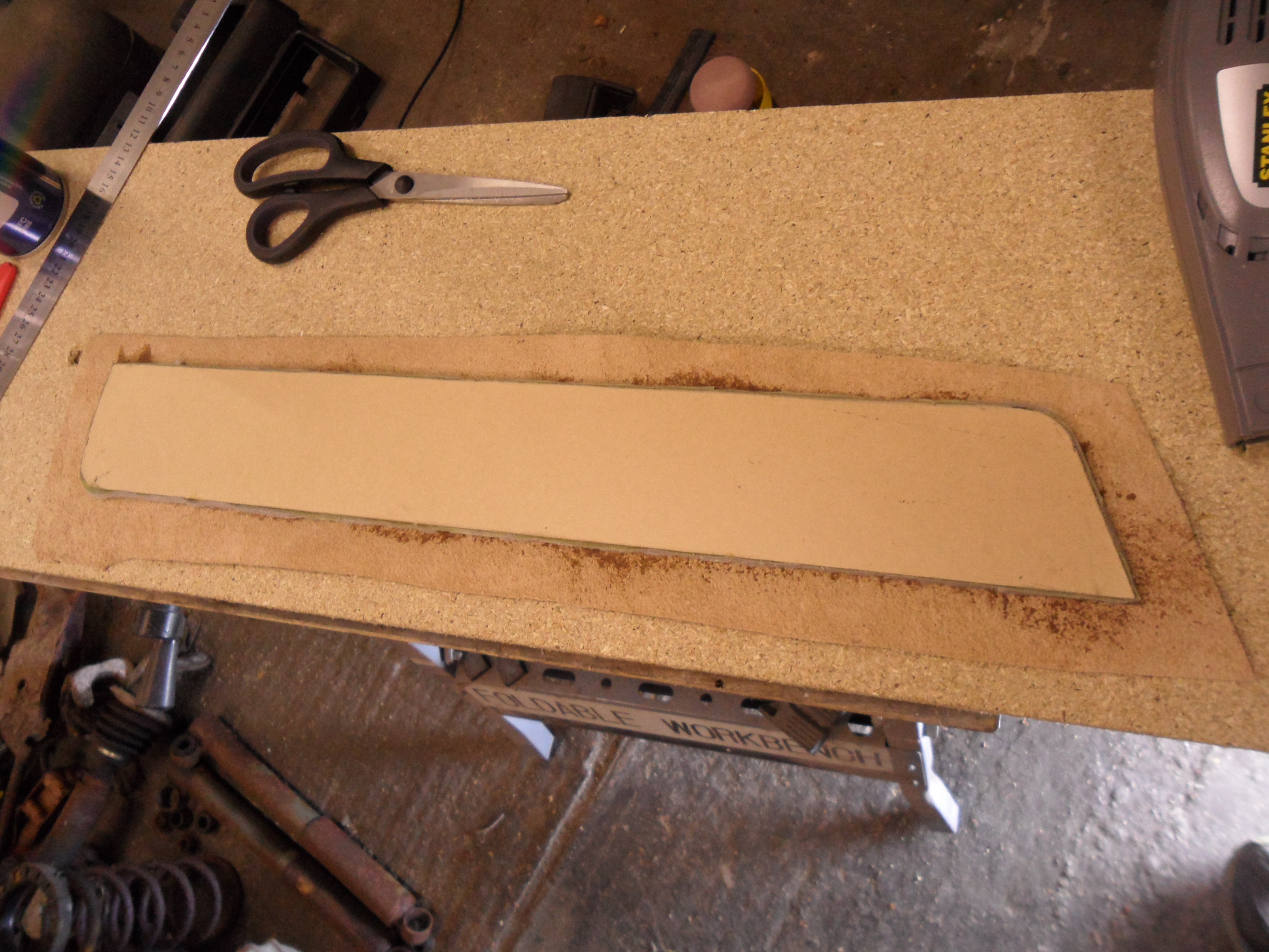

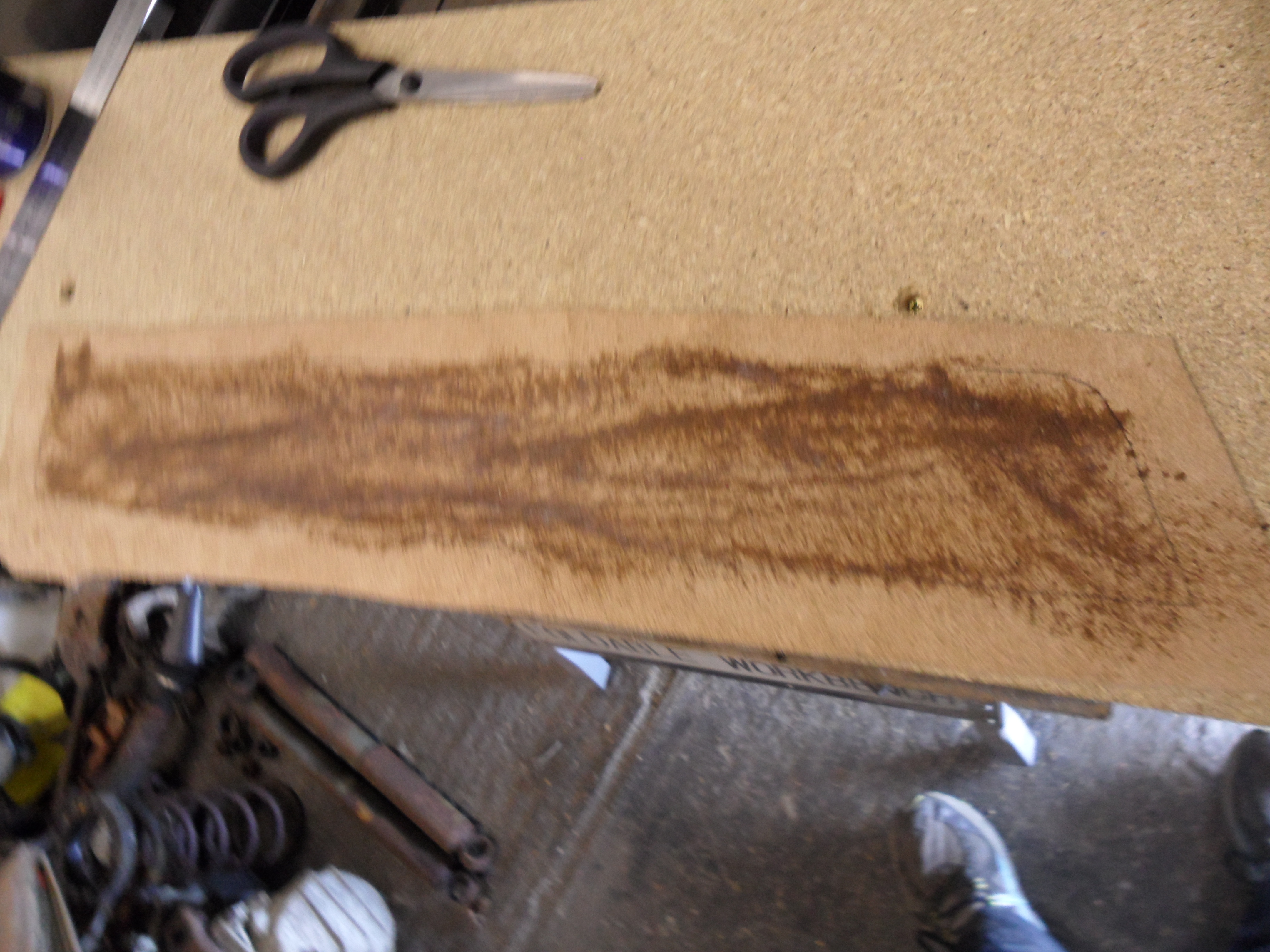

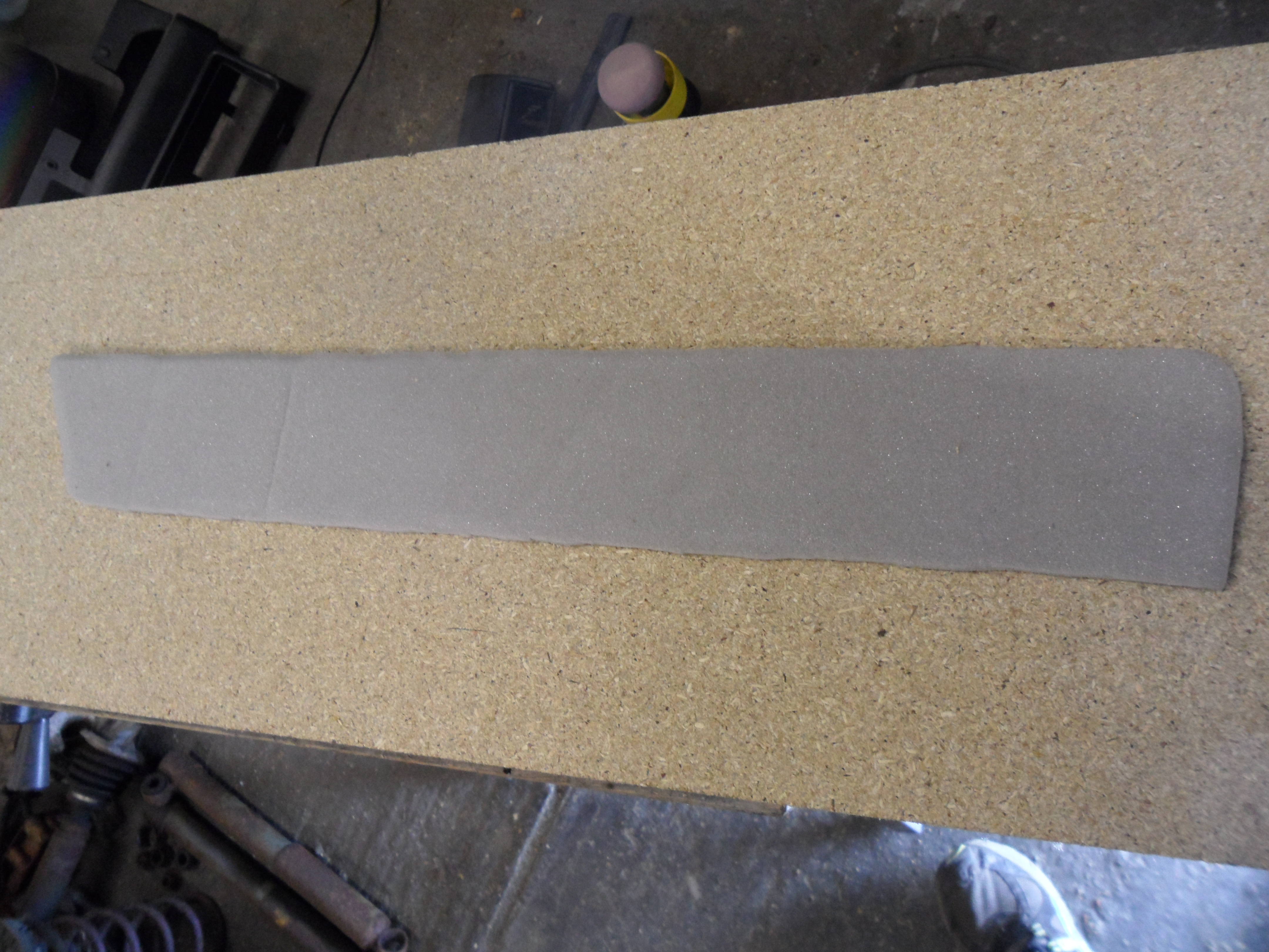

I did take a couple of hours out today to start on the door panels. I'll give you a little detail in case you fancy having a go yourself, it makes a pleasant change from working on the oily/rusty bits.

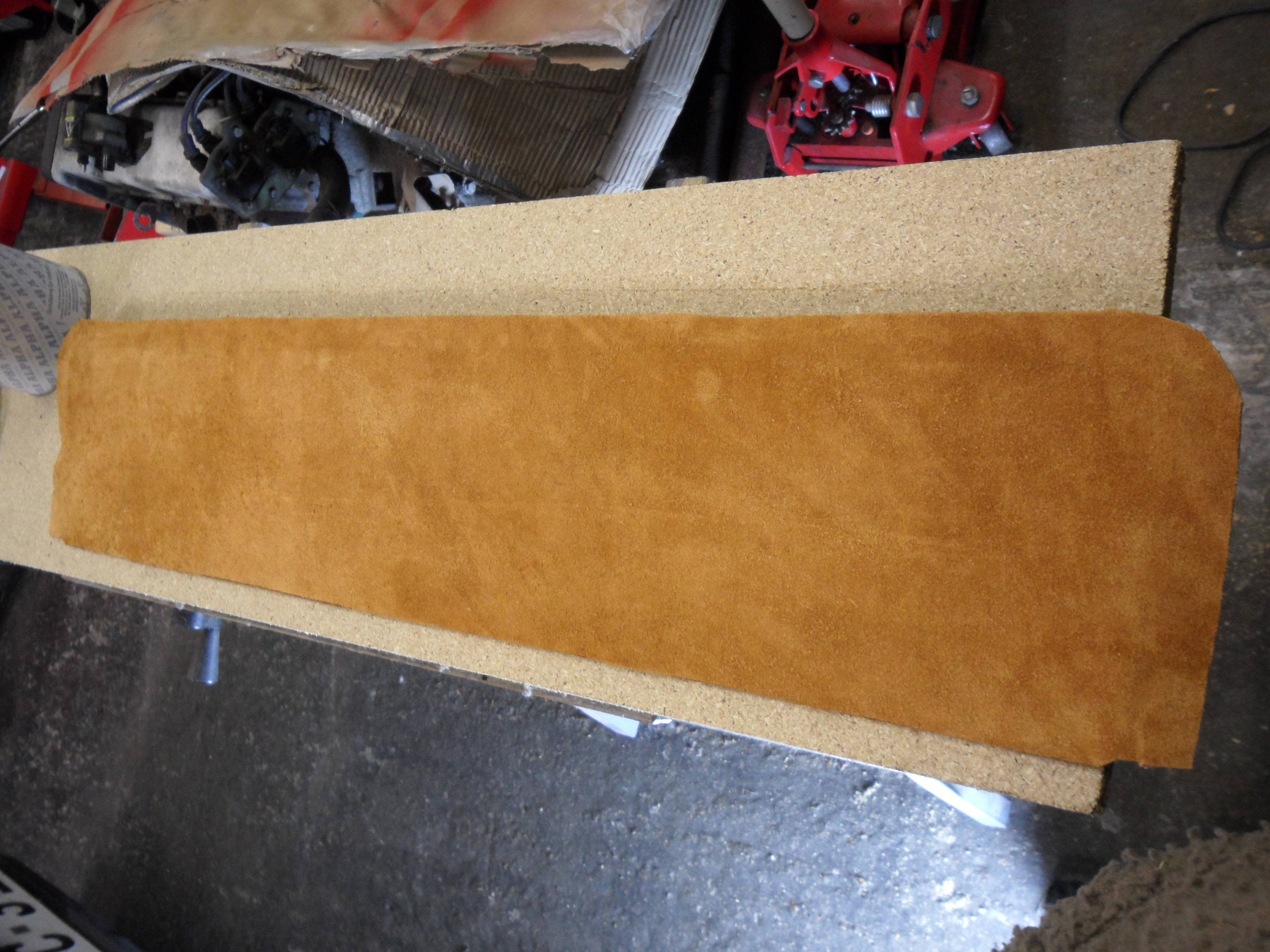

When I was trying to find some matching material I took a chance on a piece of leather from Ebay, unfortunately it was slightly orangey compared to the seats. Rather than waste it I've decided to use it on the door cards but upside down so that the suede side is showing.
I've stuck it straight to the hardboard without any padding because the area around the window winder needs to be flat. I will add another panel on top of this trimmed in leather the same colour as the seats. The design is the same as I used in the white 4x4, I would have liked to have been more adventurous this time but leather is not cheap and I hadn't used it before. The orangey leather is pretty thick and I wasn't sure it would fold around a more intricate design, but as it turned out it was quite nice to work with, ah well, next time.
