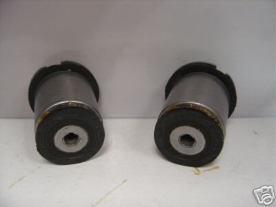

I must admit though the nut and bolt don't look up to much

Well the Stilo isn't a huge or really heavy car. It's not a truck and it's not a boat so there's no reason it should need dockyard fit tolerances and dockyard equipment to fit suspension bushes.
From the looks of it (and many thanks to the guys who did the Stilo Guide pictures) then it appears a way over the top interference fit. Someone went wrong with the design interference fit figures and now they are left with bushes that require unnecessarily ridiculous forces to fit.
Haven't done the job (and probably never will) but if I did then I think I'd investigate accurately measuring the arm internal diameter and then, rather than take the whole assembly to a machine shop to press force the new bushes in, I'd investigate going the other way and take the bushes to a machine shop and have them externally ground to be much lighter fit. Maybe grind the centre 90% section of the metal sleeve like a cotton reel too. Probably only a 30mins job and then anyone could fit them with no more than a conventional puller or even simply make their own using a bolt and sockets
The bushes can't go anywhere so I see no reason for such a heavy interference fit. Change the quality of fit to something sensible, no different than any other car and the job could be very straightforward. Then put the bushes in the freezer and they'll probably slide in easier than Paris Hilton

That’s more or less the way I tackled it but I used a carbide sanding disk in a drill and some guesswork instead of a lathe.

It all sounds horrendous but it’s really not a big deal once you get started less than four hours the pair.
P.S the last one I did I used four flat tyre levers instead of steel plate for the spacers worked much better.

I must admit thinking to myself that they are held in by the bracket so why the tight fit. I will certainly look at carbide sading disc route as i also think its a bit over board to use a huge press to push them im.
Completely over the top, the only reason I can think they do this is to get several hundred pounds for a new axle assembly which used to be the only way to go, for a long time the bushes were not even listed as a spare part.

I changed the bushes, didn't find it to difficult to do took me longer to put it all back together as i was doing it by myself, make sure that you sand out the bush holder, some light oil and a large lump hammer for the last few millimeters, did find getting the old bush out a bit of a pain just to get through the rubber then hacksaw the old bush in two places then chisel out, that bit took about 5 minutes, then using a honing tool in the drill clean out the bush holder and take off about 500 thou, this will allow the bush easier access then using some allthread with long hexagon nuts (not normal ones) screw the new bush in went ok until the last few millimeters when it wouldn't go any more, got large lump hammer and hit the jig went in ok, done this both sides, in total about 6 hours, took longer to explain to the missus to press and hold the brake pedal down when bleeding the brakes, must invest in one of those one man brake bleeding kits.(y)
