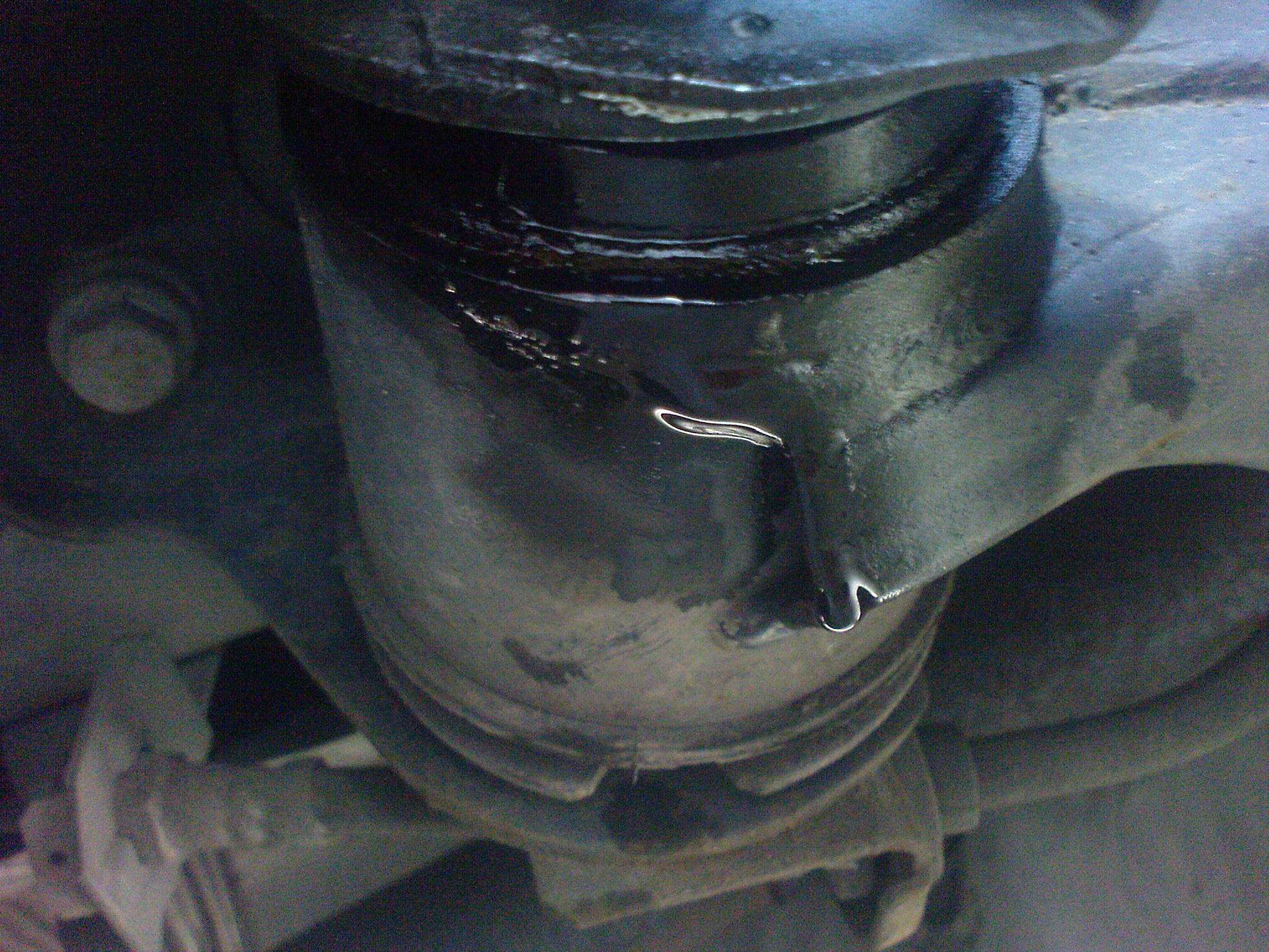

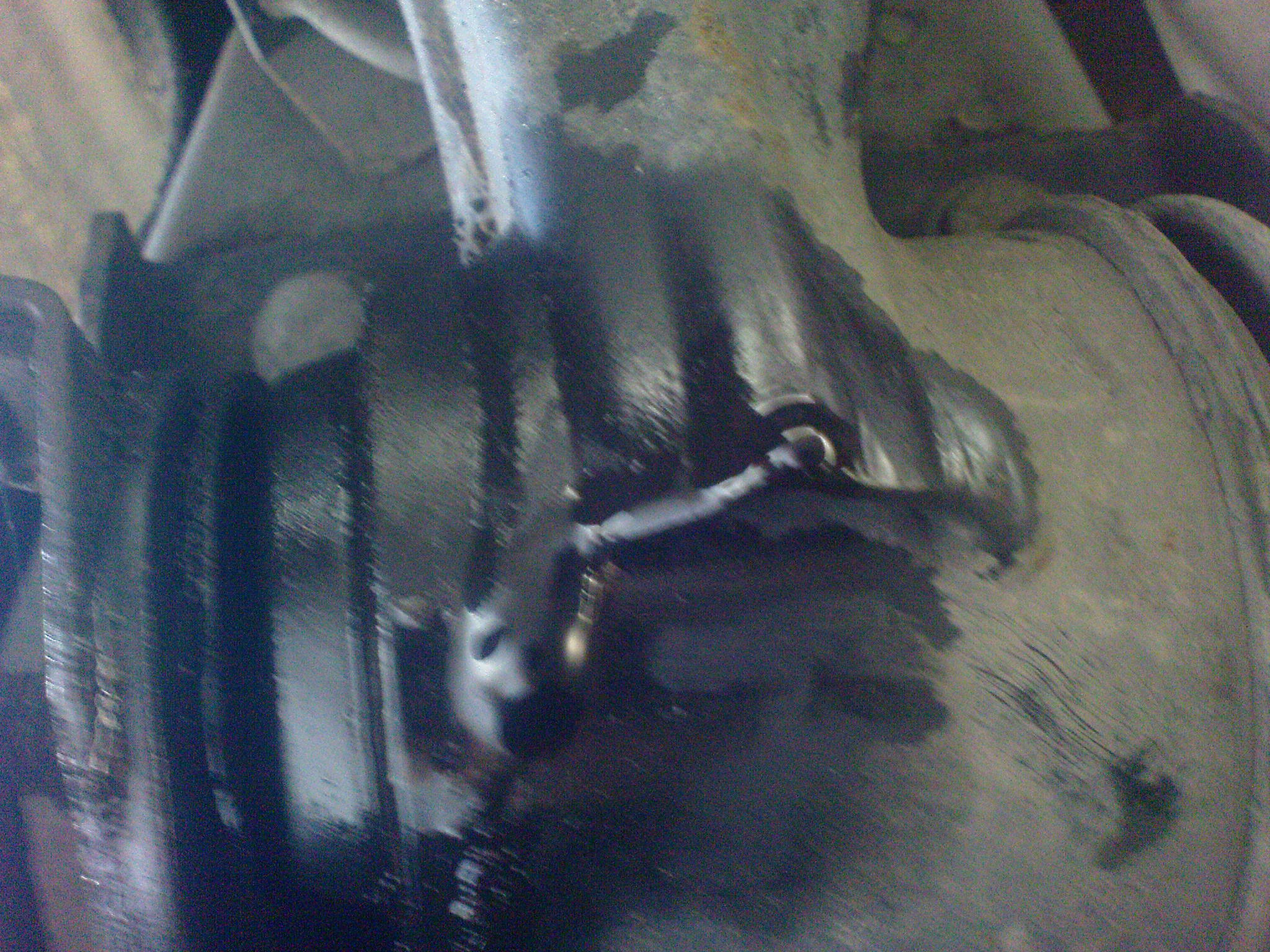

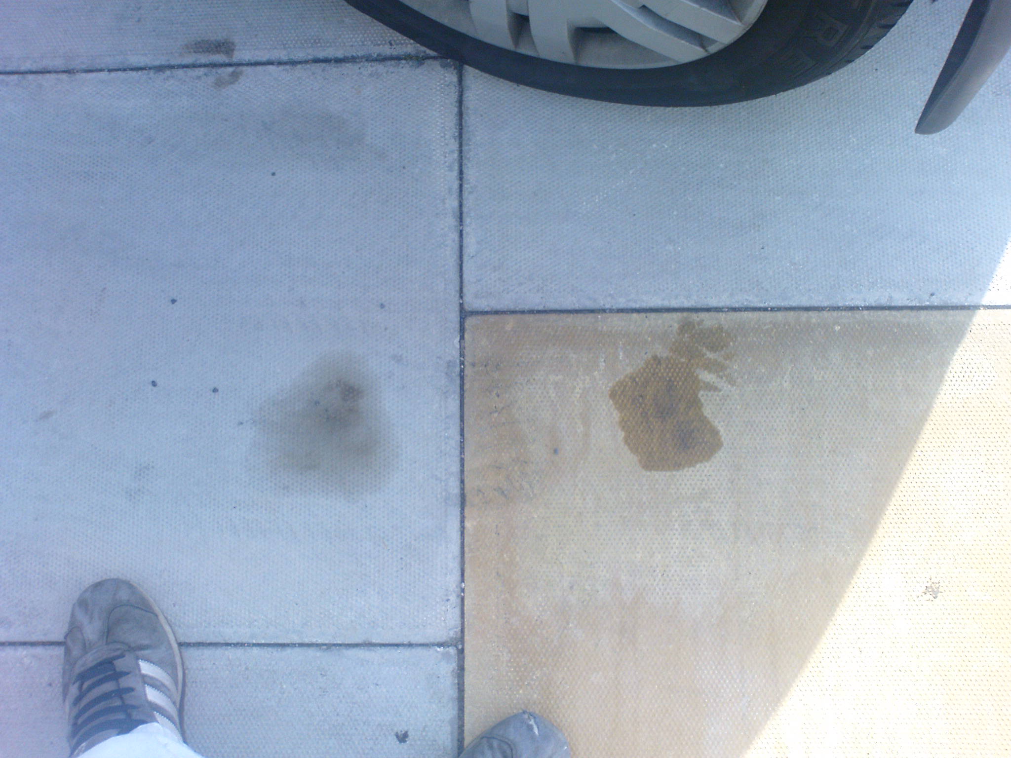

Rear suspension bush leaking something
ok this is a bit of wierd one, i thought these bushes were dry but on moving the car this morning i was greeted with a couple of puddles on the drive that looked like oil.
i checked for brake fluid pipe leaks straight away but pipes are all fine and nothing leaking as reservoir still at same level as 3 weeks ago. I noticed all this fluid had also been splashing onto the tyre so there were spots on my mudflap and tail pipe, i noticed these on wed and thought i had driven through something.
behind the wheel is dry. then i noticed the bush is were the leak is - where the axel joins and pivots on the chassis. This is supposed to be dry as i understood it, and couldnt see anything else.
Took it to a local mechanic who confirmed the fluid isnt brake fluid/petrol/engine oil and it has no smell, is oily and dark brown/blacky in colour, like used engine oil. H ealso confirmed all brake lines look ok and it isnt leaking from above, just from this bush. He thinks either someone (ie fiat when last service) sprayed a lubricant in it and with the heat thats come about in the last two days has made it thinner or as a long shot i have run over something, but it drips too much for that once wiped down. whatever it was he couldnt see anything wrong and didnt class it as dangerous, went to another garage who said the same so ran to a fiat dealer who had a look and again confirmed all the above and his tech said it didnt taste like oil or usual fluids so suspects when serviced lube was added to the bush and its started to break down now and create this mess, and again as brake lines and fluid level ok, theres nothing else it could be as shock is too far away and thats not leaking. Going to see what happens over next few weeks but it is wierd
Posting it here incase anyone has something similar or knows what it is
here are some pics of puddles and the leak
