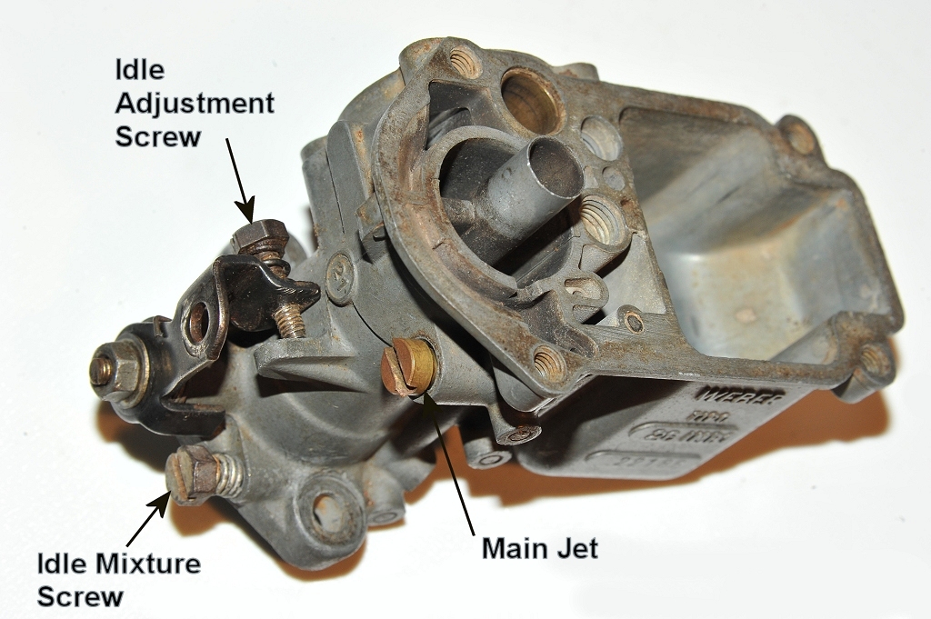

Hi Michael,
I've attached a photo of my rather grubby 26IMB with the relevant external parts marked. The mixture screw is lowermost and in my experience does little at all. The idle adjust is on the butterfly spindle and is screwed in or out to adjust the idle rpm. The main jet holder is above the other two on the main body of the carby. It should have a small circular seal that is missing in this picture.

Finally in my humble experience, carbies do not cause backfiring - they get blamed for it all the time, but are innocent bystanders.
Inlet backfiring happens when an inlet valve is partially open as the plug fires. Exhaust backfiring happens when an exhaust valve is partially open. To my mind inlet backfiring is more dangerous as it is more likely to lead to an engine fire.
As previously discussed, backfiring is either a timing problem or a valve problem or both. Ignition timing mis-set, valve clearances incorrect, burned valves, busted valve springs etc. all will cause various degrees of backfiring as well as rough running.

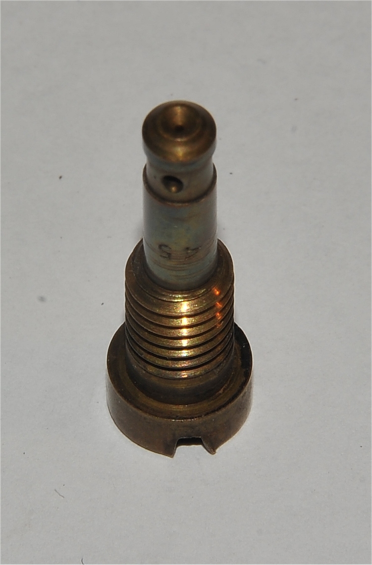

The number on the side of the jet (any jet) is the fuel orifice diameter in mm - or it is at least for European carbies. So your idle jet has a 0.45mm hole for the fuel to pass through and this is the small hole in the end. The side holes are for air entrainment.
Any of these jets should be only cleaned with a suitable solvent (petrol is good) and blown clean with dry air. They should not be cleaned (probed) with wire etc.
I've just looked at the schematic again and I think it has the main and idle jet labels are transposed. My photo should have the jet labelled as the idle jet. So what you loosened was the idle jet - either way, it should be screwed in snugly. Sorry about the error.
