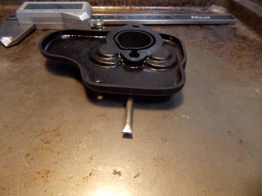

Okay guys, the idle is good. I made a pipe out of Sterling Silver (why? because I had it laying around, I dabble in Silversmithing) squashed the end so there was but a little hole and voila as they say, smooth idle at around 850 rpm. (I will post a photo later)

I attached a photo of the pipe that I made for the bakelite base.

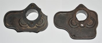

Hi Michael,
Very nice work, how are you with jewelry :D
I've attached a couple of photos of my original broken bakelite insulator (left) and one from a later model Fiat 126 on the right that used the bigger 28IMB carburettor.
The original does not have the fuel drainage channel nor the associated drain hole that gave you so much grief. I guess the fuel just leaked out on to the (broken) bakelite tray and dripped through the hole or evaporated off in the heat of the engine bay. Probably not particularly safe.
Very early on I ditched the IMB and installed a better carby, so I've not experienced the leaning out issues that you described.

Do you know the function of this tube? is there a specific size hole, material, length? Is there a reason for me to go out looking for a new bakelite bit or do you think my 'tube' will do.

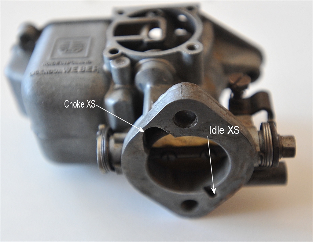

Hi Michael,
As far as I can see, the tube is to drain excess fuel from the groove at the base of the carby. Fuel may accumulate there from either the mixture screw or choke (starting) apparatus. I've attached a not very good photo of the underside of a 28IMB showing where this may happen.
The tube needs to be long enough with a small enough hole to prevent retrograde flow of air yet allow fuel to drip out. Yours looks fine and having been made of sterling silver is probably worth more than the rest of the car :) Only kidding. Reminds me of all of those Lada jokes - how do you double the value of your Lada? Fill the fuel tank etc. etc.
