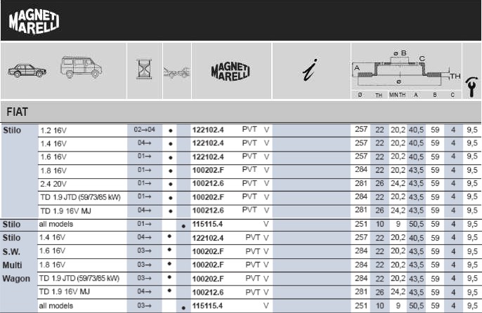

Technical are these discs the same?

ok update, as per CRN performance's very good customer service, i recieved this morning at 8am the CORRECT replacement discs (y)
just waiting for their phone call now to arrange for the pickup of the old discs and sort out a settlement sum for the garage labour that i paid.
