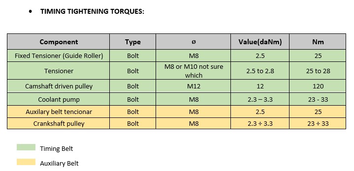

Hey everyone,
The time for a timing belt change is approaching and based on what i found online i made a chart with all the tightening torques i need for all the components of the timing kit for the 1.9jtd8v(115hp), it including the fixed guide roller, tensioner and water pump. A value for the camshaft drive pulley is also displayed because of that hole "remove the pulley to install the water pump" endeavor.
You can see it in the photo attached bellow. I just wanted to ask if all of these values are correct and/or anyone of you have any additional information on these torque values.
Thank you in advance,
Rui.
