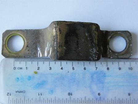

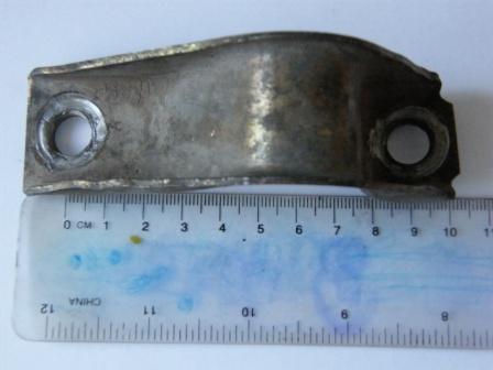

Do do you have an ARB bracket at hand to check the screw centres?

Hey peat here ya go..I think they are ninty plus they are curved and angled..
Thanks for that RaineUK. Good photo.
Your post has reminded me that the Multi bracket is shaped such that the bush sits higher than the cross-member. It is also has it's centre off-set.
FIAT has made it nigh impossible to replicate the bracket with any ease, but I cant see that the angle will matter but the off-set makes it difficult to use the Powerflex bracket without adding an extention to one end to get the off-set correct. Although I think that may not be necessary, it will just mean that the drop links are not working in the absolute vertical. What do you think?
If you can email me the photos of the brackets and bush I will get onto Powerflex and see if it's possible to accommodate their bracket for the Multi. Peat at usa dot com
