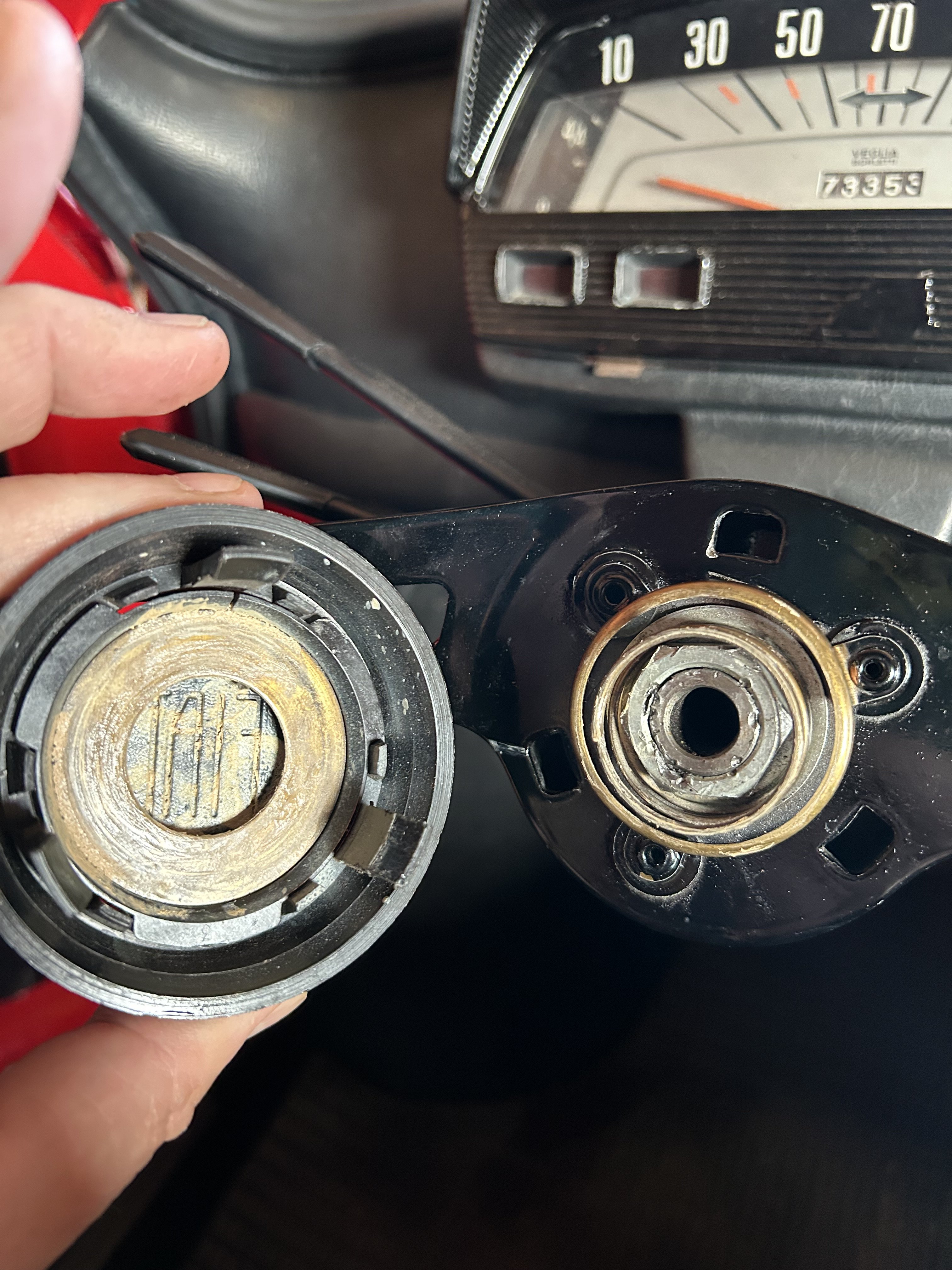

I’ve disconnected the horn now and that confirms or seems to that it is where the current drain is. The earth on the horn itself seems secure. I’m therefore trying to work out what to undo to find the other earth connection at the steering column end.
That’d be great but don’t feel obliged.. I have located, on the forum I think, an idiot’s guide to the idle and mixture screws, but many decades have passed since I played with points, and I see my feeler gauges are now a block of solid rust!
I've a feeling that the horn ring at the wheel grounds directly to the steering wheel itself. You ould find that by removing the horn button and surround itself. But it may simply be that an intenal part of the horn, or even part of the terminals on the horn are shorting slightly. somewhere.
Do you still have the permanent warning light for the indicators?
Yes, in short. Commentary I can find does suggest something of the sort, but at the moment I can’t really interpret it. Under the button/surround is like this, and then I can see there’s a black & yellow earth wire heading away down the column but not sure where it starts and finishes. Same colour earth at the horn so maybe that’s one end..
