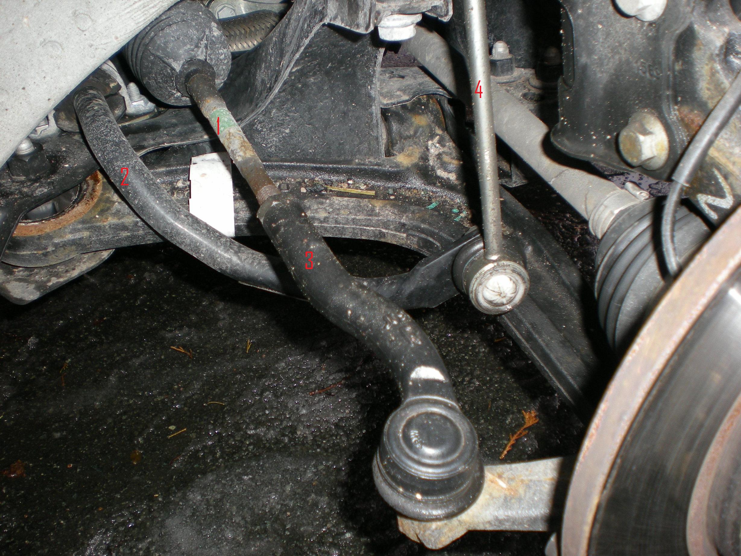

Anyway I've attached a picture which shows the various suspension components on my 500's suspension and steering. The panda will be more or less the same. I've labelled the various components.
1 Rack end
2 Anti-Roll bar
3 Tie rod end
4 Droplink
