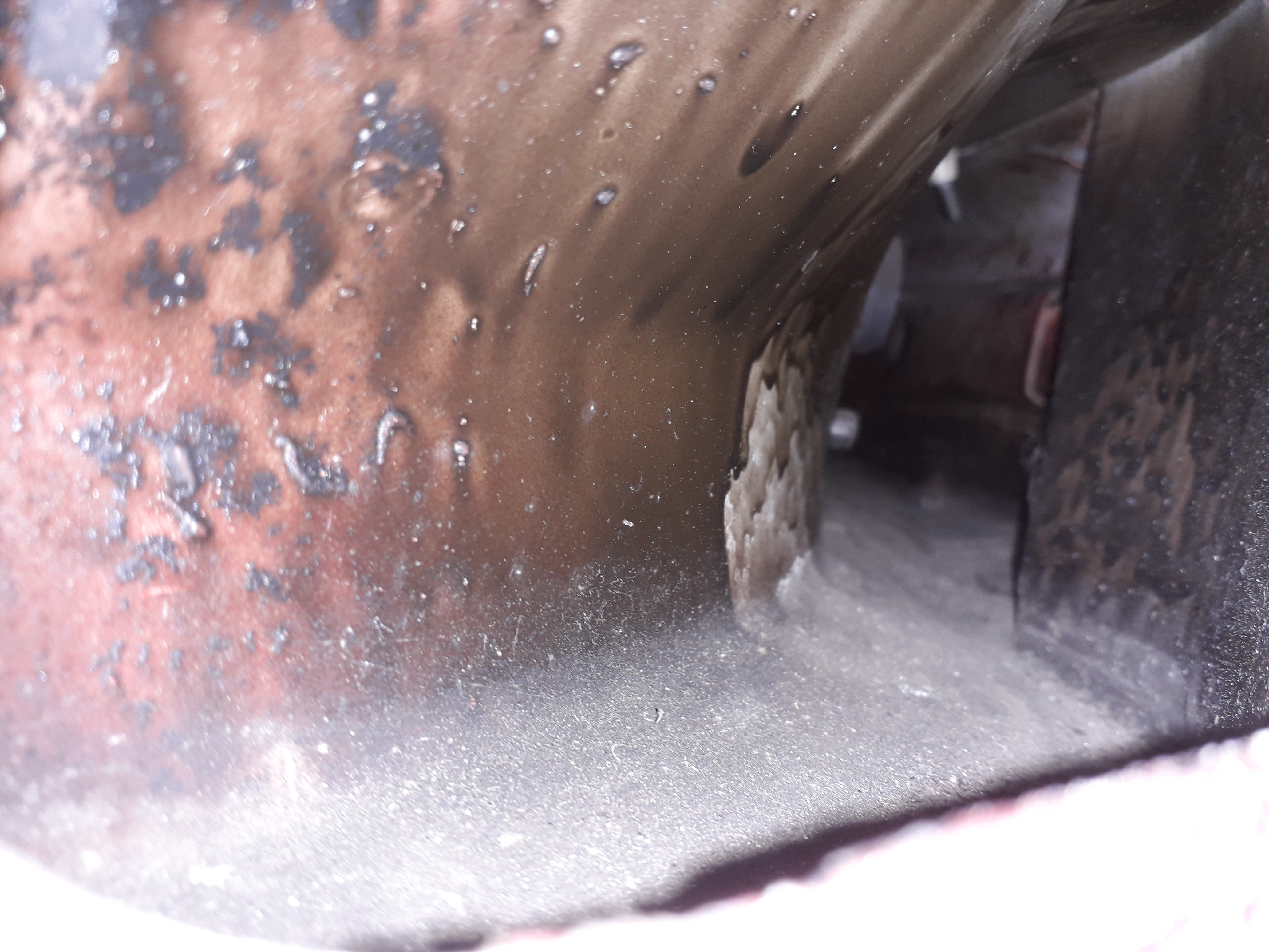

I think the problem with the subframes, looking most recently at my front one and back in the day on the TD (where the rear bump stops rusted out) is that they rust from the inside out. If you can jet out the cavities and fill them with wax that is probably more useful for longevity than an external treatment. As you say epoxy mastic can be used to patch up get the metal as clean as possible. PS I have been in the habit of sometimes putting a rust convertor on under the Epoxy Mastic with a light sand afterwards it doesn't seem to affect adhesion, the product info. on line suggests this is ok.

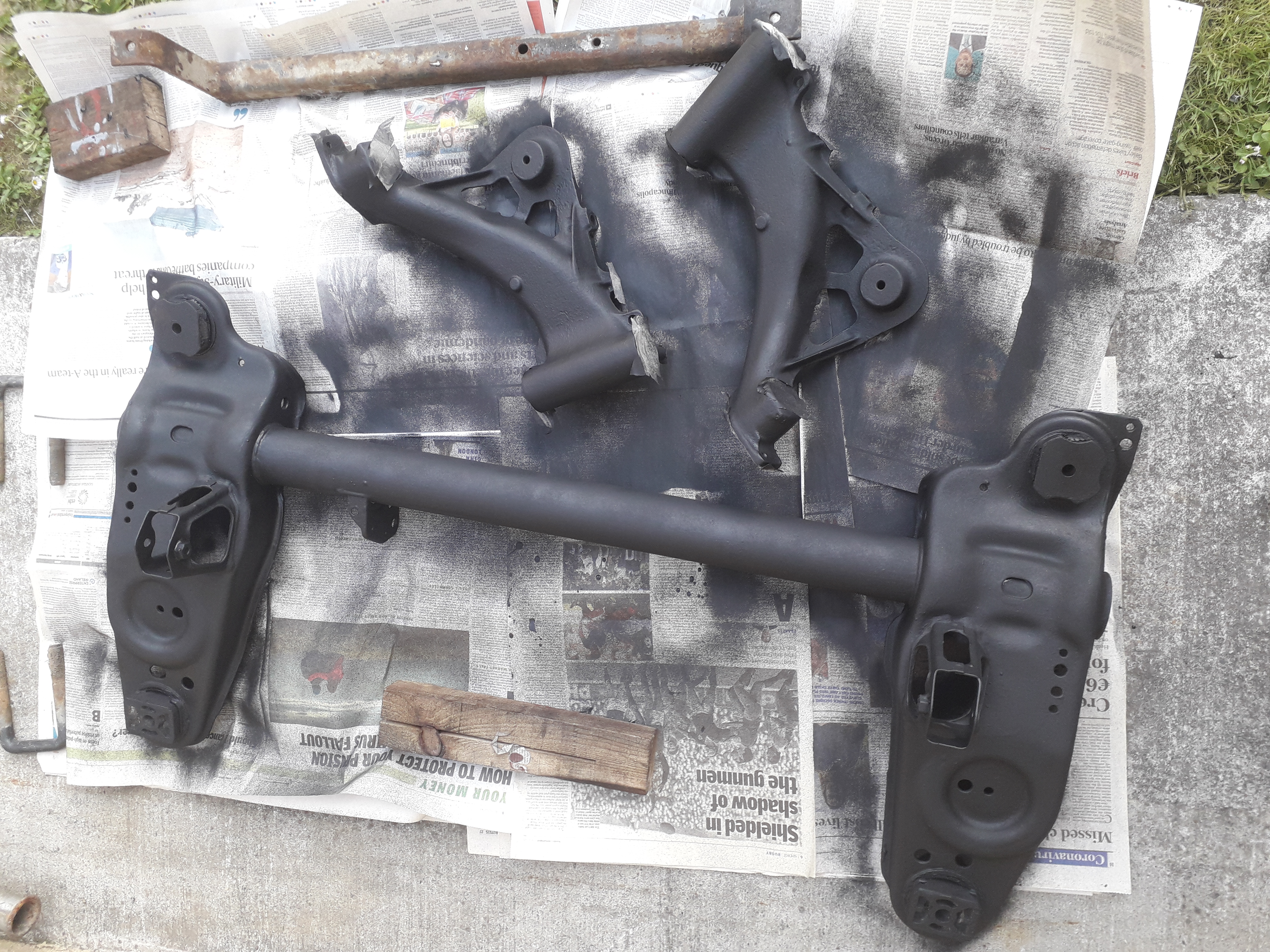

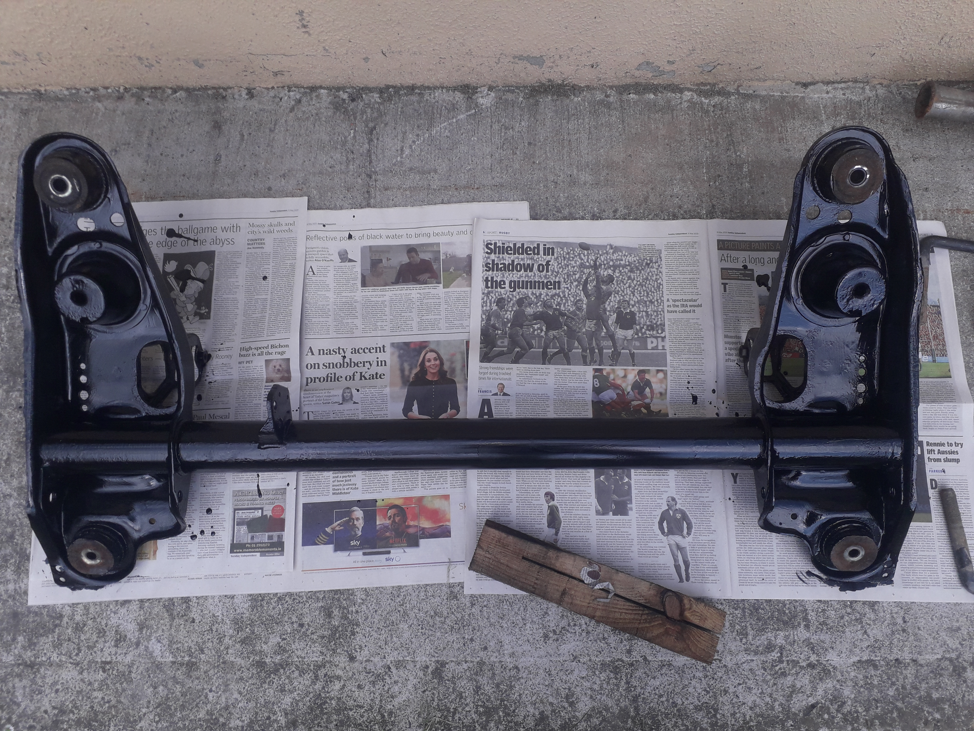

Prepared the rear subframe for epoxy mastic paint today and have the underside of it coated. Will coat the top side tomorrow. Will take your advice Jonti and thoroughly treat the rust trap where the bump stops go in when all is dry. At least it's in sound condition. I blew out any dried dirt with an air line. Subframe not perfect but it will do.

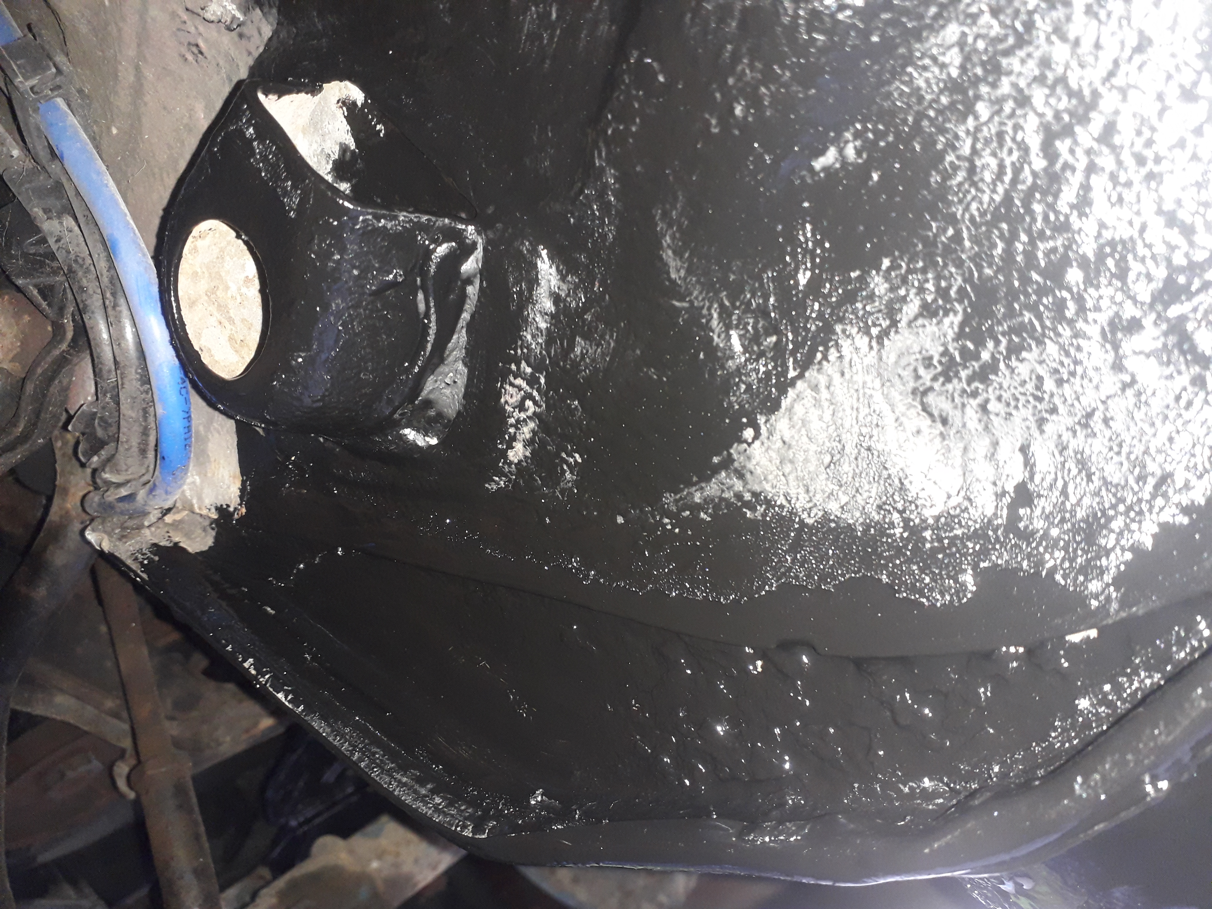

Unfortunately had to coat the nice shiny epoxy mastic with stone chip for protection but still a vast improvement.

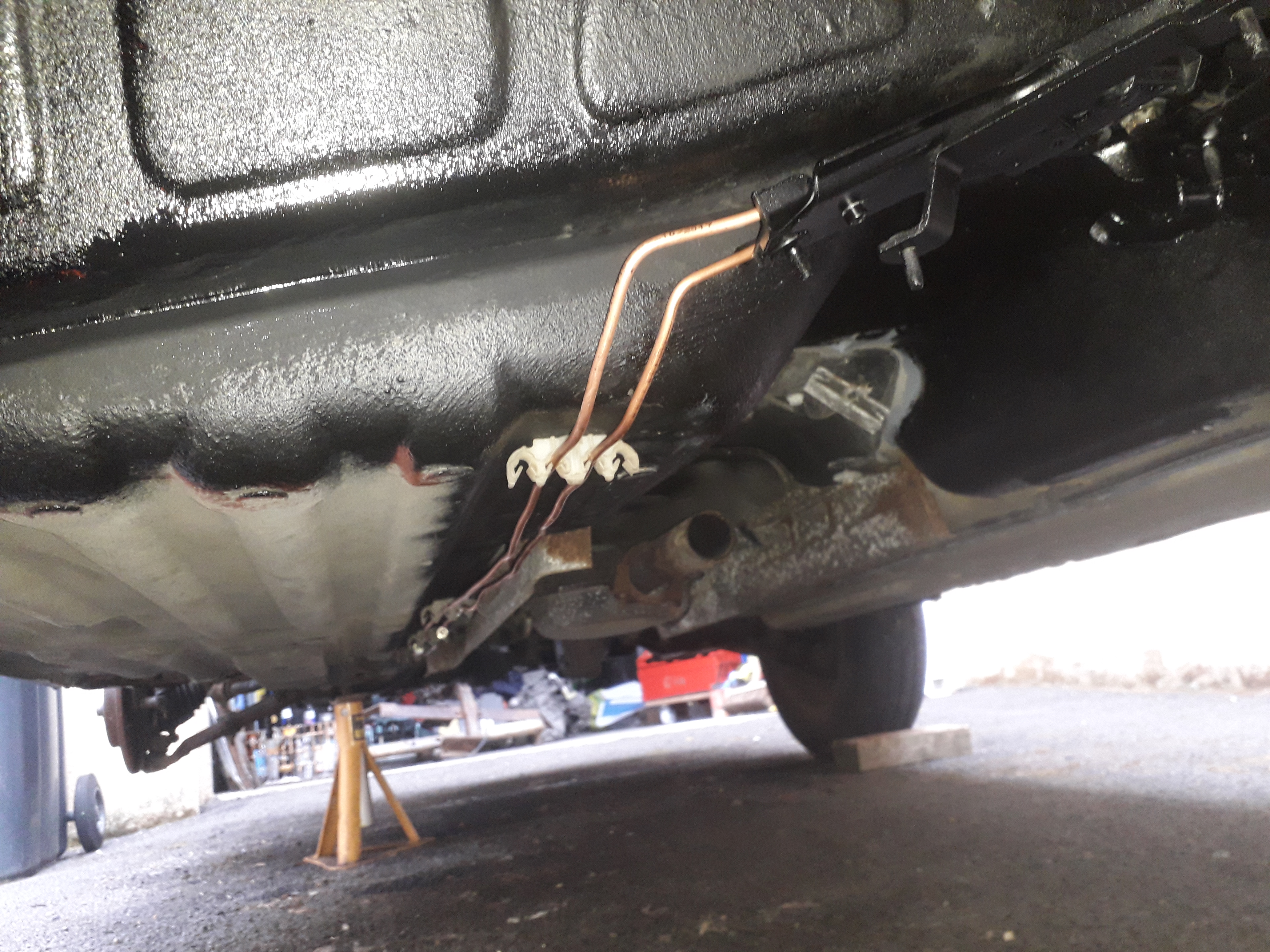

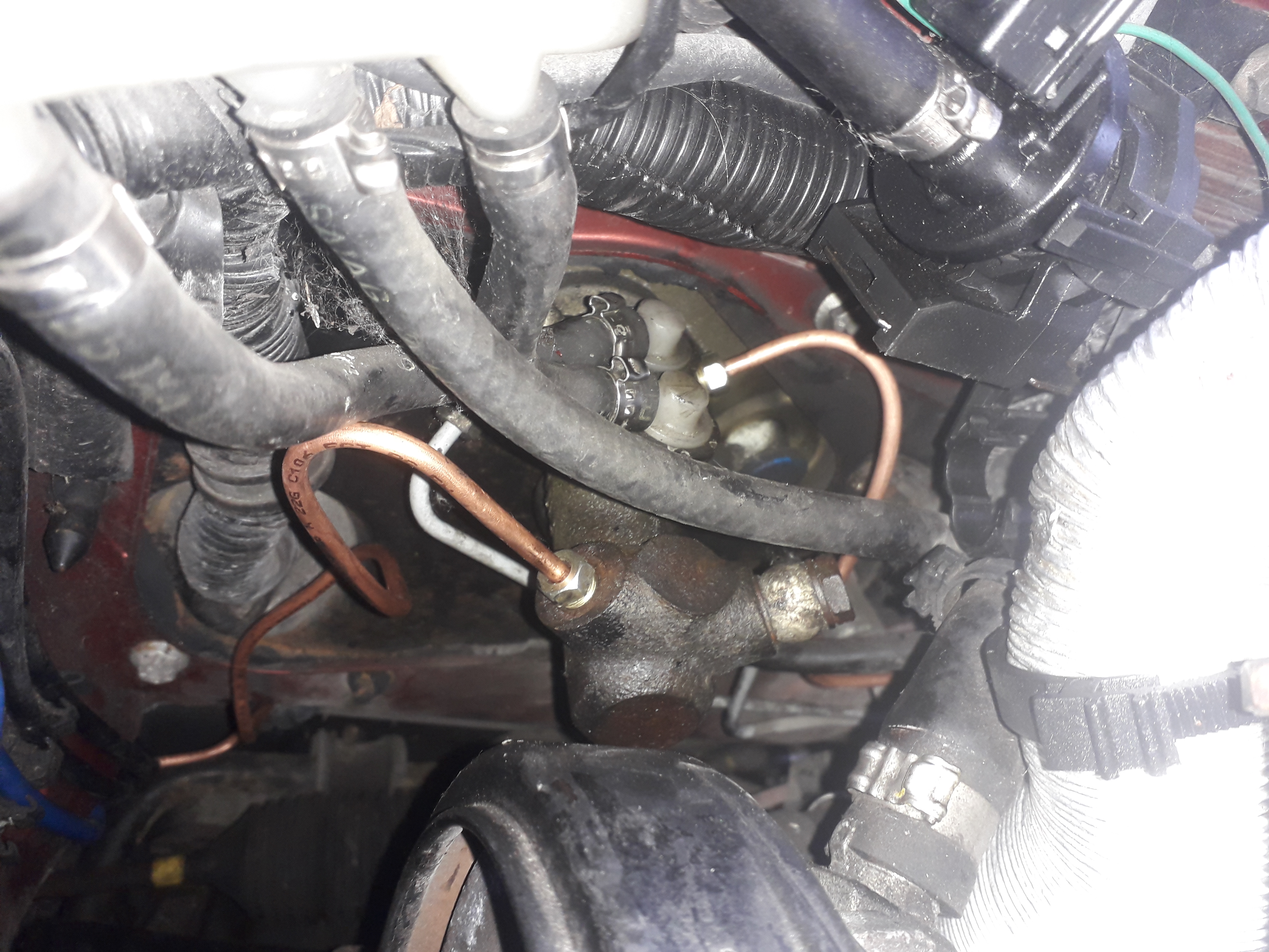

Have made up and fitted copper brake lines from front to rear along with new lines out to each front caliper. Certainly not perfect and I wasted loads of pipe trying to get bends etc. correct. Slowly getting there.

There's no hurrying a Tipo. It will be only ready when it's ready which will be later than the longest possible estimate. Good work on the subframe, that's going to last a while and you have eliminated the worry of it silently rotting out. I had forgotton the rear subframe is a one piece plate unlike the front.

Having needed to renew 3 brake lines in time for my MOT retest which i'll update on in due course, I've a new appreciation for this post which I had in mind as the inaccessible torture went on until 4 in the morning. Its a tricky job getting the tasks in the right order, so easy to forget a fitting or mess up. Well done. Are you going all the way to the load sensor?
