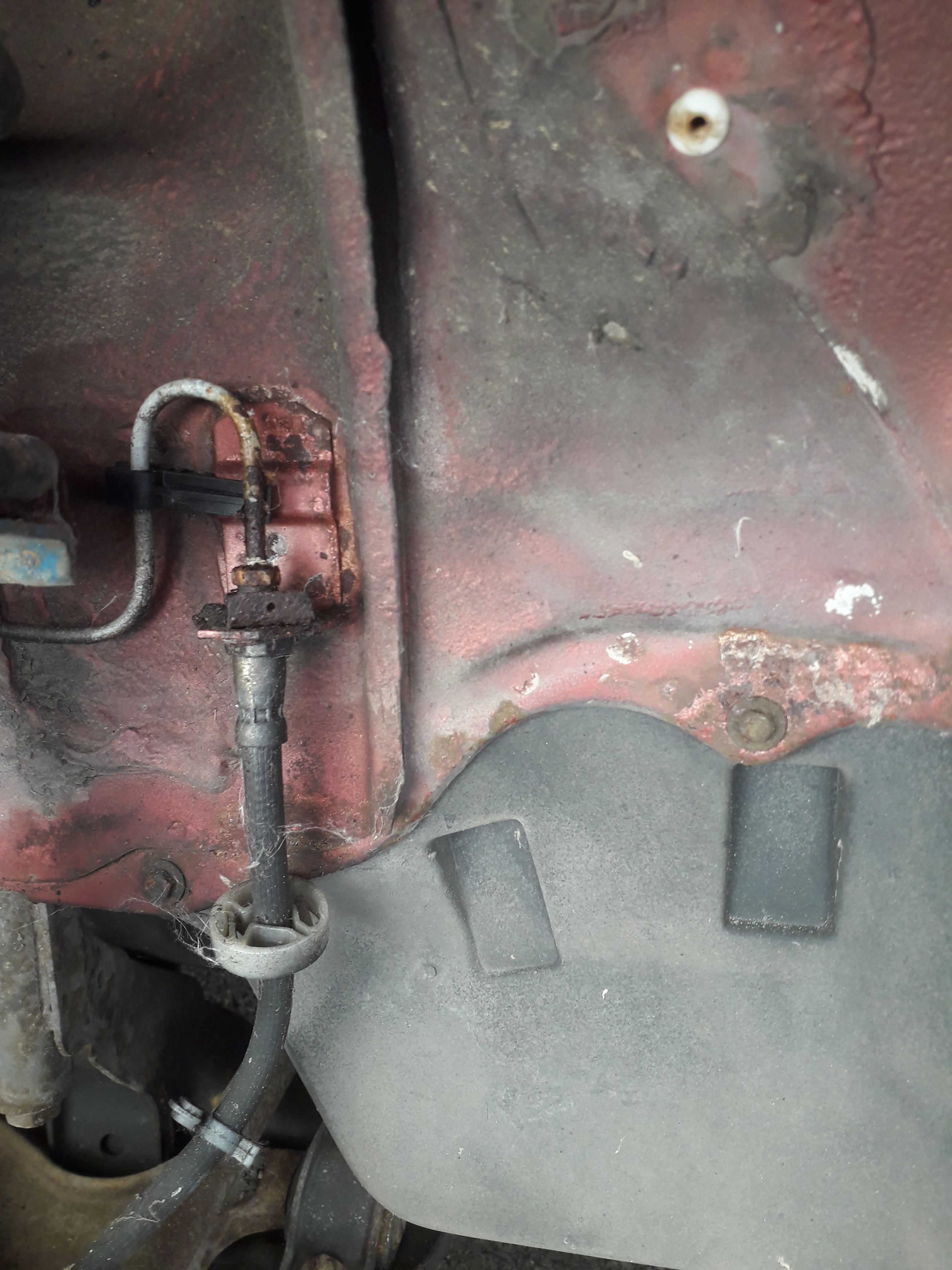

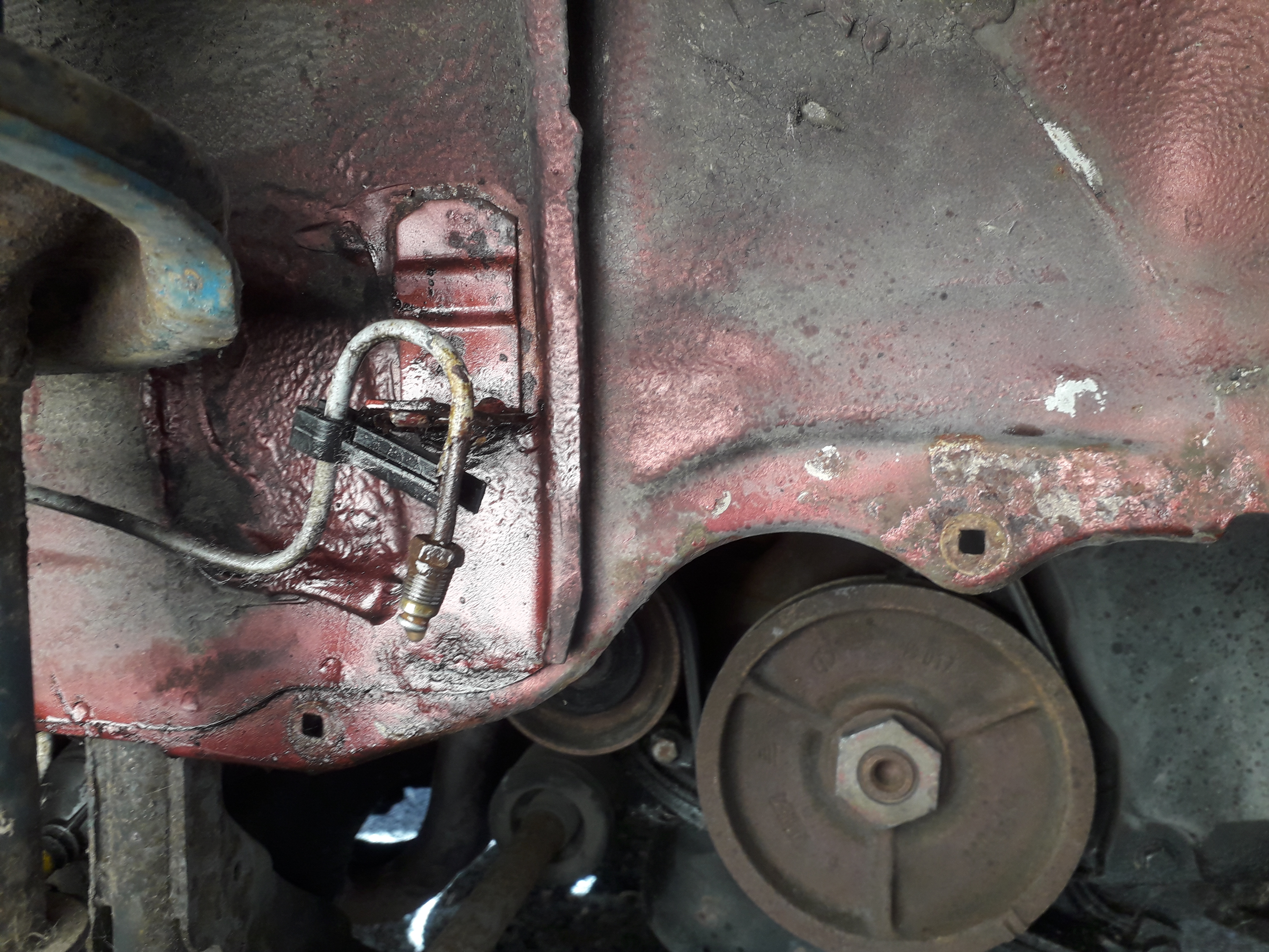

Due to a budget crisis I am held up at the rear end of the Tipo so decided to strip out the driver side front plastic wheel arch liner and tackle a crusty brake line.. it looks spotless in there barring some surface rust.. the car might look like a shed but is definitely solid in the right places! I also put some underseal on the rear underside. Burnt my budget for the moment on parts.. so close as all I need now are the 4 rear subframe bushes and to get the subframe either sandblasted and paint it myself with epoxy mastic chassis paint or see if I can save up and get it powder coated.. thought about tackling it with the wire brush in the grinder but looks tedious. amazing how every part is worn out though certainly at the rear. Rear brakes, subframe bushes, brake pressure regulator, brake lines, exhaust all shot! Aiming to at least have the car back on 4 wheels by the autumn. Really need to start the engine as it now hasn't run in 3 years.. where did those years go! Also seriously tempted if budget allows in the autumn just to get the rust repairs at the rear end farmed out as I just haven't the time or patience for it.. also getting grief from neighbours re noise of the grinder so having to tread carefully.

STEPHEN, Hold on until you visit me, might have new brake hoses and brake lines for your car, no need for you to spend any more money as I most likely have everything you need will show and advice you on the bodywork also, we will go through my stock and you can have the extra bits, at no extra cost

Certainly is in good nick that. Many a Tipo and Alfa can develop a complicated hole there. There are some access holes on the bottom and other side of that inner wing you could spray some wax in there to keep it like that. I would have thought epoxy mastic would do the job for the subframe and fill it full of wax.

Unfortunately there was some very pitted steel around the jacking point but I just cleaned it off and applied epoxy mastic.. good enough! Perhaps you are right Jonti.. I might just wire brush the subframe and apply epoxy mastic. It looks good on the trailing arms (painted today). Photos to follow. It's good stuff but very messy!
