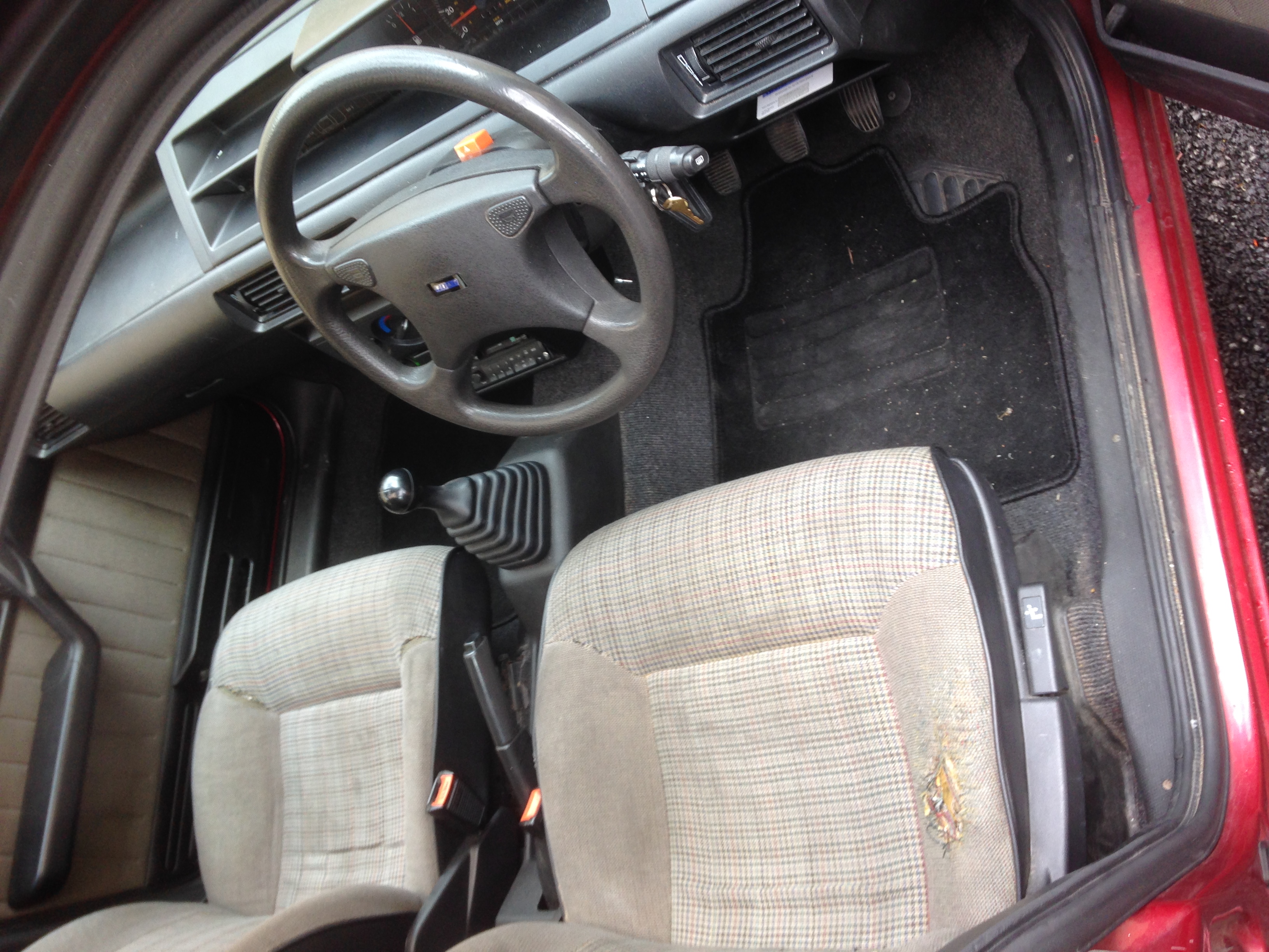

More info to follow. On closer inspection it needs a good bit of work but very solid underneath.
More pics to follow, drove nicely on the way home bar a scary incident with the oil light coming on while going around a roundabout! A few obvious issues are a leaking near rear shock and damp off rear brake back plate. Engine is obviously leaking oil somewhere and resembles a damp oil soaked rag! Has a few potential corrosion issues on the rear doors (bubbling rust). Car is very solid underneath which is great. Rust around the sunroof does not fill me with confidence but there are no leaks. I will post more pics when I get the chance. Plenty of other issues on it to keep me busy too!
I have been tipping away at the tipo doing a bit of general tidying up such as fitting a wiper motor and arm to the rear screen as it was missing, serviced the engine and changed the rear shocks. A couple of weeks ago however I went to start the tipo as normal it fired up quickly then I switched it off and no start since.. checked all the fuses, relays, ignition switch, have a spark but no fuel delivery, no power whatsoever at the fuel pump. Have a live at 87 on the fuel pump relay but not much else. Checked various wiring diagrams and checked continuity between the fuel pump relay and the ECU.. all ok.. I'm completely baffled by it. Car turns over perfect but not a drop of fuel flowing. Could be something simple but I can't find it! Might be a good time to drop in one of my spare diesel lumps!
