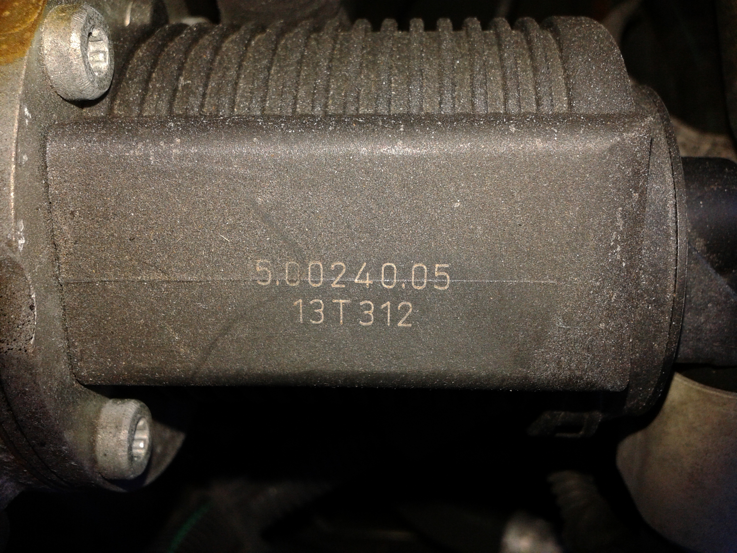

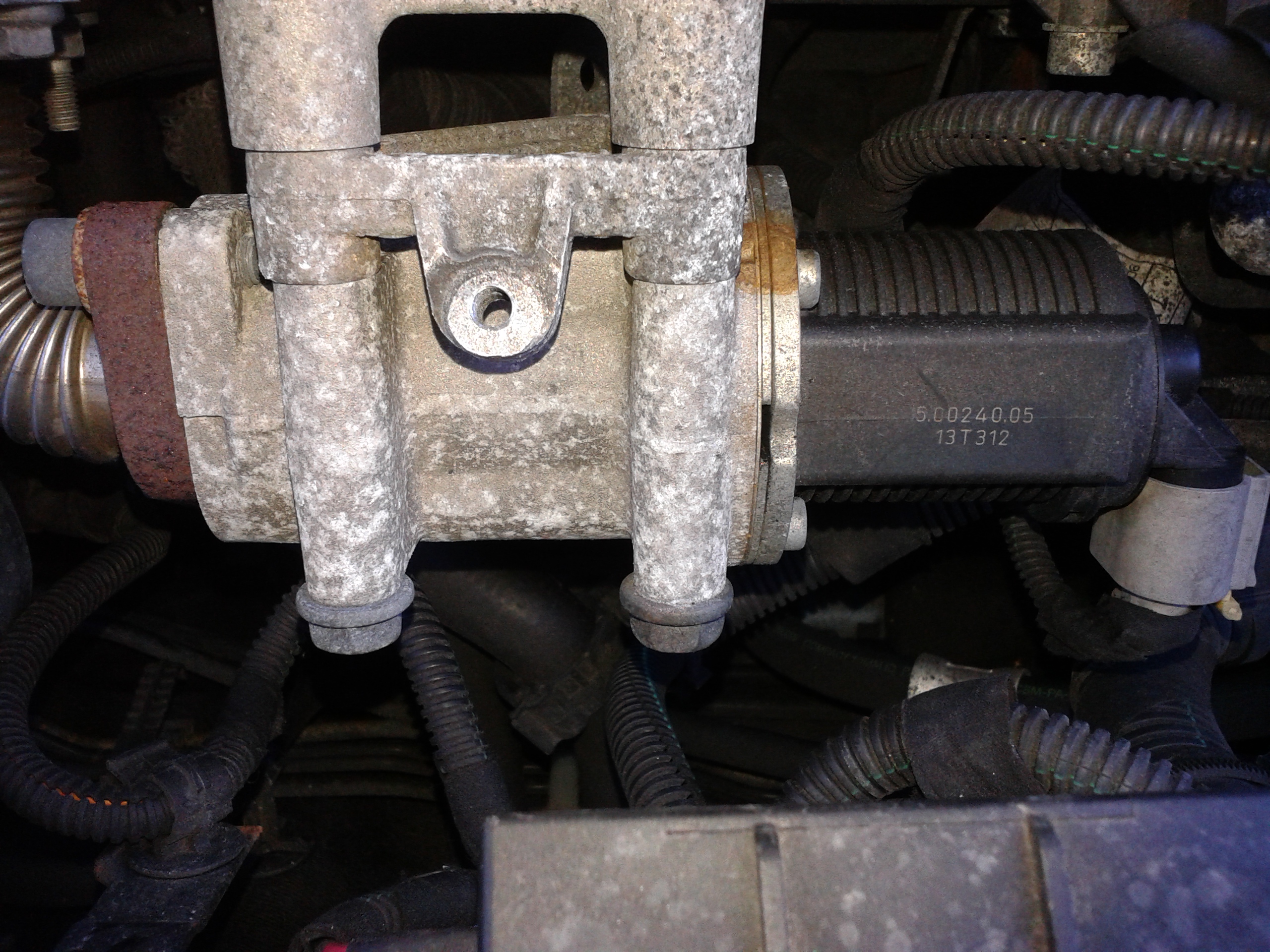

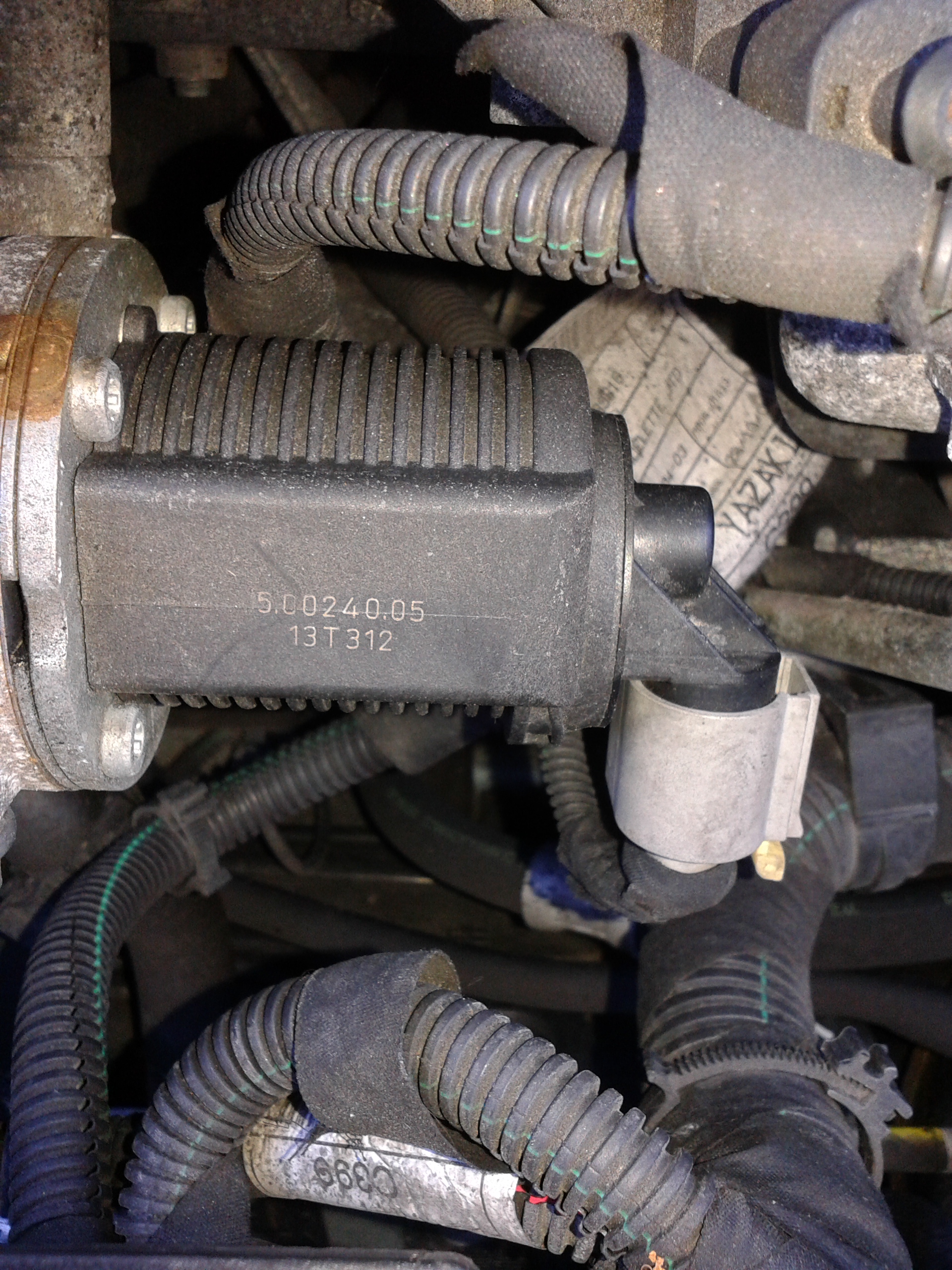

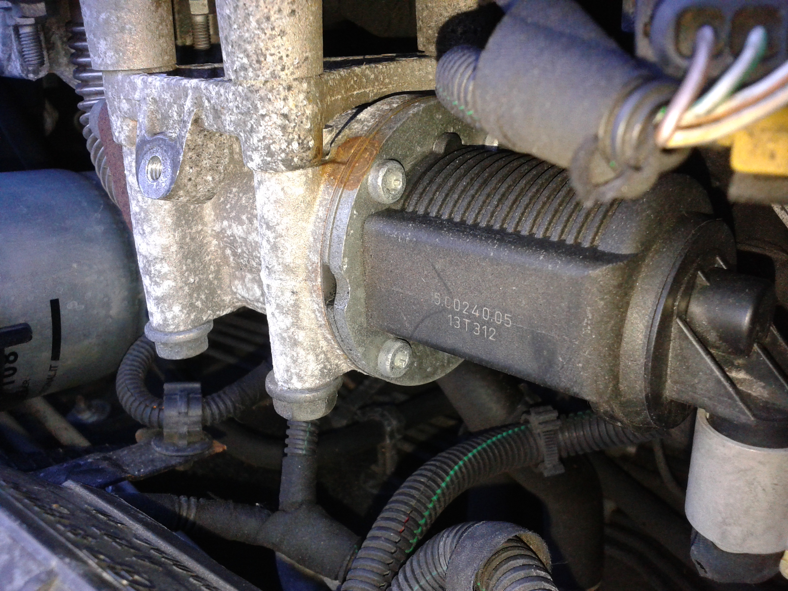

Post some pictures of your age valve, they are different options and you appeared unsure which engine you have.
Jack
Nissens 98185 should be correct for your doblo, you can try cross referencing that number to find oen or different brands/prices.

i attached pictures of my engine details and the EGR valve.

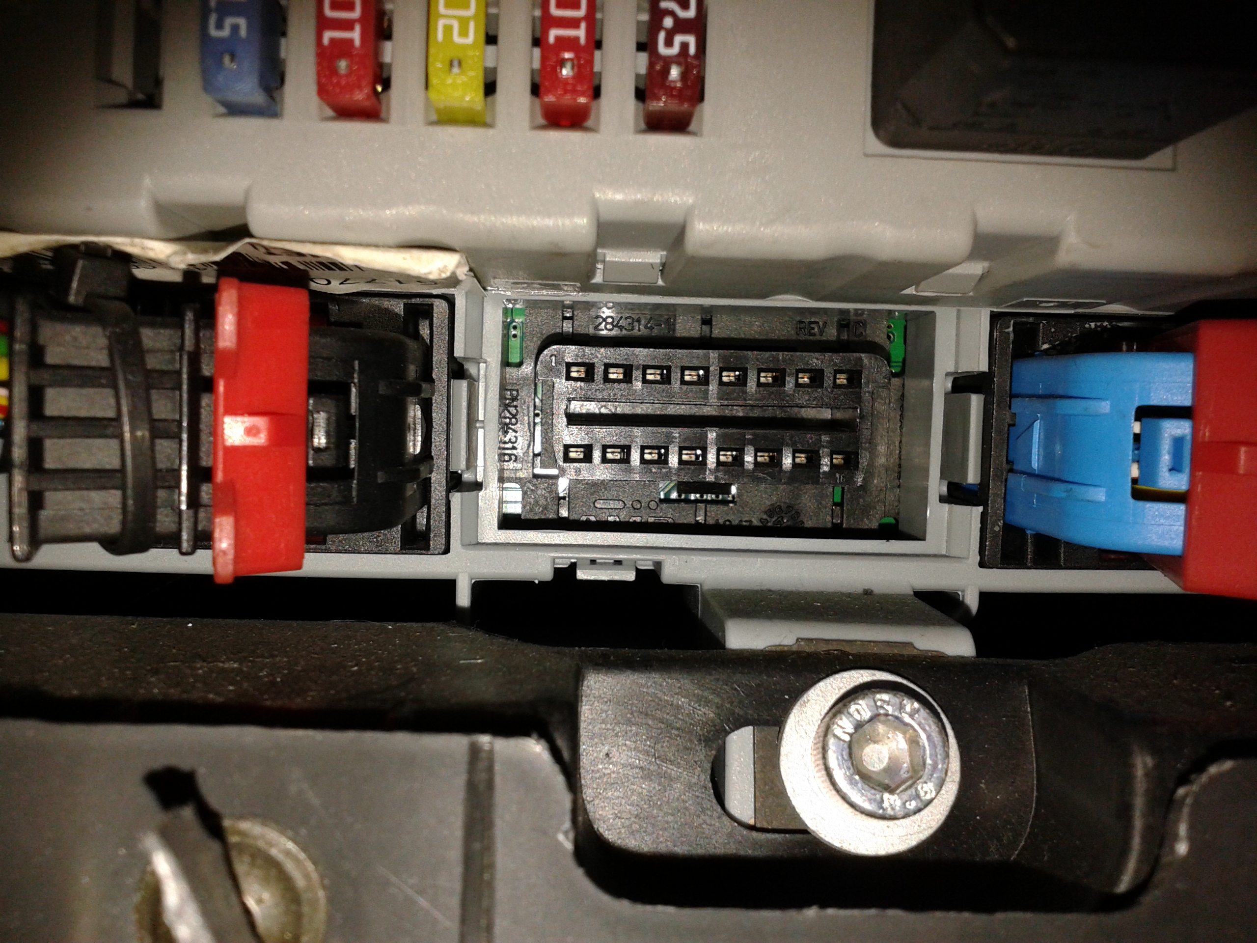

im waiting for the new EGR valve to come in the post but in the mean time i thought i would have a go at trying to reset the service indicator.
i have got a modified ELM327 module from ebay (pictures attached) and the yellow lead
but when i try to connect to the ecu it comes up with ELM327 ECU error message.
i may even have the lead connected the wrong way as the socket in the car is a different shape to the plug.
i get a red light on the ELM thing when i connect it up to the car and a laptop with the ignition on and when it trys to connect all the lights flash in seqence on it.
i would be glad of any assistance.

In the OBD port..
The wider part of your plug goes over the UPPER part of the socket
If you are using MES
Do the 'find all devices' with ELM327 Only plugged in.. no adaptors
i replaced the EGR thing today and if any body wants advice on doing it on a 57 plate doblo multijet then the answer is DONT !
after 2 1/2 hours and hands and arms that look like they have gone 10 rounds with a sabre toothed tiger i suggest getting a tame fiat mechanic to do it.
next time i do it i am going to take the engine out !!!

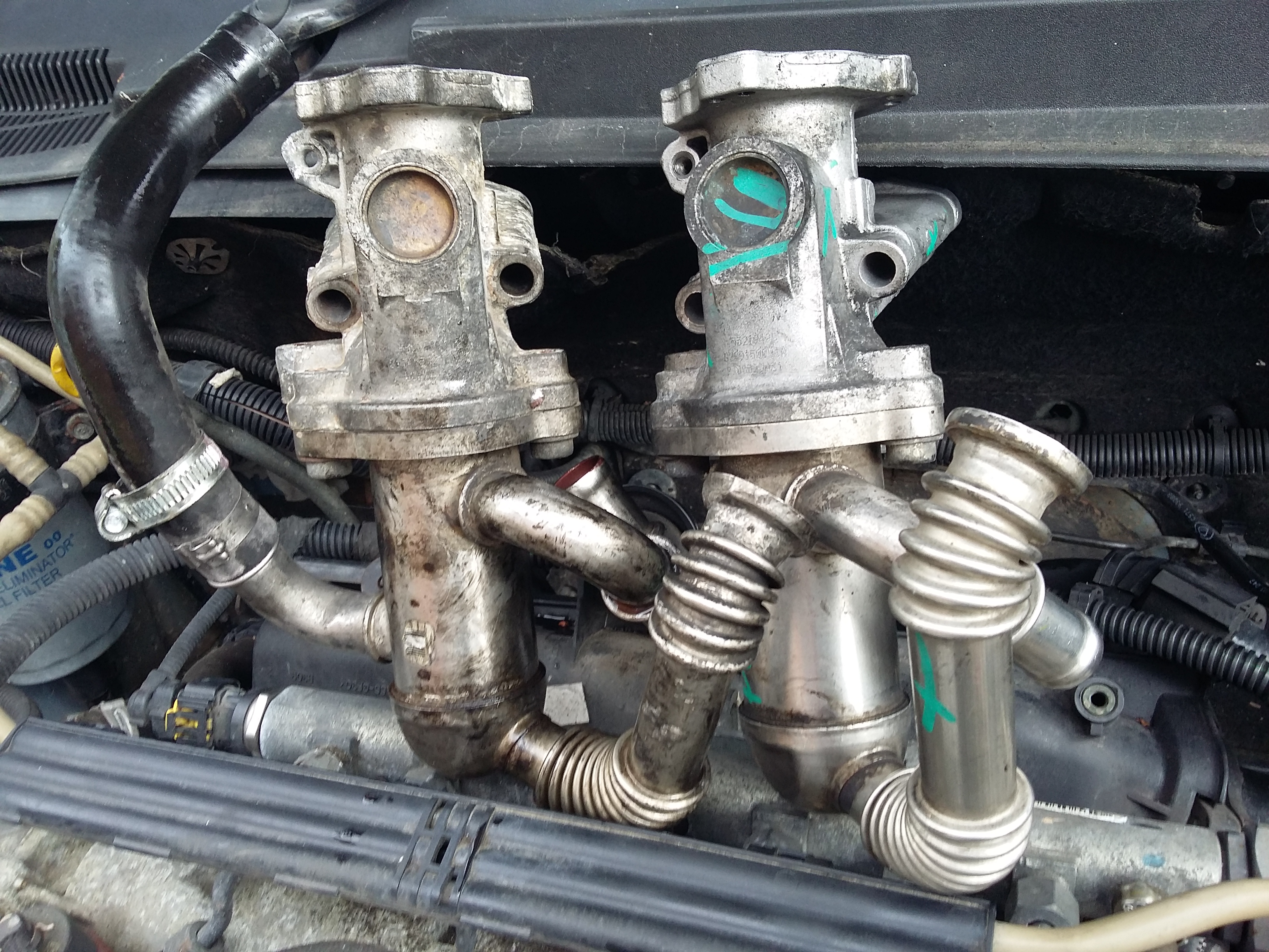

2.5 hours.. thats the whole assembly .. the flexible stainless tube and the cooler
List is @£650 for the new assembly..
mine still leaks gasses..after draining coolant and fitting another :(
Thankfully the electrical part is 3 screws and takes 5 minutes
i had to disconnect the tube from the exhaust and undo the clamp as i couldnt get to the 2 screws under the egr valve.
took me ages to do the clamp back up at the bottom of the tube and there was a really thin gasket there aswell that i didnt know about till i saw it on top of the gearbox and wondered where it came from.
