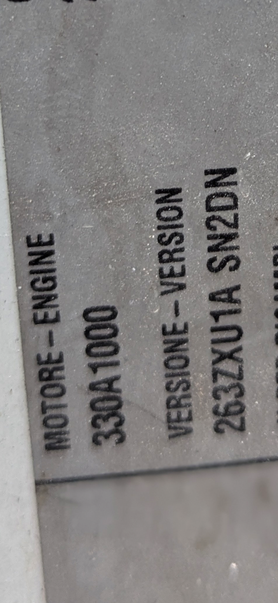

Bravo 1.6D easily reset by MES. Needs doing after each oil change. What is the model number? I will have a look at MES and confirm.
MES does have a specific oil cnage procedure for Doblo 263 vehicles with a dpf in the engine tab. To be done after every oil change and if the oil light is blinking. This is in addition to re setting the servie interval and service coupon number. It may well be thay both are needed and in a set order. It does not sepcifically say but the MES forum might reveal this, otherwise trial and error. It seems pre 2015 has a different procedure to post 2015.
