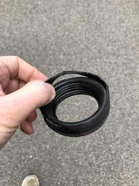

I picked up the 500 a couple of weeks back, and (after reading the thread on here), thought I'd try some iridium plugs. When I took the airbox off to access them, I noticed that the seal to the throttle body wasn't on properly. Closer inspection revealed this, it wasn't doing much sealing!:

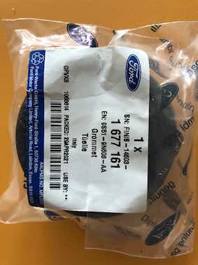

I had a read around on here, and couldn't find a part number. Searching online only got a couple of hits, that came to about £40 after postage. An uncharacteristic brainwave led me to see if there was anything for a Ford Ka...:
SN: FINIS-14603-1 677 161
EN: 9S51-9N-608-AA
It cost me £4.99 posted from official-ford-store on eBay; I've just fitted it now, and all is well.

I found some other threads on this, but couldn't see any with a part number. Apologies if I should've resurrected an old one; mods, please let me know if so.
EN: 9S51-9N-608-AA
