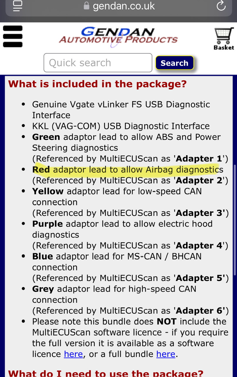

As has been mentioned here already, you need to find someone with access to the Fiat MultiECUScan (or MES) software... This is the only tool that can read the specific Fiat error codes (apart from a Fiat dealer's own system). These are links in this forum to local users across the country. You can buy the software and necessary connections from https://www.gendan.co.uk/category_161.html (just about for less than a Fiat dealer would charge to just read the codes!) and there's also a (very good) version of it that runs on the iPhone... which is what I use. Checking teh airbag circuits also requires the additional red coloured adaptor lead.
As has been mentioned here already, you need to find someone with access to the Fiat MulitECUScan (or MES) software... This is the only tool that can read the specific Fiat error codes (apart from a Fiat dealer's own system). These are links in this forum to local users across the country. You can buy the software and necessary connections from https://www.gendan.co.uk/category_161.html (just about for less than a Fiat dealer would charge to just read the codes!) and there's also a (very good) version of it that runs on the iPhone... which is what I use. Checking teh airbag circuits also requires the additional red coloured adaptor lead.

You will need an ELM327 OBD interface and a yellow adapter cable, something like this:
Then download MES and install on a laptop. The cable plugs into the OBD port of the car, under the cover to the right of the steering wheel.
