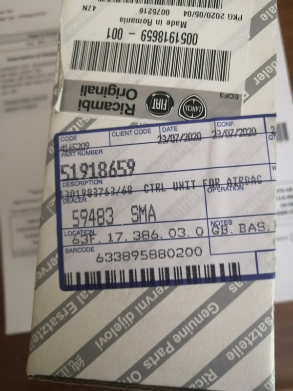

So my daughter came back to visit from Uni this week and I had the car booked into PDH cars for more investigation.
Still the same issue they could see Airbag module was there and the live values, but they could not proxi align it.
So they agreed to order a new airbag module to see if that would resolve the issue. If it did I would be given the choice of buying it or not, otherwise it would be returned to stock with no charge and they would keep investigating.

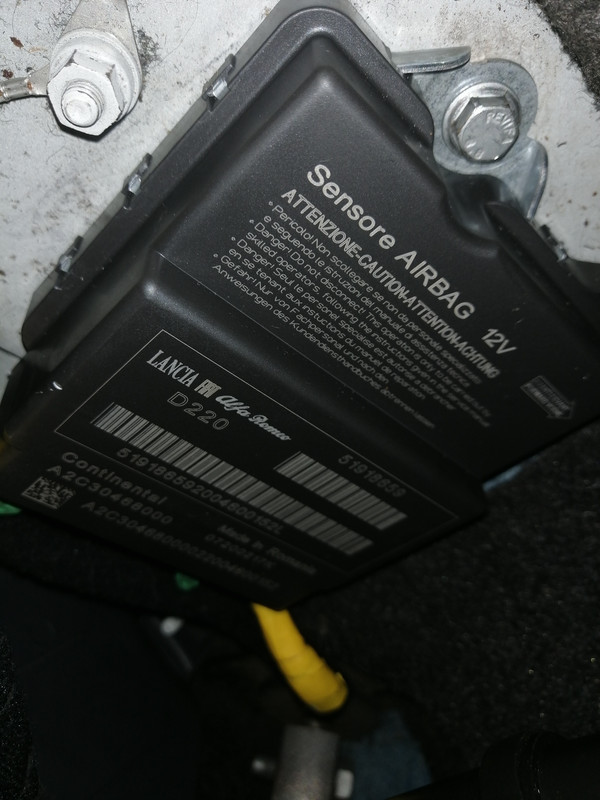

Well the new airbag module arrived yesterday it was fitted, proxi aligned and the problem was gone! WTF!
So maybe the second hand one I purchased with the same part number had the same faults as the original, but that seems like a huge conincidence.
Now here's the kicker ... the module they fitted (51918659) was not a metal cased module like the original (5186776).
So maybe the original has been superseded or is no longer available and this is a compatible replacement. Or maybe the whole problem is because the metal box module the car came with was the wrong one in the first place and this is why the second hand replacement did not work either.
Any how it's fixed the labour was just £95 but the part £479 ex vat. So a grand total of £689 to resolve.

My guess somebody changed to the wrong ECU after the original failed
That didn't fix it so sold the car on
Sounds plausible..
A part number that apparently ties in with the build:VIN then works
Weird how the 500s seem to need so much more attention that the panda.. but maybe a lot more get minor bumps.
I think that could well be the case. As I said early on the car came with a plastic bodied ECU, which he said "just need to fit that and it'll fix the problem". Upon inspection you could see the ECU had been opened (plastic tabs were broken).
As an aside in the Land Rover world (Defenders, Discos) that I am more familiar with we can get copies of parts manuals (PDF or Rave software) where it is quite easy to check what part numbers are compatible with vehicle by model year or VIN number. Does such a resource exist for the Fiat 500 ... either a PDF or online style microcat resource?
Aha !!
Just been on www.fiatdalys.lt put the VIN number in and the SRS module it suggests for this car is the same as the one the dealer fitted!!.
So it looks like both the one that was fitted to the car when purchased and the replacement supplied by the seller were wrong.
So that probably solves the mystery of why neither typecastboy nor the dealer could get the proxy alignment to work.
Mystery solved I think.
The mistake in the fault finding was assuming that the part fitted was correct but just defective.
