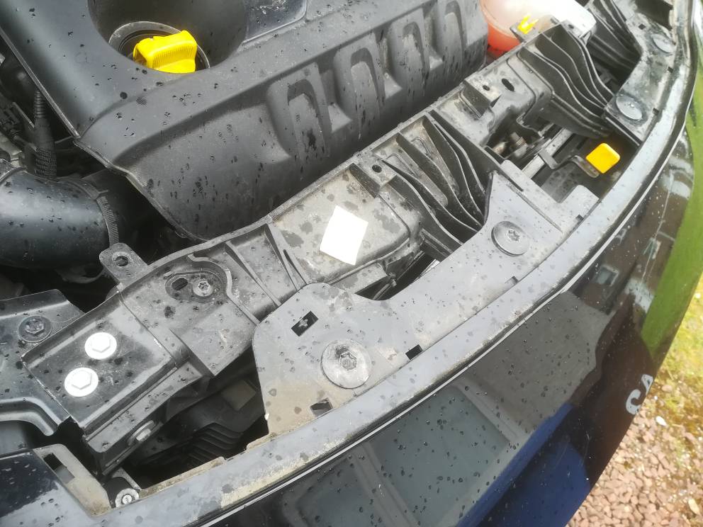

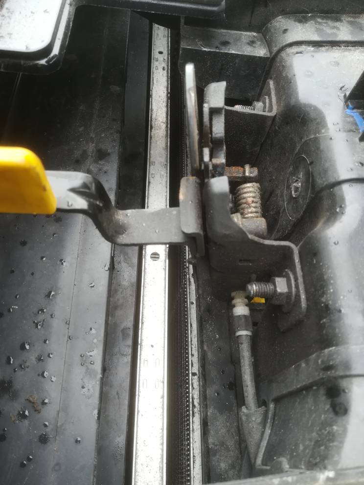

An update, if anyone is interested. Some people don't follow these thread stories through to conclusion. I decided not to go with Kwik Fit but instead contacted my local garage Galvin Garages (Glasgow) who put me in touch with a company called Direct Cooling (Lanarkshire) who come to your door to examine your vehicle (£40 for a diagnosis or £145 for a refill of 1234)... In short, it wouldn't hold pressure, the condenser is leaking. The engineer connected what seemed to be a compressed air cylinder via gauges into the a/c system pushing pressure to 120 psi and squirted what seemed to be a detergent around the system I guess to check for bubbles, but he and I could both hear a slight bubbling noise from behind the grill where the condenser sits and afterwards, I removed a studded plastic top panel from above the radiator/condenser and could see a multitude of these colourful soapy cellular bubbles sticking to the back of the condenser. Engineer said he would lay bets on it being condenser in most cases and it seems quite exposed there sitting behind that big grill. So, will not be cheap but might be easier than you think to remove bumper/grill assembly for access and condensers seem to start around £75 plus delivery. Back in touch with my garage when I'm ready then..
(The long silver line in the first photo is the top of the condenser) IMG_20200609_170516.jpegIMG_20200609_170500.jpeg
