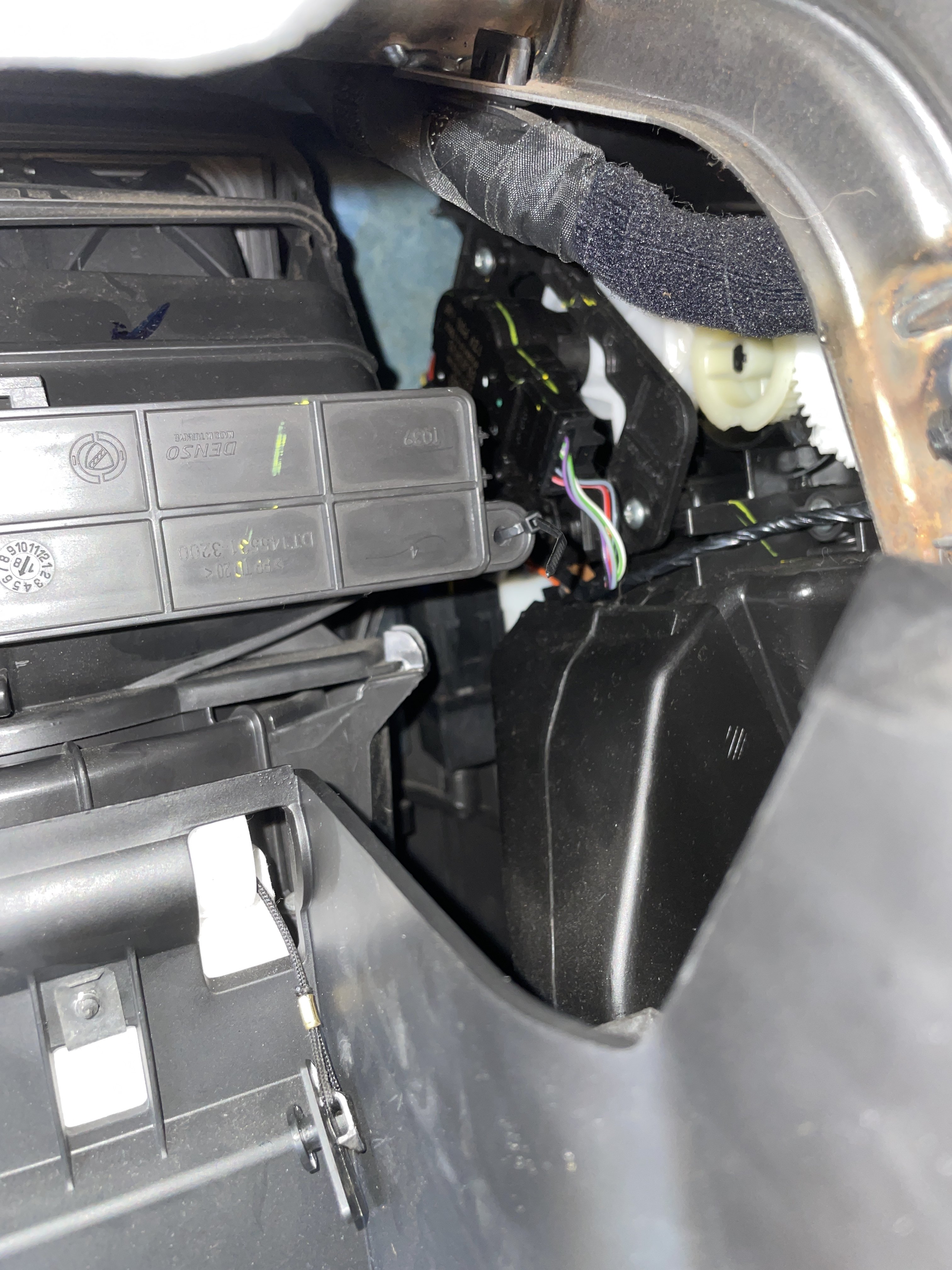

In my life I've driven a Cinquecento, Seicento, Panda, Stilo and now I have a Tipo. Unfortunately I have a problem with the automatic air conditioning.
I have a problem with the automatic air conditioning. The motor for the blower flaps is "stuck" in the direction of the window and only blows in this position.
On one of the groups someone said that I need to replace the „air conditioning actuator” It turned out that there are 2!!!
1. temperatures - hot/cold
2. changing the position of the air vents
The first one is on the driver's side (UK), easy access. I pulled it out and unfortunately it was from the temperature…
From the air flow direction it is hidden behind the glove box, I have no idea how to get it out! This is the problem :(
Do you have any diagram or hints on how to replace it?
