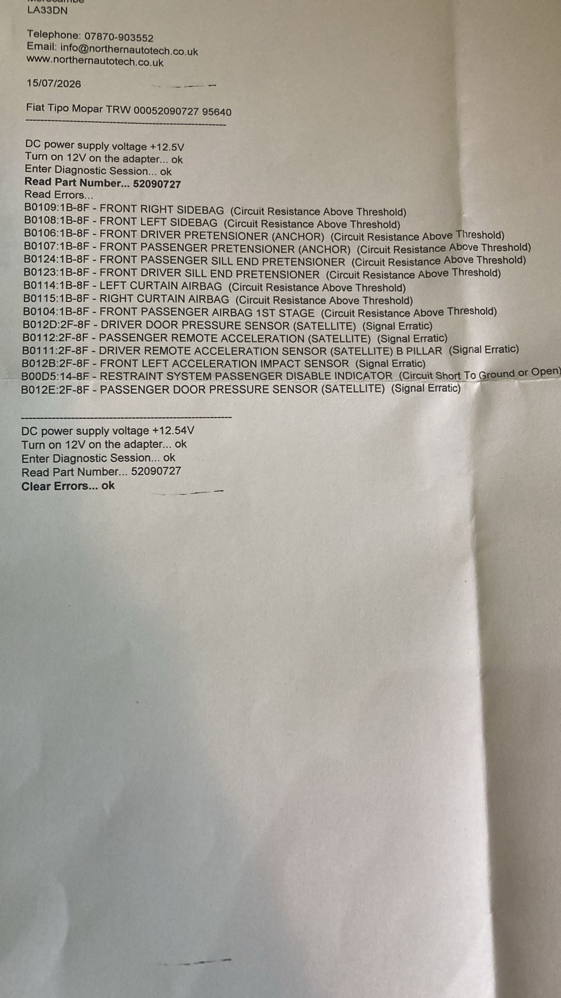

We have a 2019 Fiat Tipo Easy/Street.
We have recently repaired it from damage to the driver's side doors - airbags were NOT deployed.
It was showing the airbag light on the dash so we assumed that it still triggered the sensor for some reason.
We sent it off to have this reset; on return it said no crash data was found, but the errors had been reset.
The errors printout are in the photo below.
Unsurprisingly, when fitted back into the car, dashboard light came straight back on.
Any clues or ideas?

Hi,
Any clues or ideas?View attachment 470657
