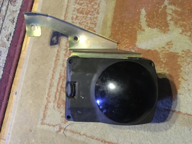

Perhaps you asked the wrong person, is there a way you could use the ePER part number for the radar node in the Thesis section to get the Bosch part number? Then cross reference that with the guys at the BMW parts department? Or as you said before, talk to a few of the guys on their forum.

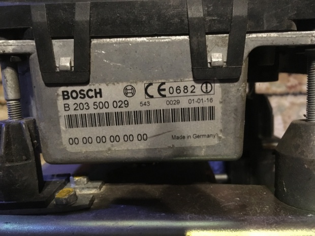

Has anyone found the number of this radar?
I bought everything but I do not know if the radar has the right number

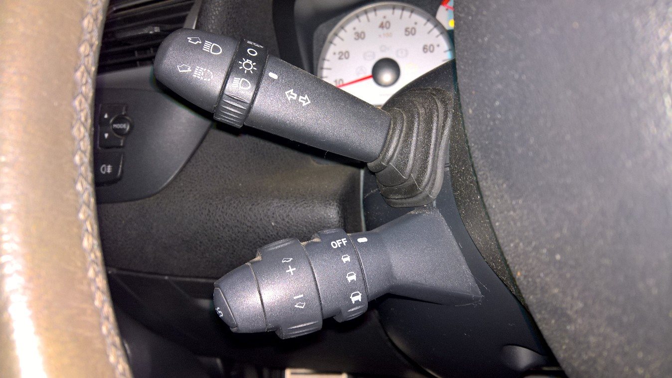

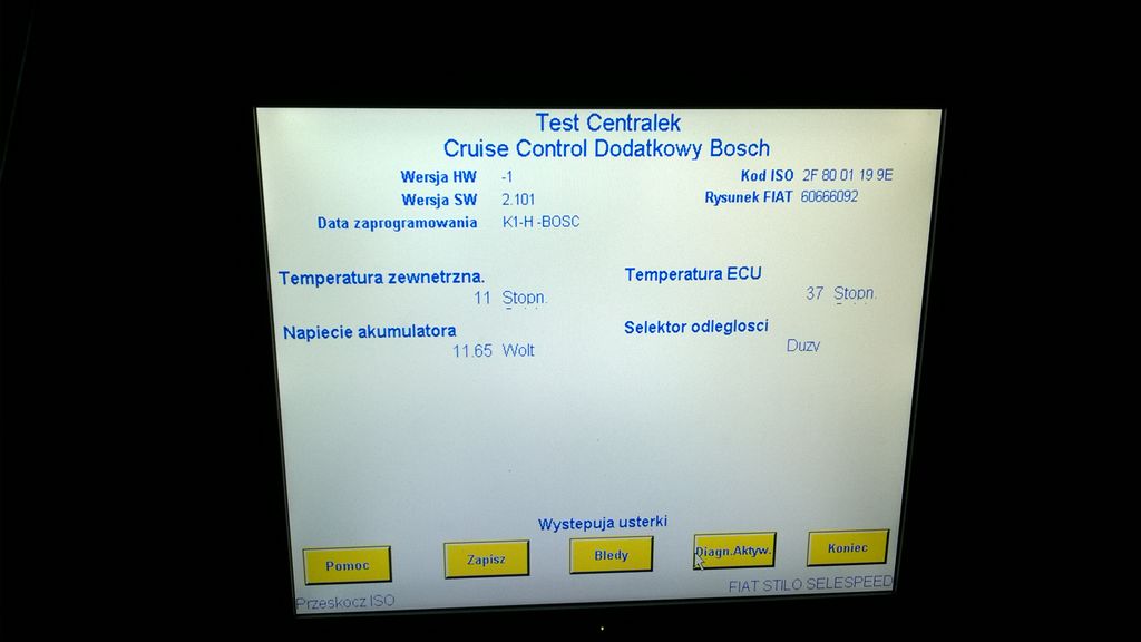

I still have problem with configuration.

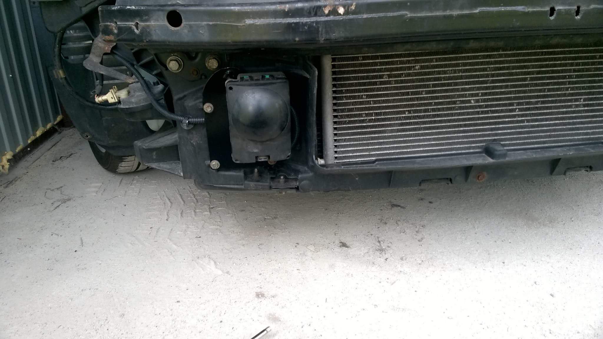

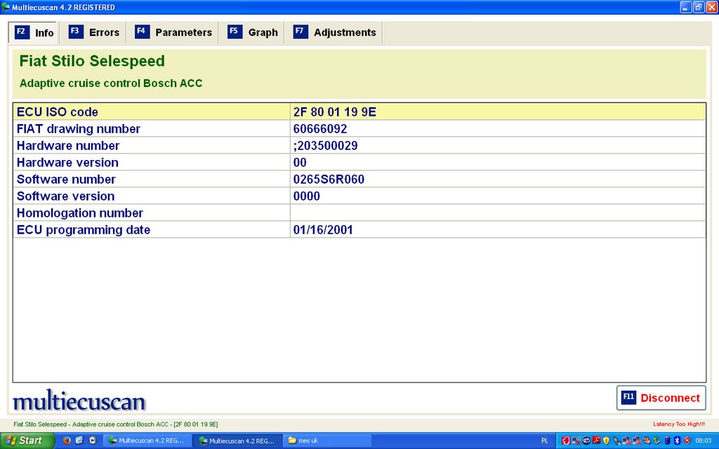

radar from lancia thesis ,but preserion. bosch 0 203 500 029 lancia/fiat 60666029

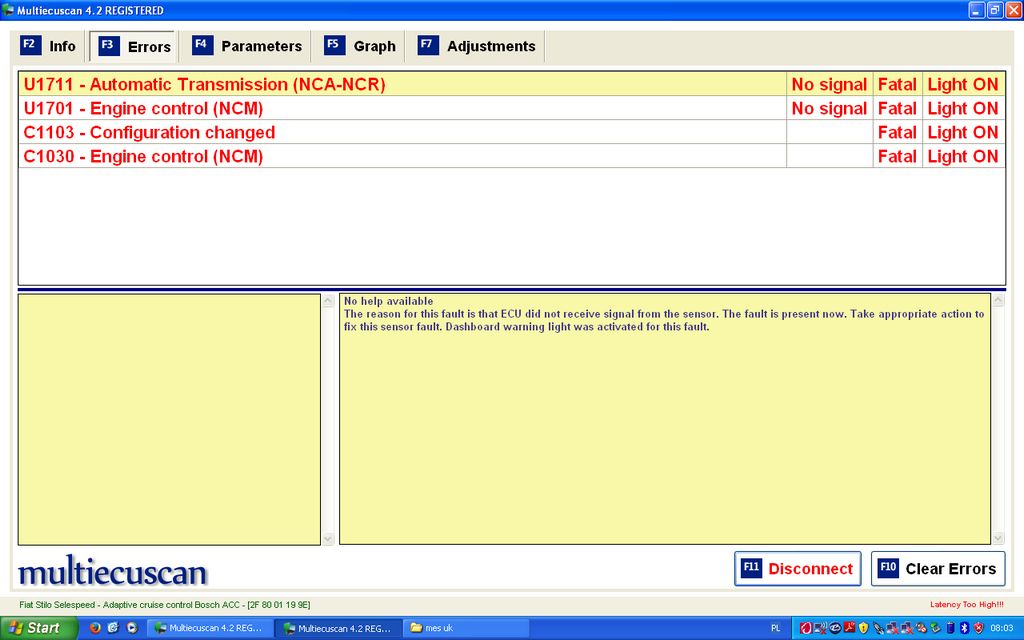

radar works but i have problem between acc and ecu and gearbox.
looks like radar don`t want talk with ecu and gearbox (wrong map or iso code)
Proxi pass without errors

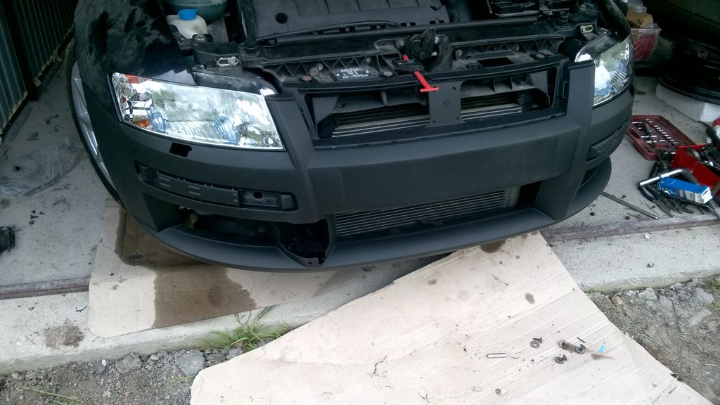

and i still looking for a 3th brake lights, i have erron in abs

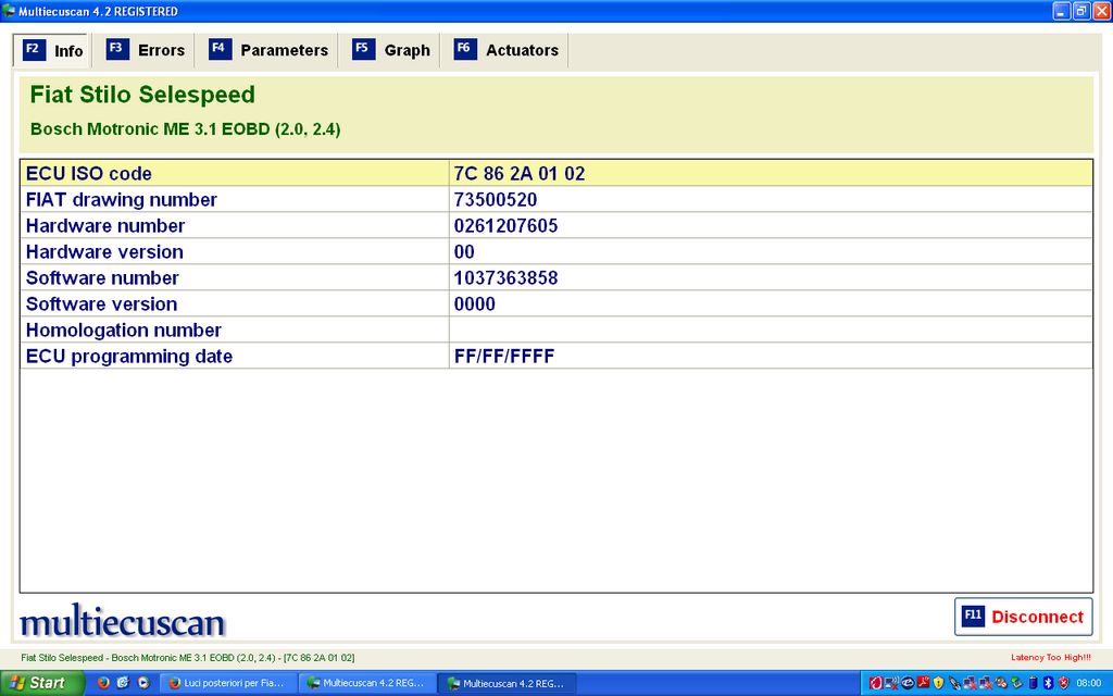

I think I need to find a radar from the normal production of bosch 0203030004 fiat / lancia 60688209 because it is interchangeable with that of stilo. or alternatively option install sw from 0203030004 on my radar
the problem is to find a sw, I even bought an examiner but no sw for acc
somebody can help?

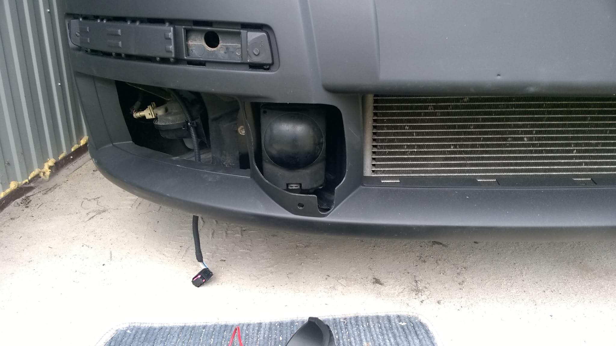

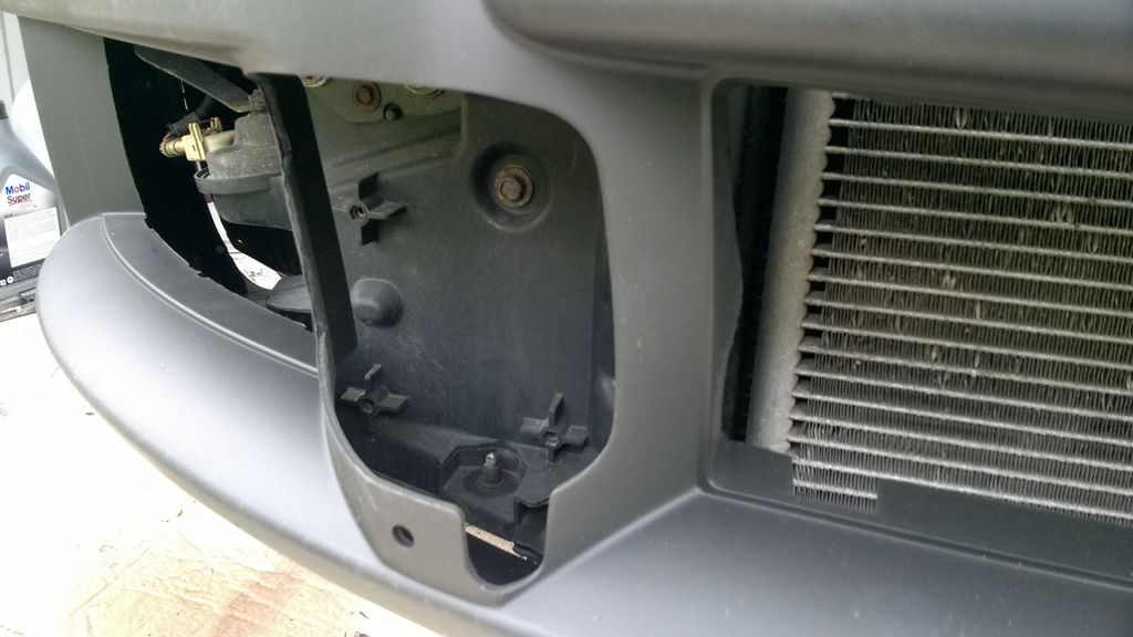

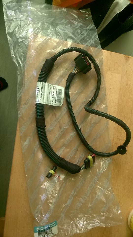

Was al the wiring in the car already? Or plug the harnas in the main harnas?
And where did you find the Parts?
All wiring was already there. Without cable from the picture.
The can work.
When I disconnect acc, ecu reports no communication with acc.
Parts come from Poland and Italy
