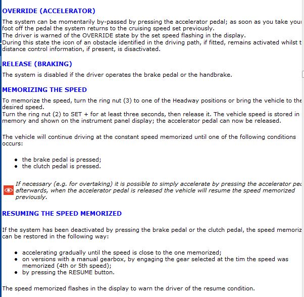

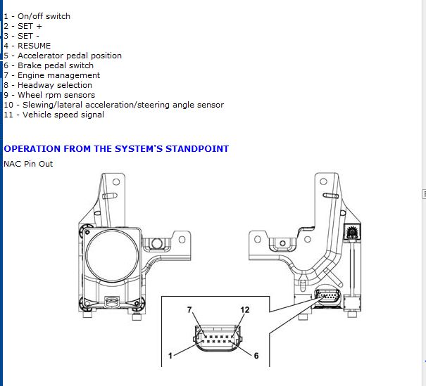

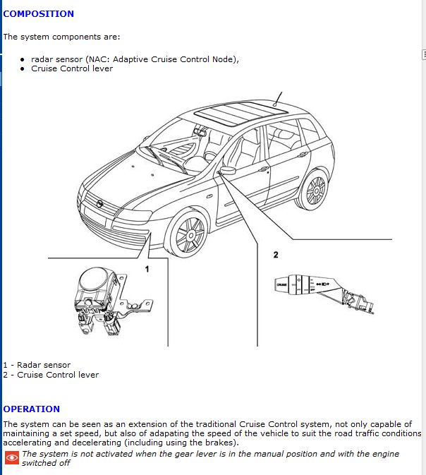

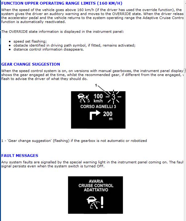

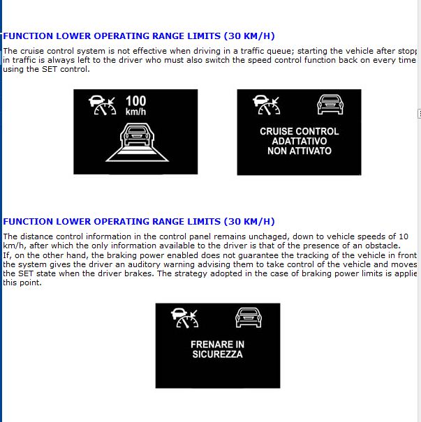

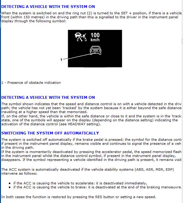

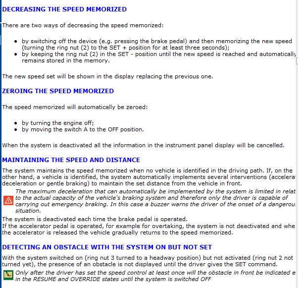

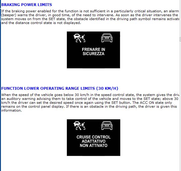

This is the only information I can find in eLEARN about ACC.
The eLEARN window is not expandable, so a few characters are missing from the right of the screen captures I made.

As usual Devran you have surpassed yourself... i wish i knew how to use eLEARN properly ;)
"The art of knowledge is not knowing everything............. it's knowing where to look" ;)
EDIT: To find it in eLEARN, go to: Descriptions / 55 Electrical Equipment / 5580 Special Accessories / Introduction - Special Accessories. There's a section on normal Cruise Control first, scroll down to SPECIFICATIONS for the start of the ACC section.
ah yes, very good... well the screen prints have certainly thrown up a couple of issues that i personally didnt account for, things like all the ECUs the damn thing will be trying to talk to. i just wonder if there will be any issues with it not recieveing the expected responses from things like the instrument panel, if being used with anything less than the 2.4. im off to check MES for other ECUs to ensure that it is only the instrument panel that will cause issues!
