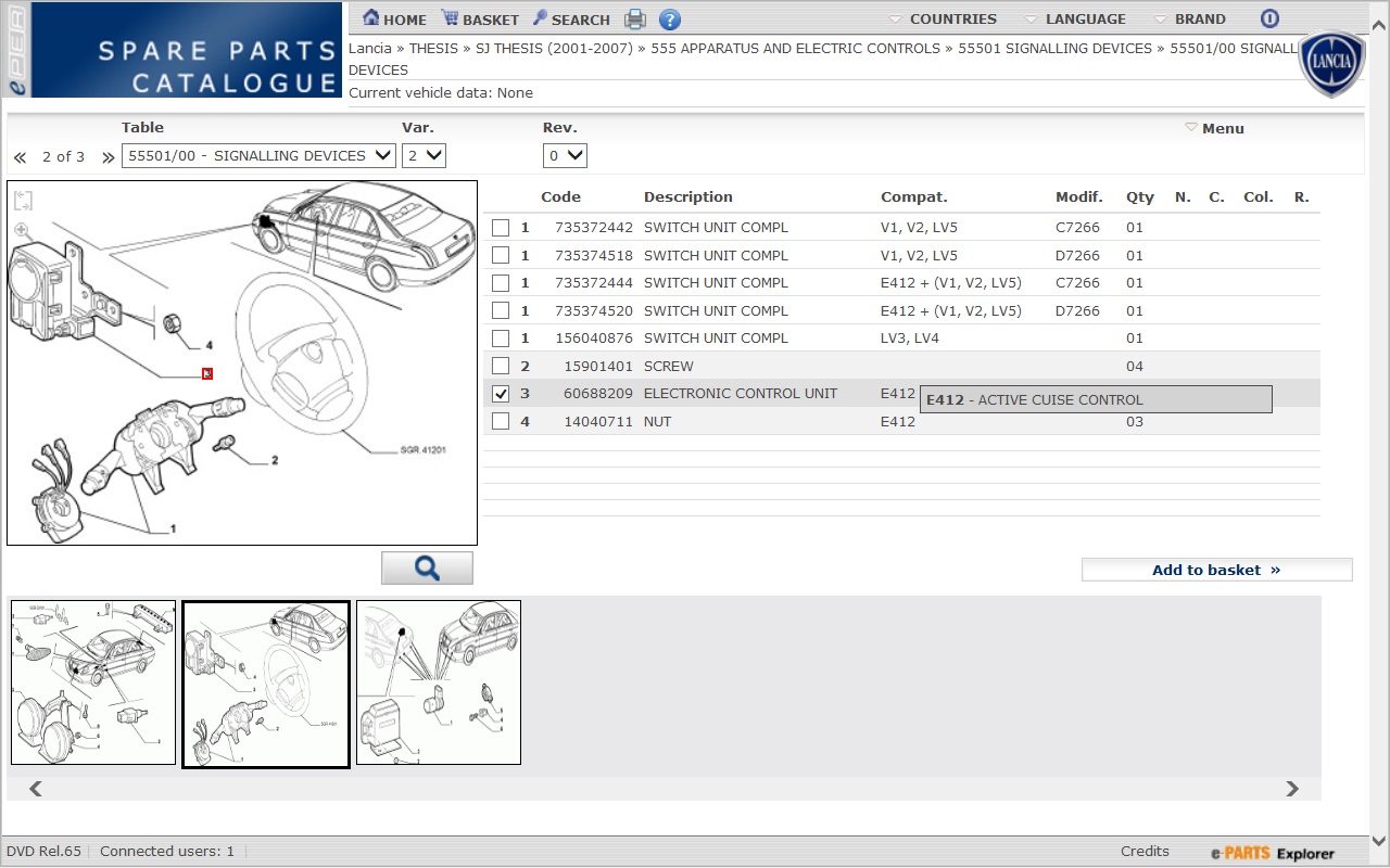

after spending hours and hours on ePER all i can find, in standard trim is 60688209 which is a Lancia number for the Thesis. search it on ebay, Nothing, search it on google, nada... might be time to send Fiat an email! ive sent a message to a seller on ebay regarding a 2002 options list which may or maynot list ACC as an option on the Stilo.
Thesis Screenshot... this part is a shade under £3000... YES 3 GRAND!!!
nothing is listed in ePER for any version of Stilos or Alfas in relation to this ACC Radar unit. E412 is the designation for ACC where as the stilo only ever lists an E416 (CC designation) for any of their equipment.
