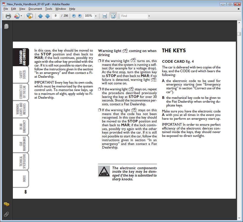

You can do Jon, just raided the handbook and it says
❒ If the warning light Yturns on, this
means that the system is running a selftest
(for example for a voltage drop).
At the first stop, turn the ignition key
to STOP and then back to MAR: if no
failure is detected, warning light Y
will not come on.

Hey T14 are we talking U1602 code here..? cos when I had the padlock/key light come up on mine it logged that code on the ecu..I then deleted it with my gendan scaner all £39 of it..:p it was a P code which I think means pending..? anyway it came up again about a month later and this time the P wasnt there but I deleted that again and it hasnt been back since..:slayer:best £39 I have spent cos its saved me two trips to my dealer to get it deleted..:devil: ;) :D
more than likely to be U1602 there Phil but not one I was thinking off. I get padlock key on my punto often, just switch off & restart...never fails or failed in 8 years. (I reckon its cause of large bunch of keys I have on keyring)
