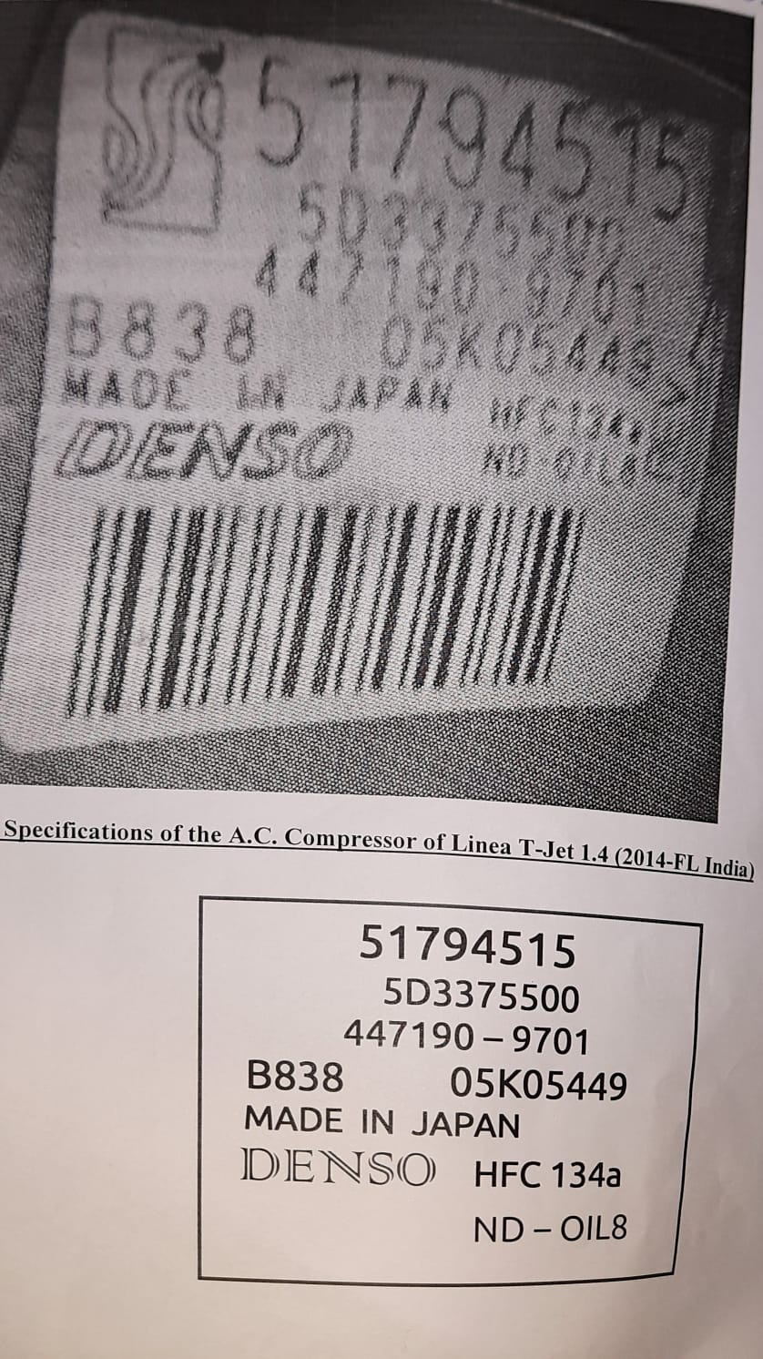

Ultimately I had to replace the compressor of my Linea Tjet by a new one original OEM part. I herewith attach the photo for your information. Upon measuring the resistance of ECV of the New and Old Compressors, it is found that its value of 18.2 Ohms in NEW compressor while that of OLD compressor is just 1.8 to 2.0 Ohms. This implies that the ECV was the main culprit which forced me to replace with whole new compressor.
Anyway, it is done. I need guidance and help for the following:
1. Can any one tell me that from where may I get the NEW ECV of this compressor?
2. Please see the picture attached herewith and kindly tell me what is the place/point location which is with a circlip lock and what is the use of it. Can it be opened? What is the use or function of that point or location in the compressor.
Awaiting your reply.
Regards to all.
Navin Talati / 17-06-2022
Regards to all.
