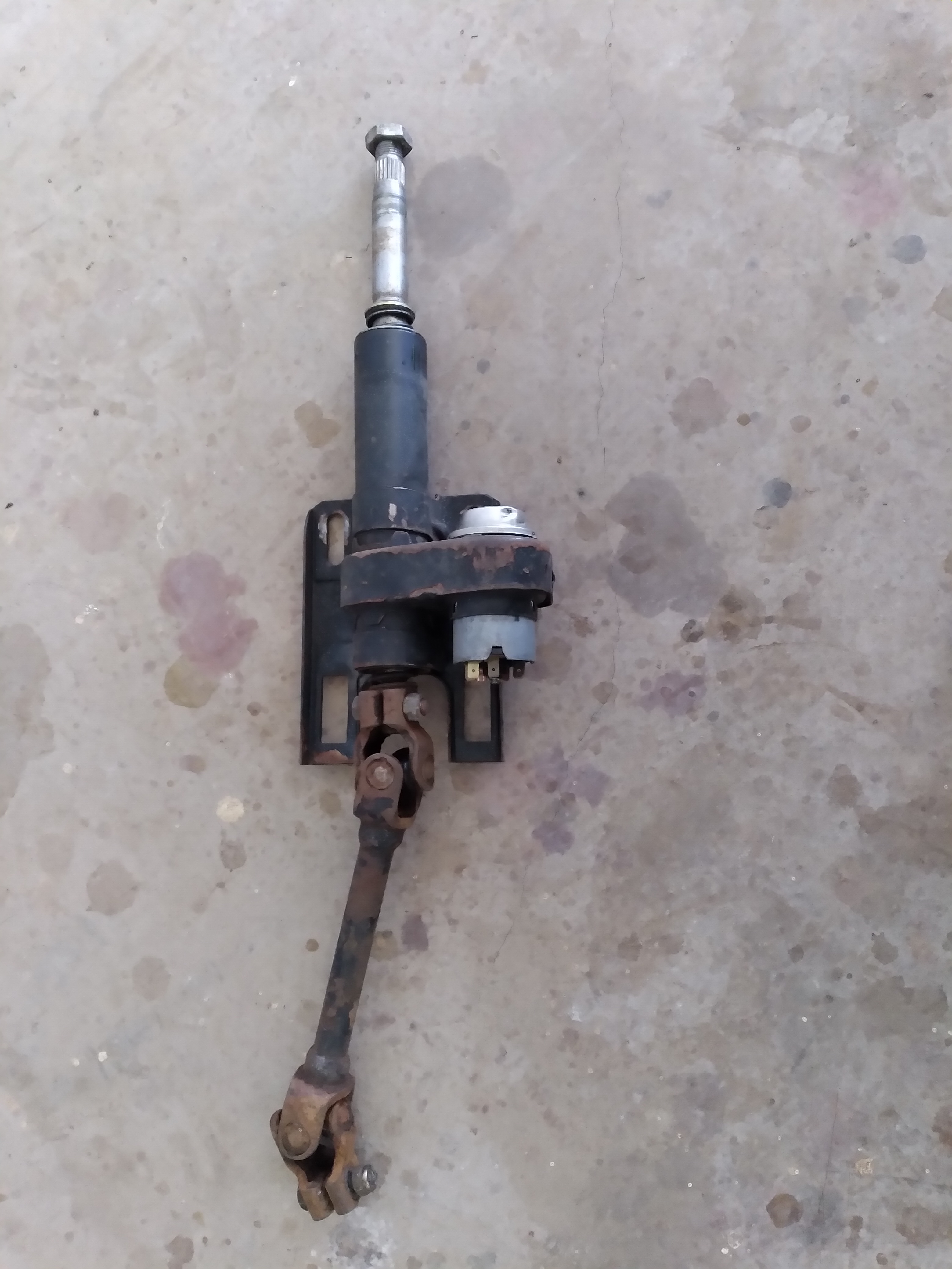

We have no keys, so I have removed the steering column with ignition switch, will take it to a good locksmith to make new keys. I've learned that a key code is stamped under the cover on the ignition. Hopefully it is readable; will find out this afternoon.

Iirc, there's a circular wire clip on the end of the ignition switch, that if removed, separates the electrical switch part from the lock part of the ignition switch. On the end of the (now exposed) lock barrel there may be a little metal disc stamped with the key number.
As regards finding key numbers for the doors/trunk (I think they're usually the same key) if you look carefully on the end of the lock barrel on either a door lock or trunk lock, you may see a number stamped there (iirc it's 4 digits). You might have to remove a door lock outer handle to see the end of the lock barrel. Or if you can open the trunk, just remove the lock/catch (2 x 10mm nuts) to check the end of the lock barrel for a key number.
Hth,
Al.

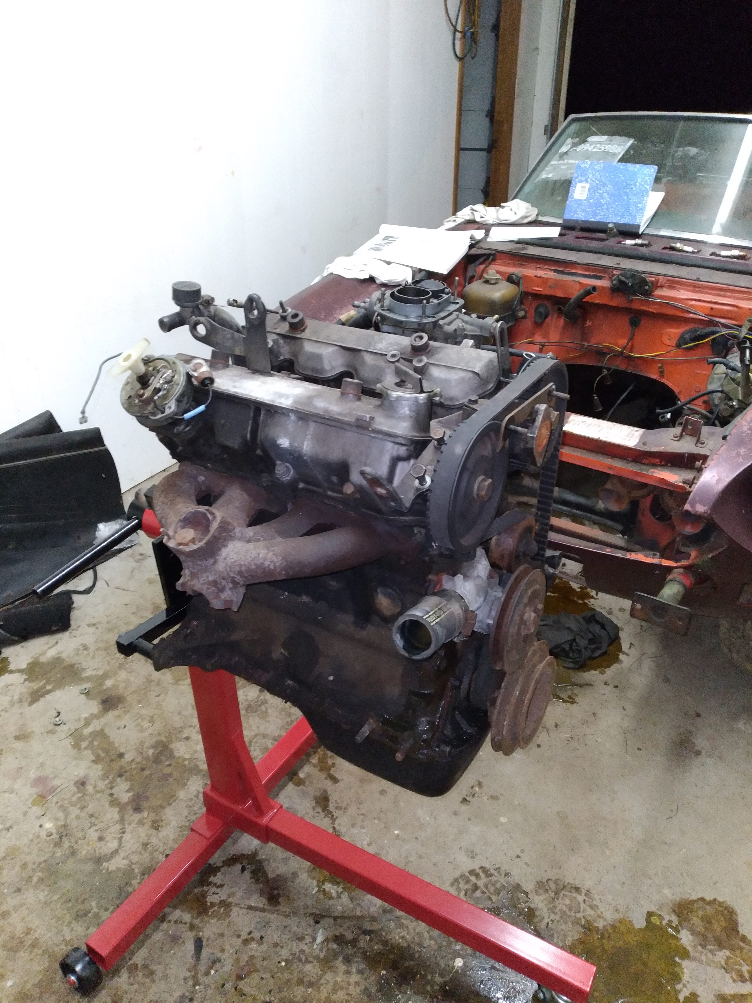

Well, we finally mounted the engine to an engine stand.
