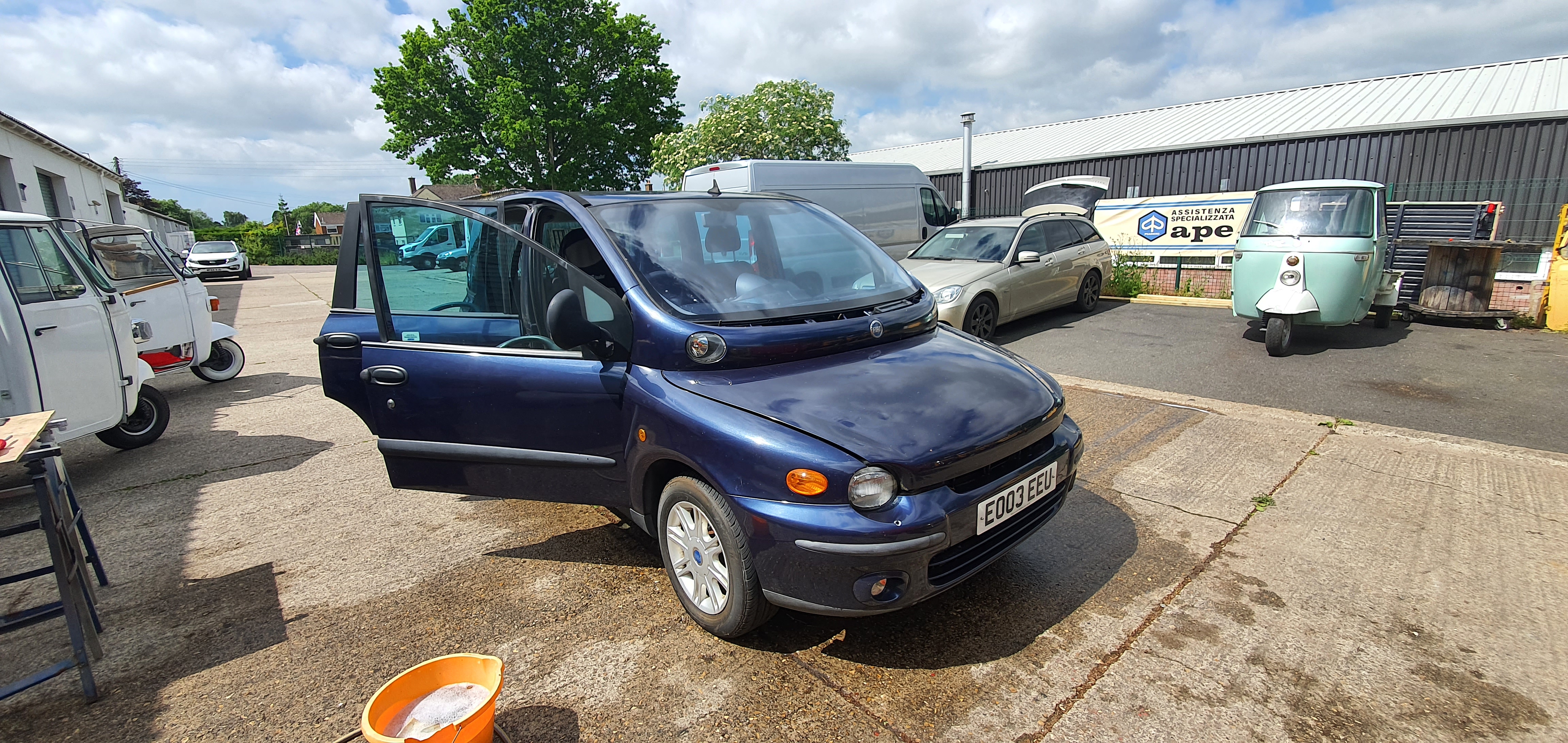

Morning, i read somewhere about a straight swap to a 6 speed gearbox from an Alfa to my 1.9jtd? Is it possible?
