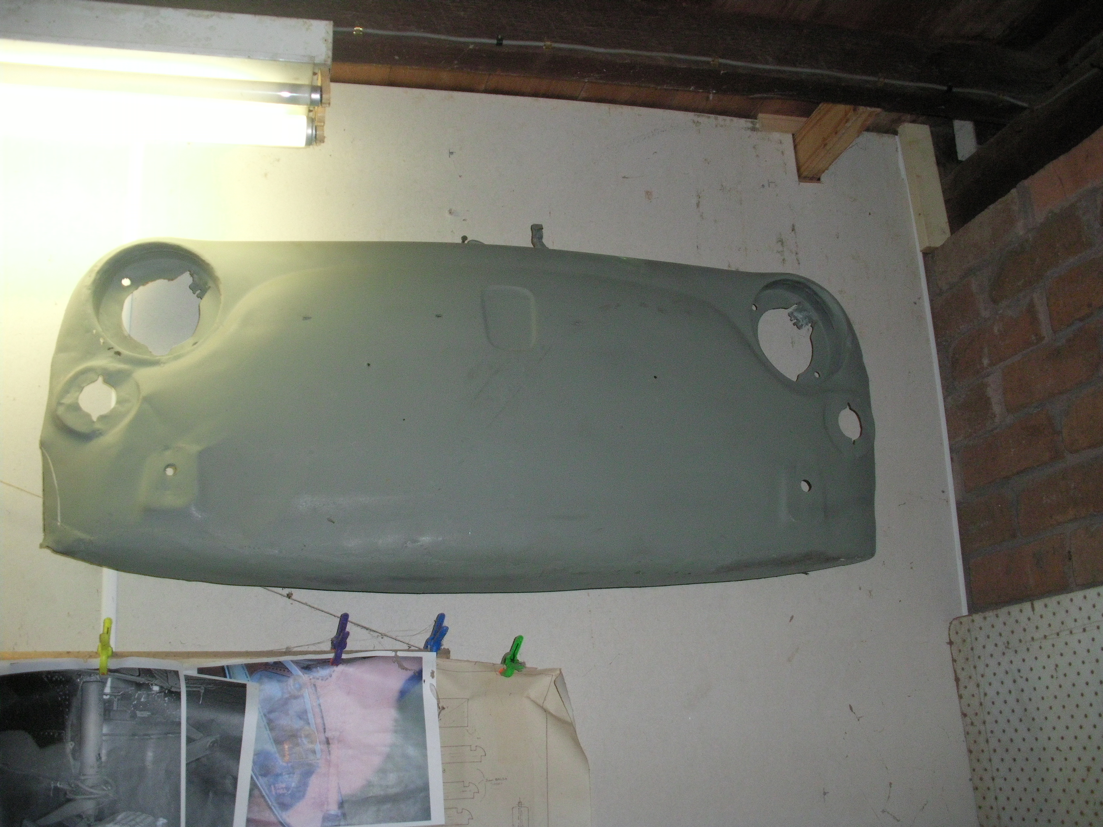

As an aside, I have this front panel and an engine lid from a 500F. When you are finished can you make all the bits inbetween for me? I can help with a photo of what it should look like if that helps. :)
