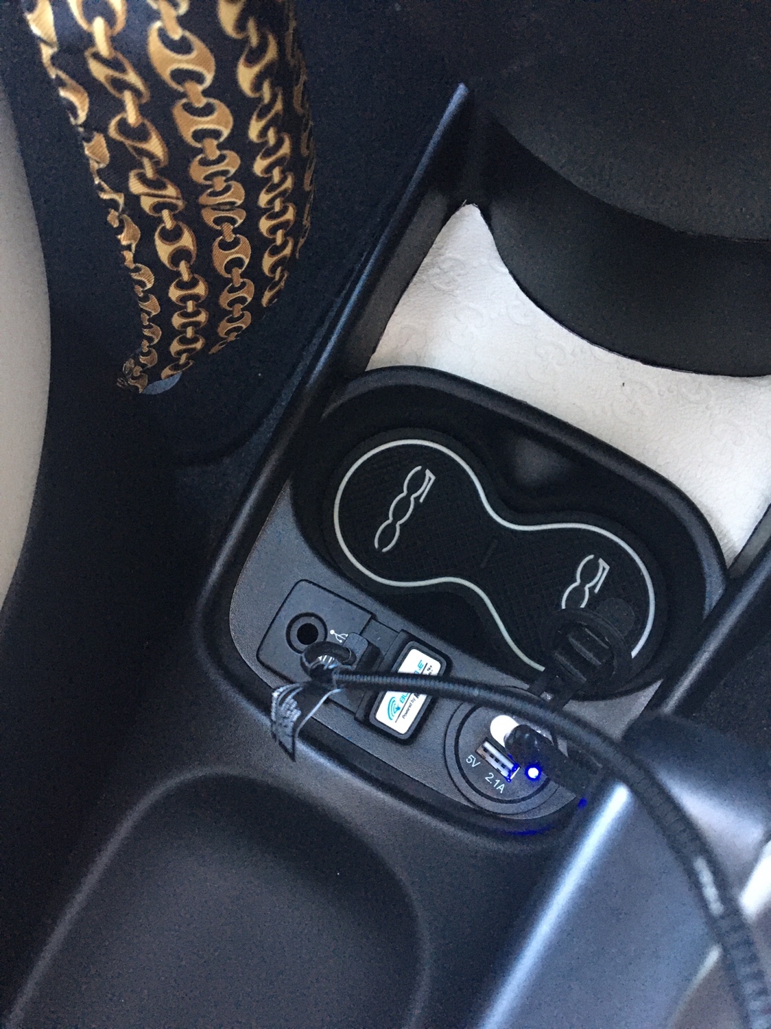

It’s just a patch lead John enables me to use the usb in the centre console it only works as a charger now I have to install a “factory “ looking USB port elsewhere for the car play ...
Ok so I’ve now decided to scrap the factory usb for power only I’m now putting in my own USB port using the existing factory port poxy & a female usb lead so I can use it for car play
IMG_4113.JPGIMG_4114.JPGIMG_4116.JPGall done!! I now have apple CarPlay my factory USB port is now linked to my stereo the mic is hidden in the original housing
Steering wheel controls work with new head unit
And my reverse camera works as soon as I hit reverse
It’s taken two days a few detours but I’m really happy with myself ?? and the whole installation looks “factory “
