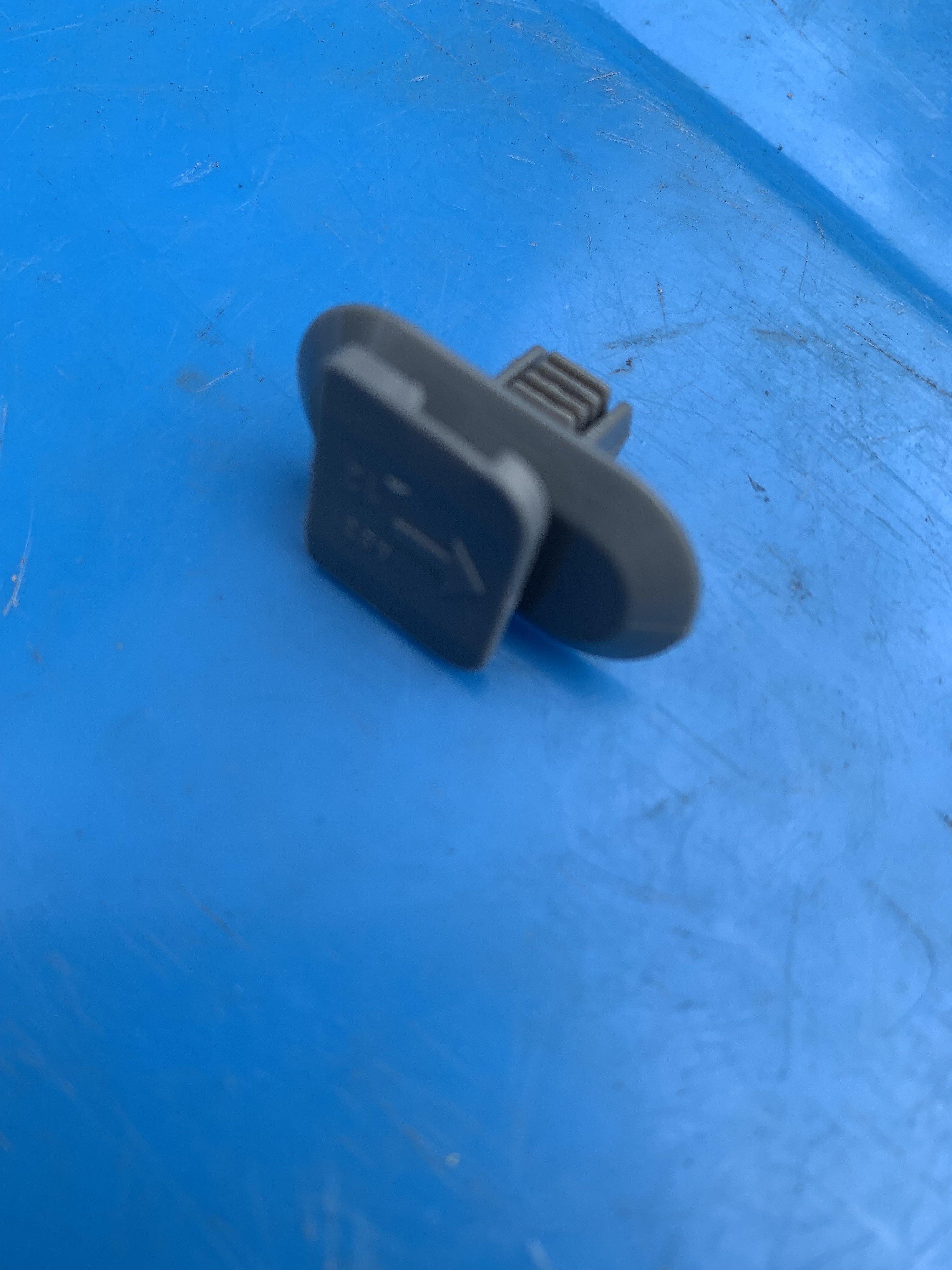

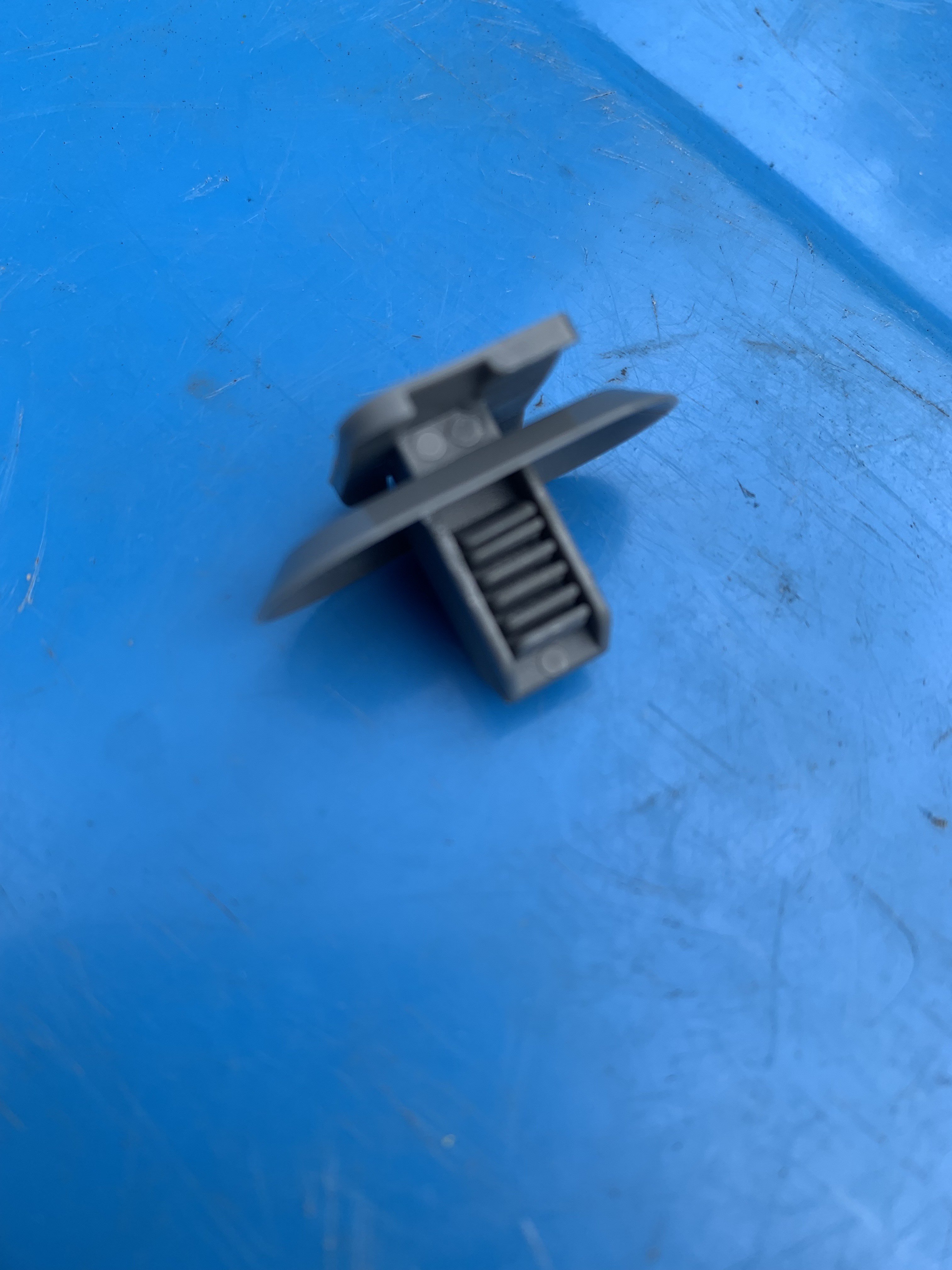

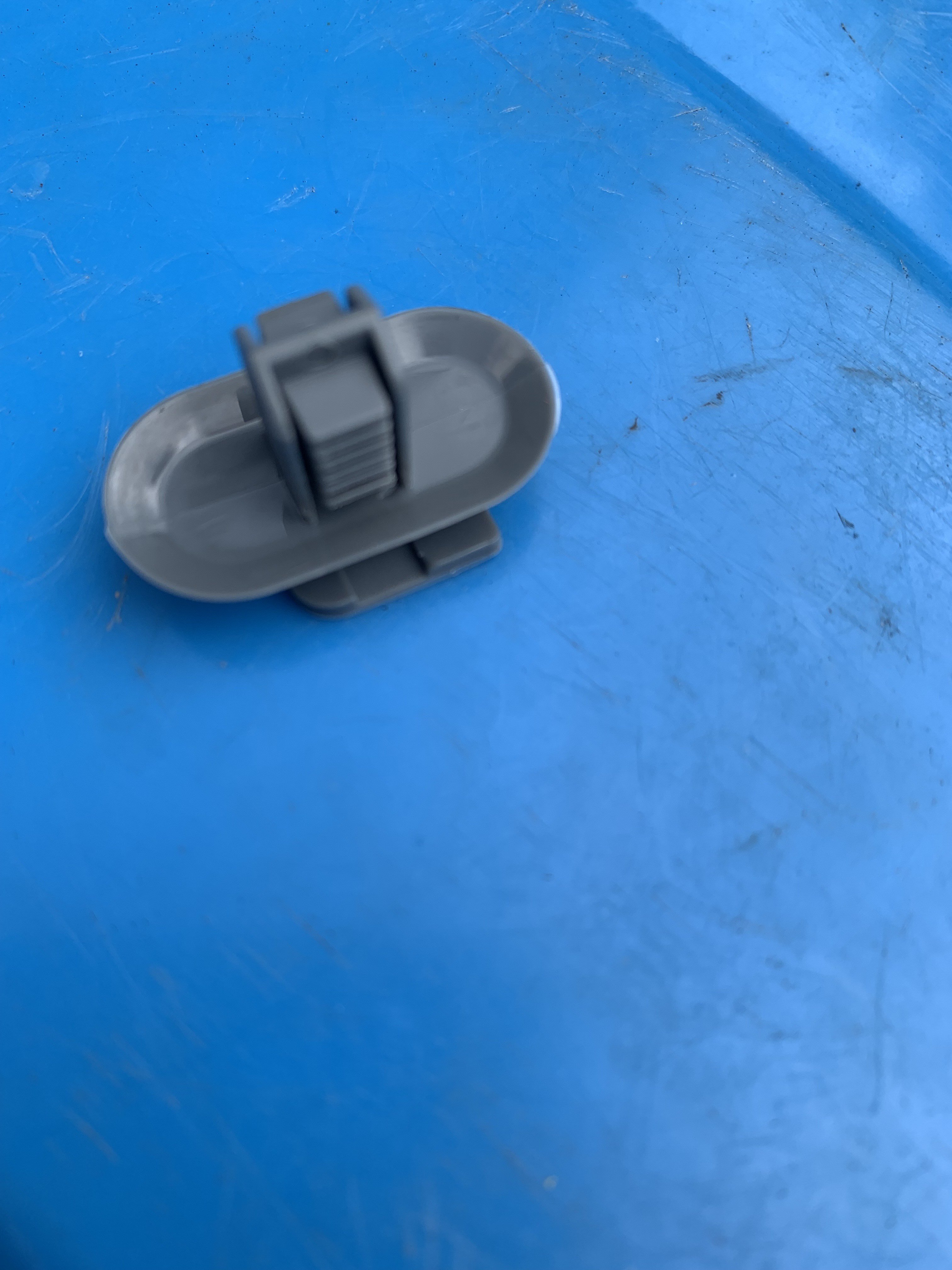

The only issue is I appear to have lost one of the clips that hold the panel between the quarter-light and back door onto the bodywork, I've attached some photos of one of the others to show what it looks like.
I've had a look on line but can't find any and I'm hoping someone in the know on this forum can point me in the right direction please

Glad it went well. By the way. I found WD40 on some kitchen paper was good at keeping the white aerial, it's base, and the rubber between the body and the base clean. It had a habit of getting dirt ingrained making it look filthy.
Sorry, cannot help with the clips, other than suggesting a nearby scrap yard
